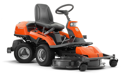

Was at the husky dealer and noticed a new mower in the showroom. Its a Husky R322T articulated. HUSQVARNA R 322T AWD - Riders Looks pretty interesting. Has the ability to add various attachments to the front like a sweaper, snowblower and a FLAIL!!!! mower.
AWD looks sweet. Seen a few videos online and they look quite stable on hills and pretty much unstopable.
Not sure on the deck. Metal looks pretty thin (well thin compared to my BX). .
Also not sure on the Briggs 22Hp Endurance engine. I know briggs has improved, BUT... And i think Ive been spoiled by my Diesel on the BX and the Kawi L/C I had on my X540.
Price was $5900 including the 3 bladed 48" side discharge. I think a rear discharge is available which might be better for mowing around obstacles.
Ironically, in Europe they offer a "Pro" series that has stronger components and Kawasaki power, with Diesel as an option... To bad they arent offered here, Id be interested.HUSQVARNA P 524 - Front mowers
