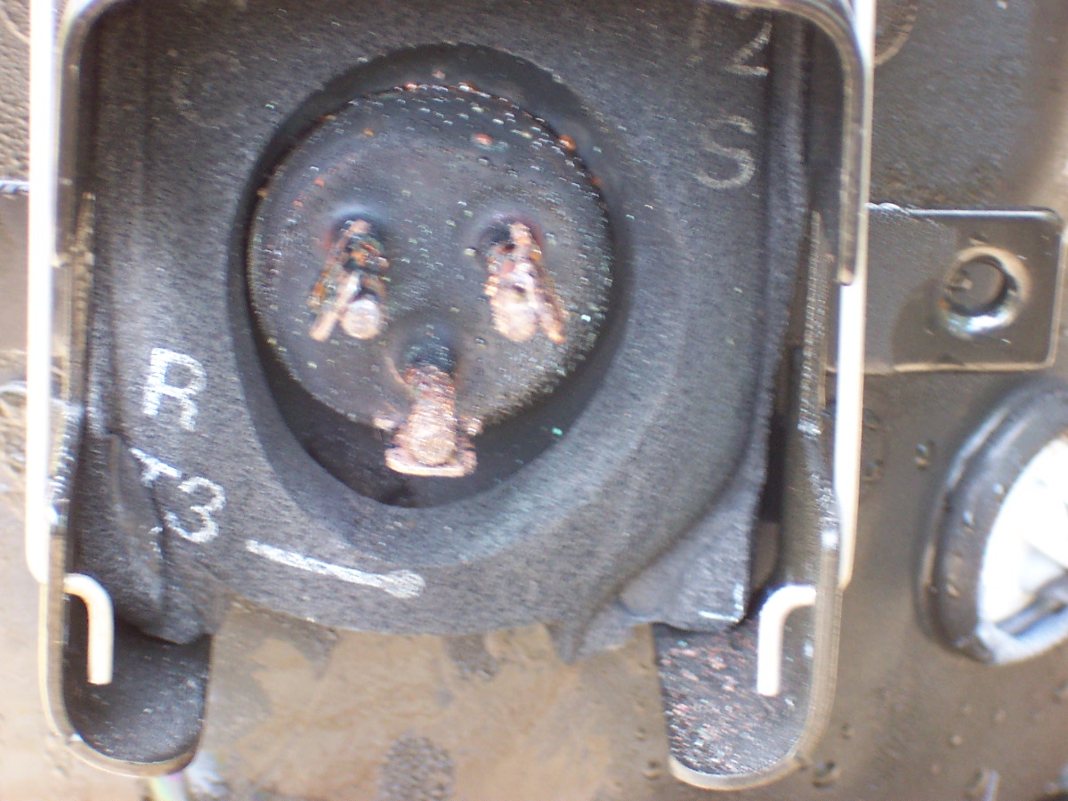

I've got a 3 ton Geothermal Heatpump that I have had for two years. Just before the one year anniversary the wires burned off of the compressor. They had routed the three wires under the compressor wire cover and over top of the compressor connections. My theroy was that vibration shorted them out.
My compressor was replaced under warranty and cost me $450. labor but mine is accessable on two sides and very easy to change. I complained about the wiring issue with pics and got $250. back from the manufacturer.

I have replaced wires that have had terminal ends burn off several times. They even make a kit for this. The compressors weren't hurt because of this
/ HVAC Compressor Shot #11
I put new connectors on the wires but by then the compressor was fried. I think it put voltage to the wrong wire with the compressor running.
