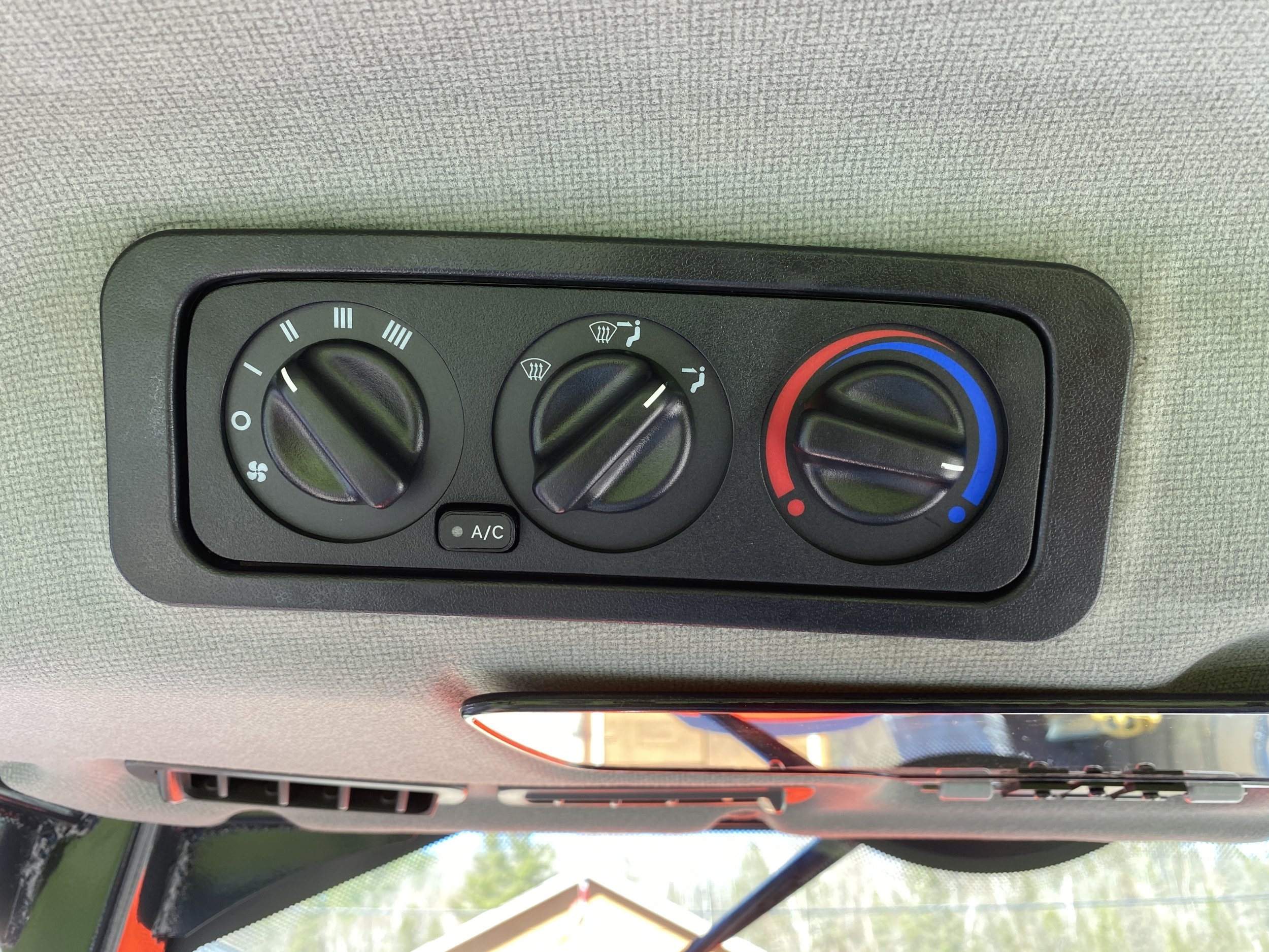

Just wondering if anyone knows how to remove the HVAC controls from a Kioti tractor?

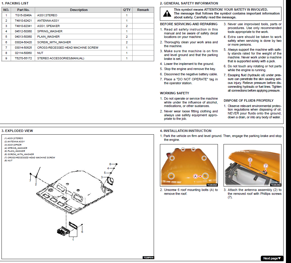

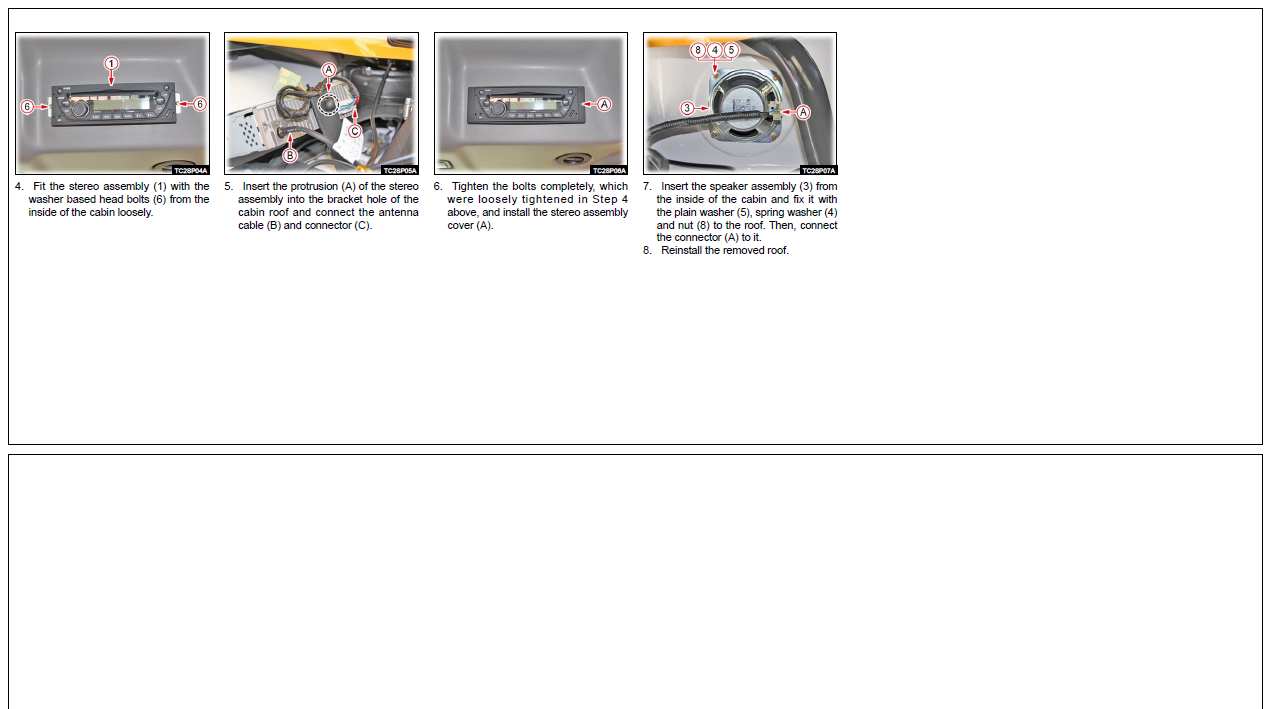

Interesting the service manuals I have downloaded have nothing on the Heat/AC or anything of the cab.
This is the instructions to install a stereo I would expect that the roof will have to come off to reach the AC controls also.
