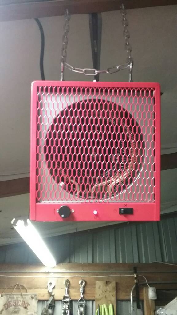

It's 6100sq.ft. 2 story, in sections. I'll soon add another 1,200. That's not including overhang areas.
This heater I installed today. I'm very happy with it. I fabricated a bracket using 1/4" steel at the top, eye bolts, chain and another bracket in back so it tilts down.

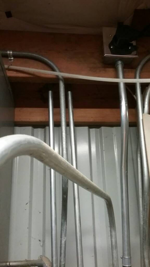

I used 10 gauge and a 30 amp breaker.
The front switch one direction the fan runs continuously, thermostat cycles heater on low. Other position the thermostat turns fan and heater on high. It looks like thermostat will go as low as 38F. 20190207_192743.jpeg20190207_192816.jpeg
