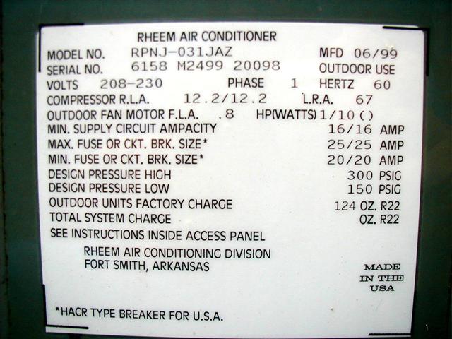

Before we finalize the deal to buy that house, naturally, I wanted to do a pretty thorough inspection, and I've done most of it. However, the owner has already moved a couple of hundred miles from here, but he left a pickup truck in the garage blocking the access to the attic. I know a little bit about HVAC systems, but not nearly enough, and no personal experience with heat pumps, although a couple of relatives have them and like them. The outdoor components look good; a Rheem "High Efficiency" heat pump. And of course I don't know whether that's really good or not.

</font><font color="blue" class="small">( The outdoor components look good; a Rheem "High Efficiency" heat pump. And of course I don't know whether that's really good or not. )</font>
Bird,
Not enought time right now to read back through the thread to see if info already posted so I apologize if this has already been covered.
If you want more info on the heat pump, open the access panel on the heat pump. There will be a decal inside giving all the info on it. Year of mfgr, capacity... "High Efficiency" was true at the time but may be "Low Efficiency" by what's available today. Can't speak for TX, but around here, they last about 15 years.
Brian
   / HVAC in the attic?
#60
Brian, it had that "High Efficiency" label (whatever that means) on top and the attached data decal on the outside.
