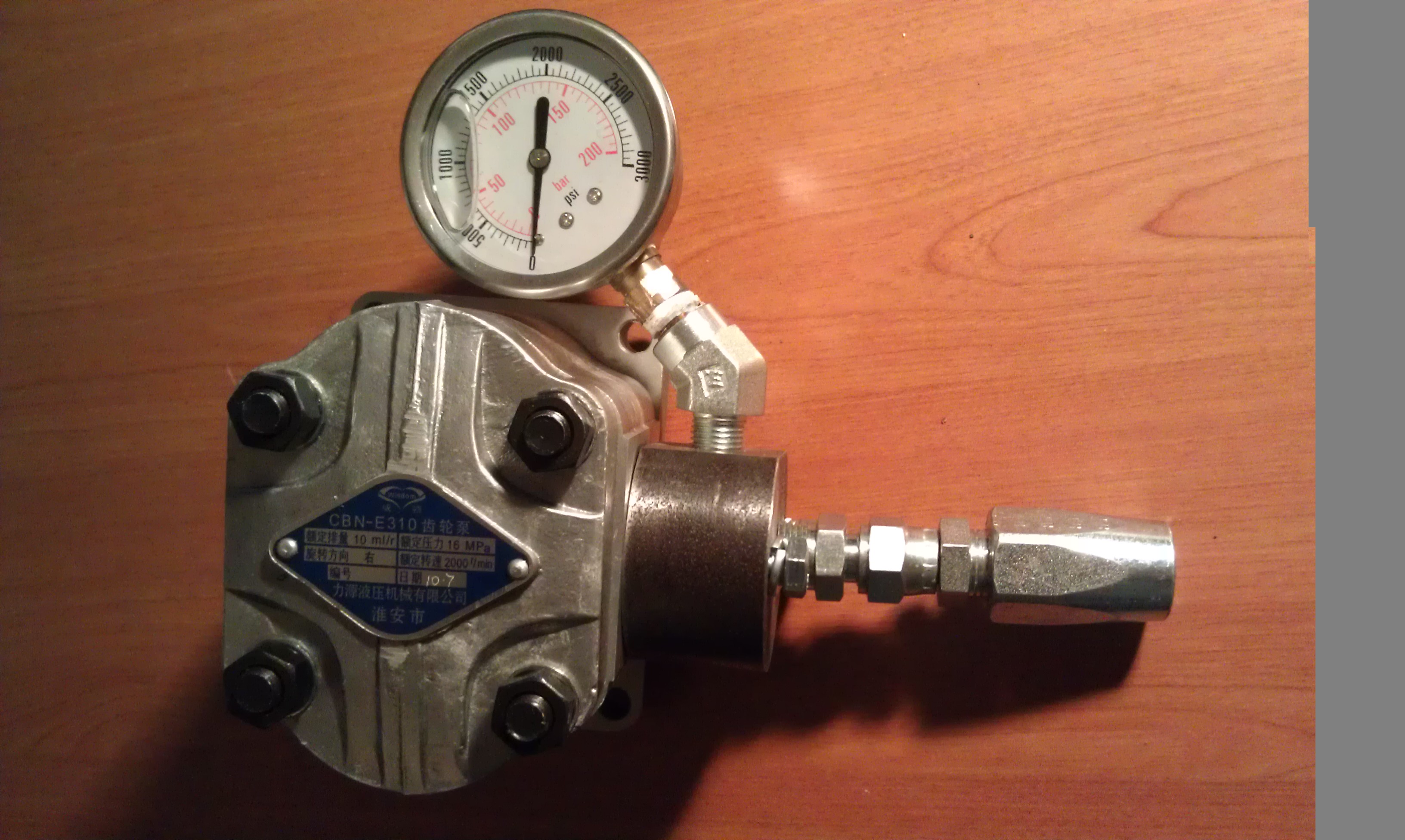

Meanwhile I'm staying on course to switch over to NPT/JIC for the pump pressure output line. This photo shows the barstock adapter to make the transition. It also shows the reusable hose end I plan to use. The pressure gage will be used during setup and later plugged. On the other end of the hose I already have a high quality adapter from Ronald at Ranch Hand and it will allow me to connect JIC directly to the BH valve assembly.

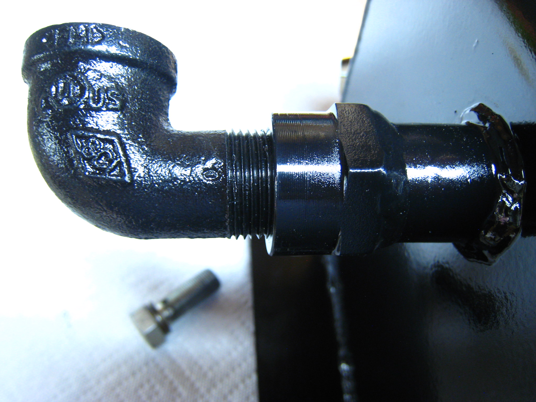

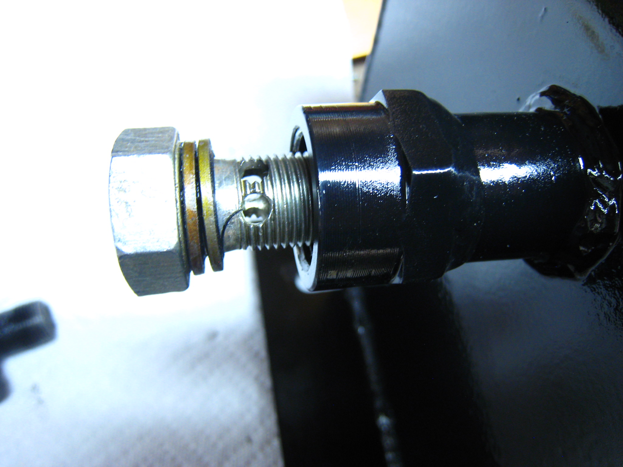

The tank return connection is done. A 3/4" coupling was cut at 2/3 to keep the center hex and it was welded on the tank where the banjo is normally connected. The banjo bolt is handy for holding the coupling in place during welding. Since the banjo bolt still fits, it might come in handy later.
Now I have a 3/4" line ready to pipe back to the 3/4 " filter outlet. Filter is 20GPM, 10 micron. Industrial rubber hose, hose barbs, etc. will be used to connect the filter outlet to the 3/4" NPT tank return connection.

That ought to work good. I initially did the same thing, and welded a street elbow over the banjo port to allow me to hook up a larger line from filter outlet to tank. Besides reducing the pressure spikes I was seeing at the filter, it also quieted the pump down. I think this was due to less air being entrained in the reservoir by the original narrow high velocity fluid stream caused by the small bore banjo bolt. The larger, slower velocity return stream into the tank puts less air bubbles into the reservoir fluid, so less air is sucked into the pump inlet.
Hydraulic fluid holds air bubbles very well. I had occasion to drain my BH reservoir the other day to add a longer pump suction line. I drained the system by disconnecting the pump output line where it connects to the valve inlet. I routed this line to a bucket and started up the tractor to let the pump move the fluid into the bucket. That line shooting straight stream into the fluid in the bucket put a ton of tiny air bubbles into the oil, that because of oil viscosity were very slow to work their way to the top...

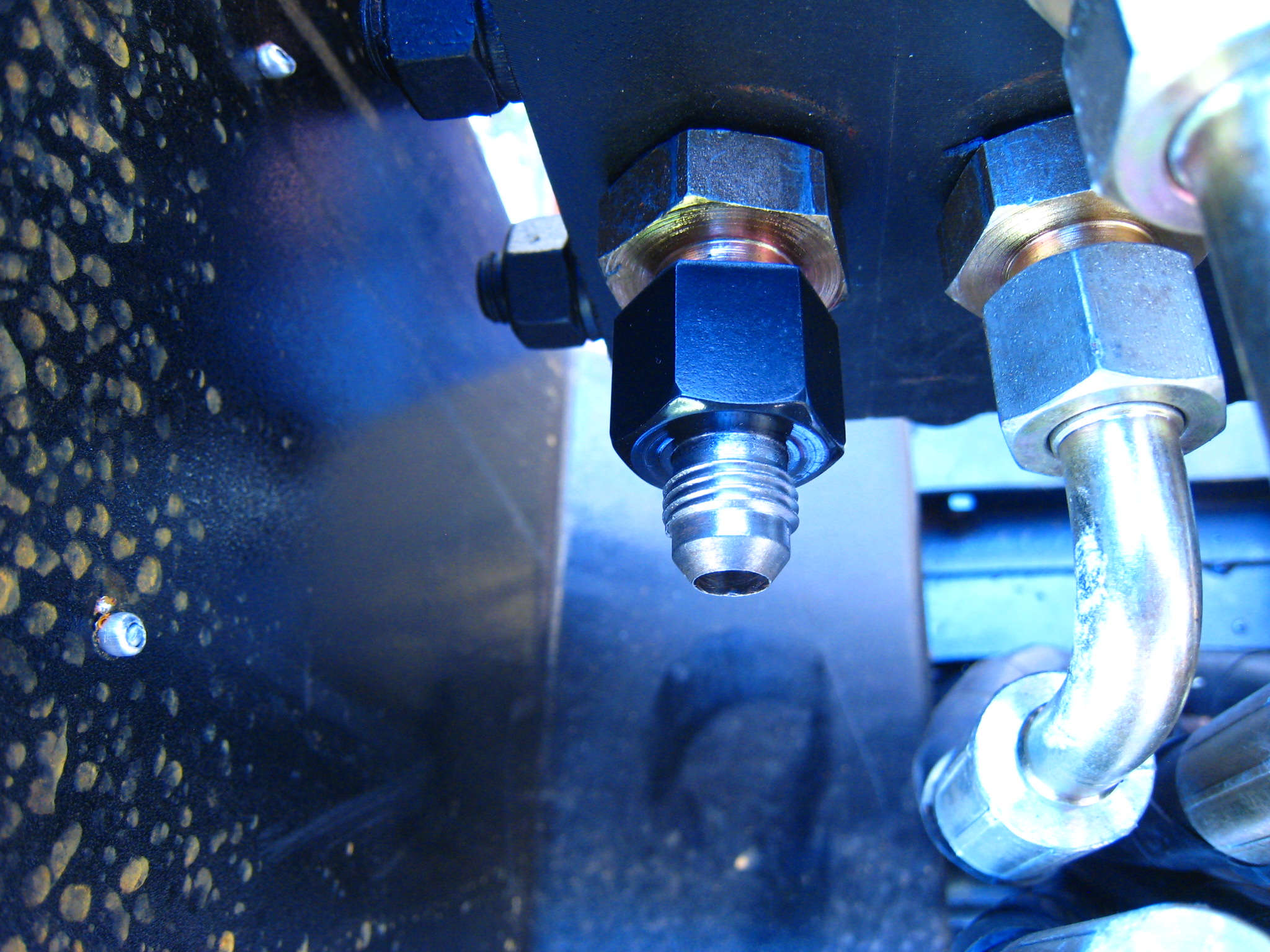

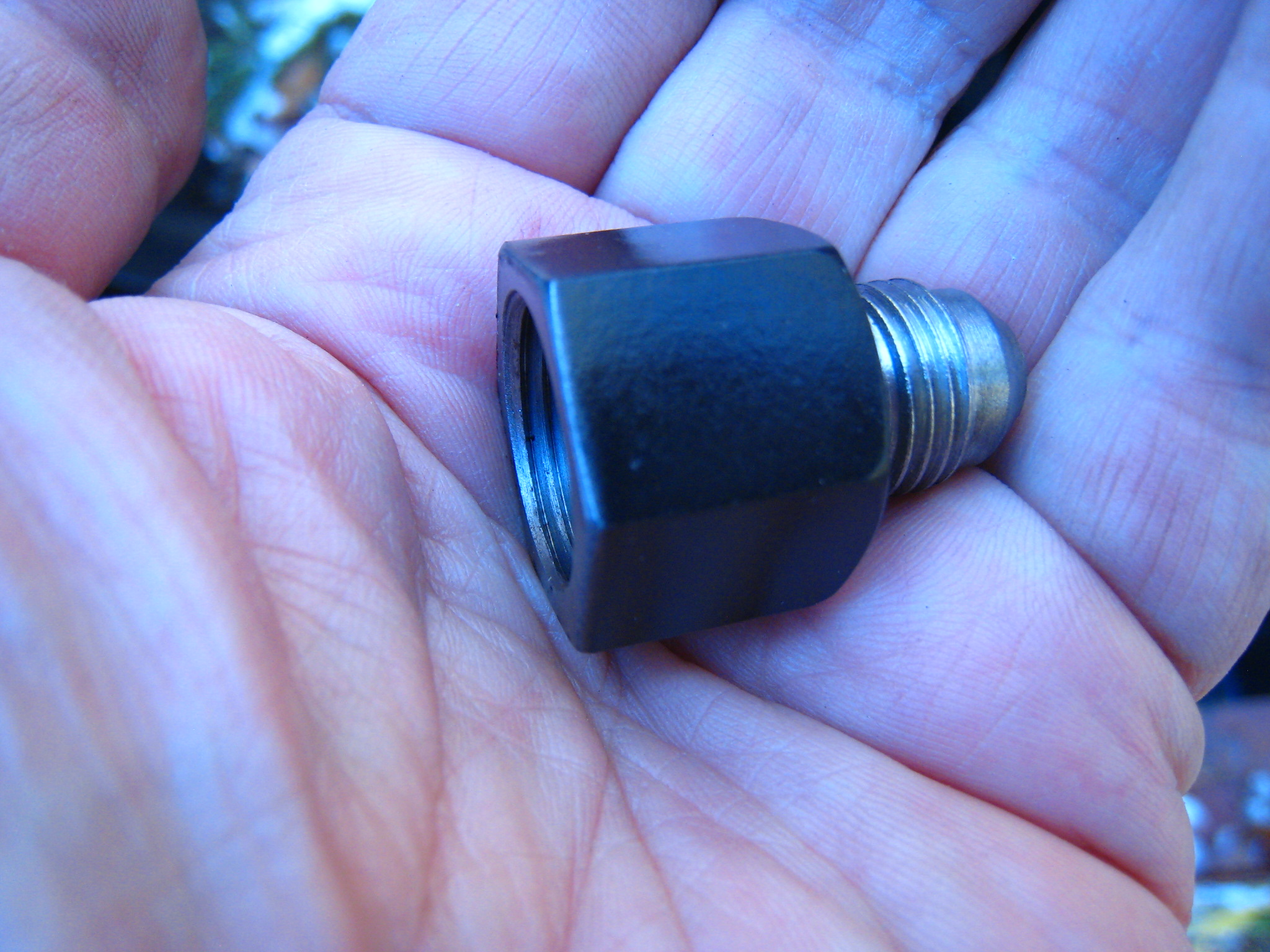

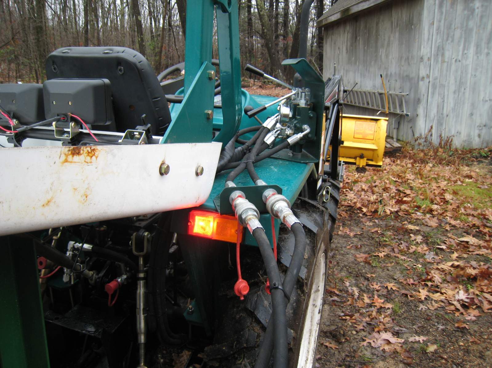

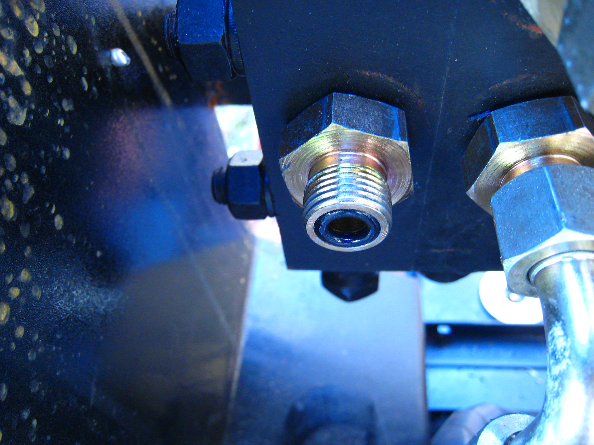

We have "Liftoff" ! Today I swapped out the Chinese high pressure and return lines with my own hoses made with reusable fittings. It began with high quality adapters from Ronald at Jinma Dealer, Wood Chipper , Compact Jinma Tractors
These little adapter fittings are high quality, packaged well, and really made my life easier. Pictures below show the high pressure inlet side of the valve assembly but I did the same for the return. The picture scale makes them look smaller than the original Chinese hoses but, in fact, the ID is slightly larger.
The inline return filter-directly-to tank is in.
Finally, I backed the tractor with the subframe up close enough to mount the pump, connect hoses, etc. I now have maybe 4 bolts holding the hoe to the subframe - enough to move it off the metal pan of the angle iron crate. All systems are go. So far, no leaks and no real problems except for an oversize O-ring on the suction connection. I snipped it to length and installed it anyway. Later, I'll replace it. For now, I just want to get it up and running and debug any remaining surprises.
Over the next few days, I'll check and adjust the relief valve, secure the filter line, retighten all bolts, make a bracket to hold the return filter, etc.

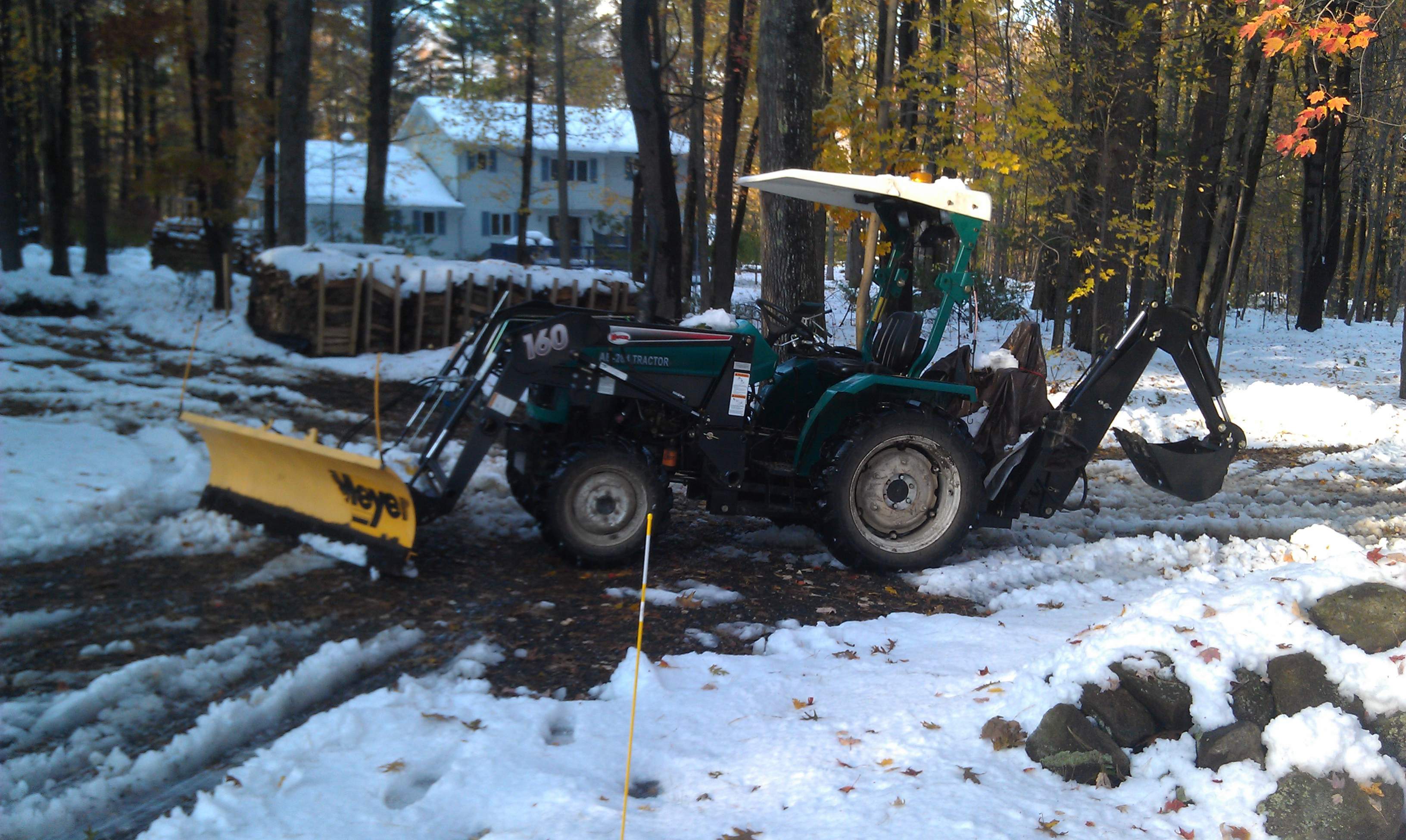

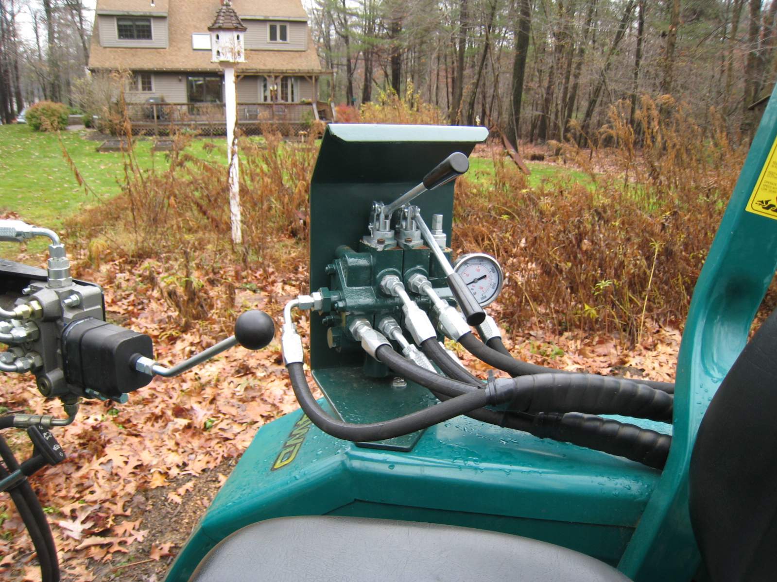

We had 12" snow for Halloween but BH is done! I might use my extra remotes, front and rear, to add a thumb later.
