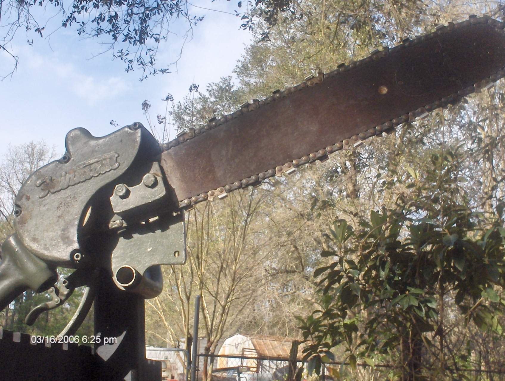

Yes, it should do 6 in very well. A trick so it doesn't peal the bark, it to cut a little on the bottom first. The hand type hyd chain saw will take just about whatever bar and chain you put on it. That is the one I was going to put on a boom pole and be able to trim up about 20 to 25 ft. Here is a picture.

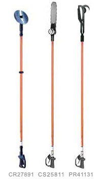

Here are some pics of the pole saw used by the crews here trimming the power right-of-ways.
I think they just cut all the way through before the limb can start to drop and it makes a clean cut.
