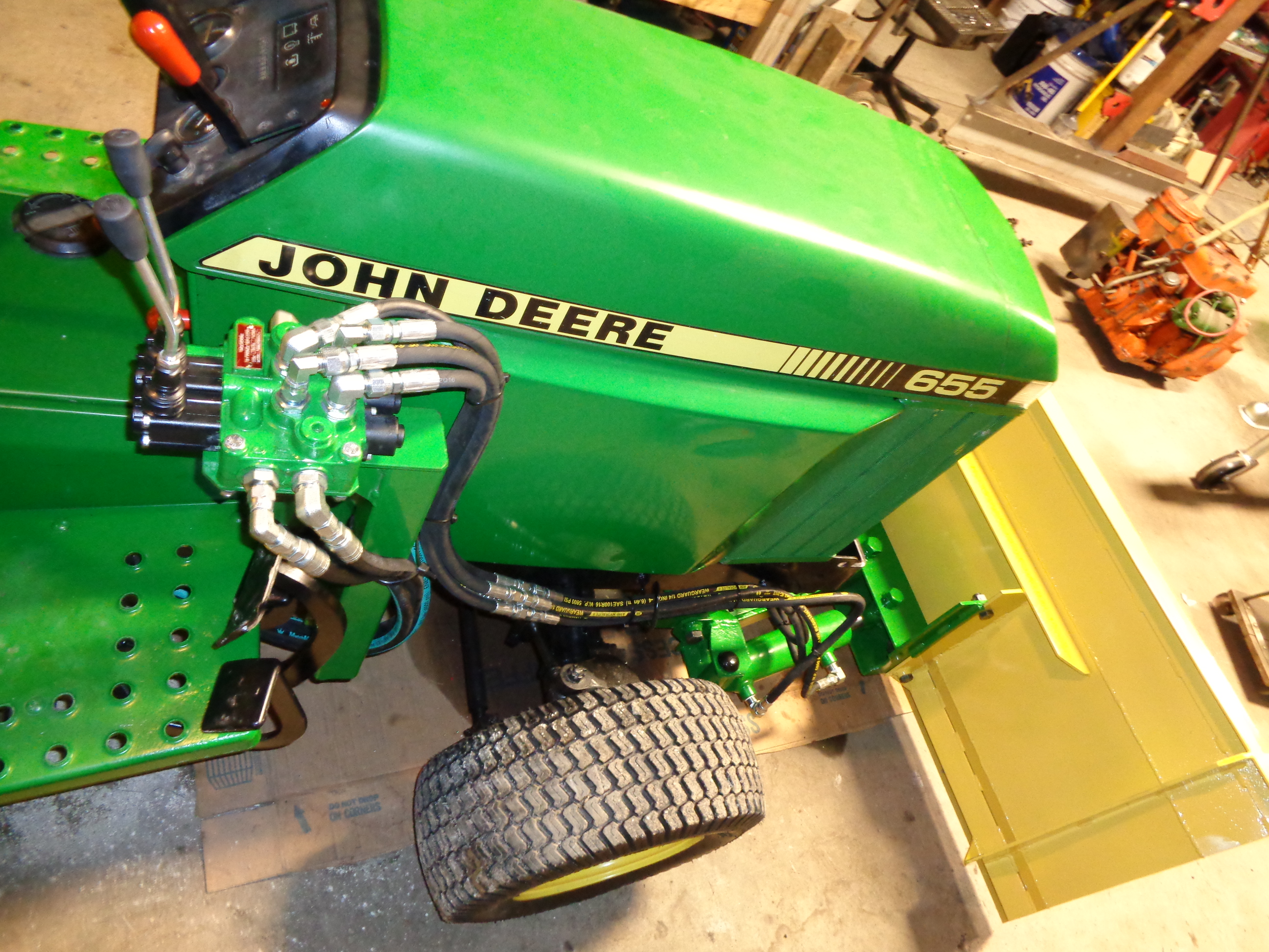

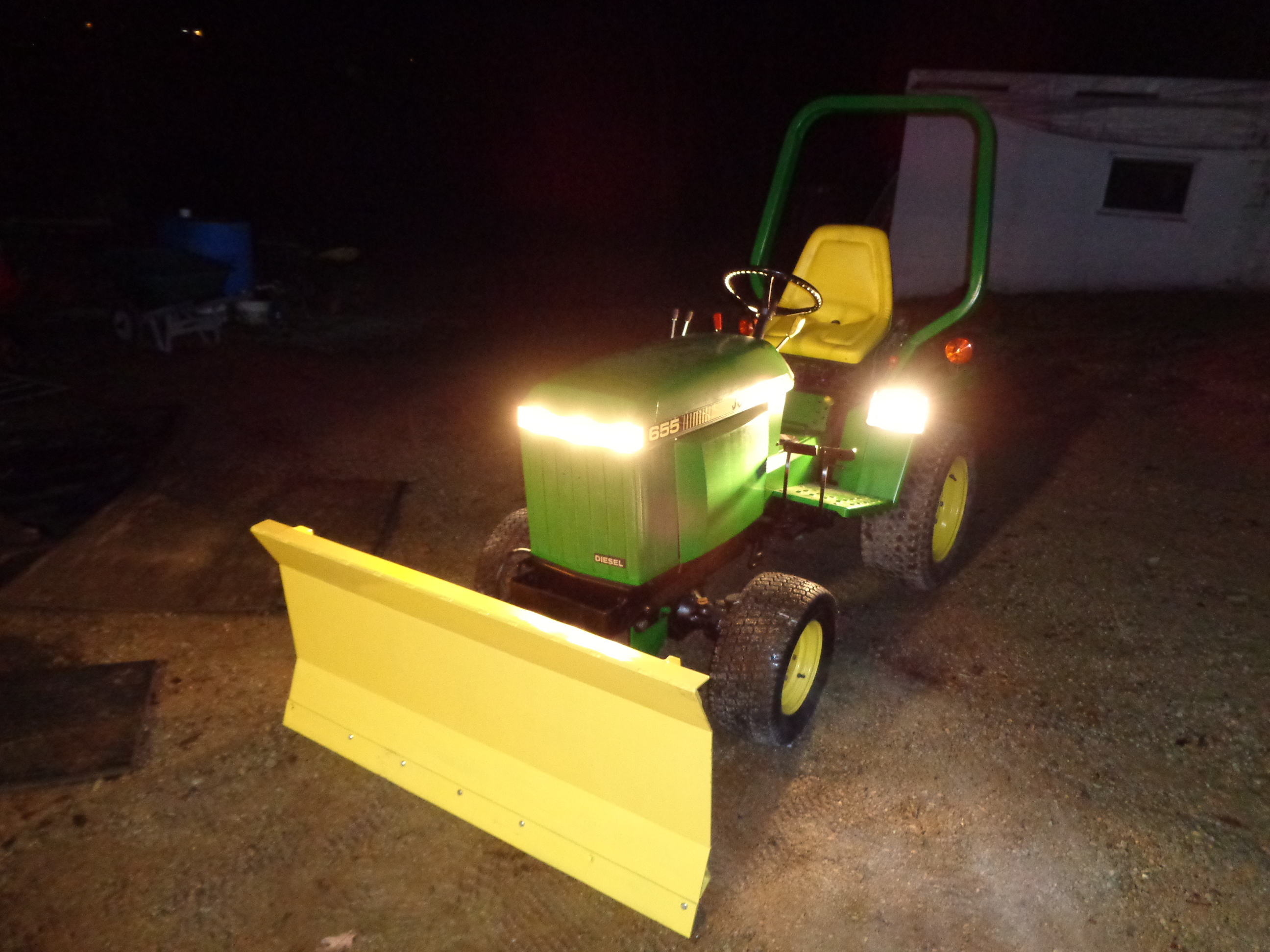

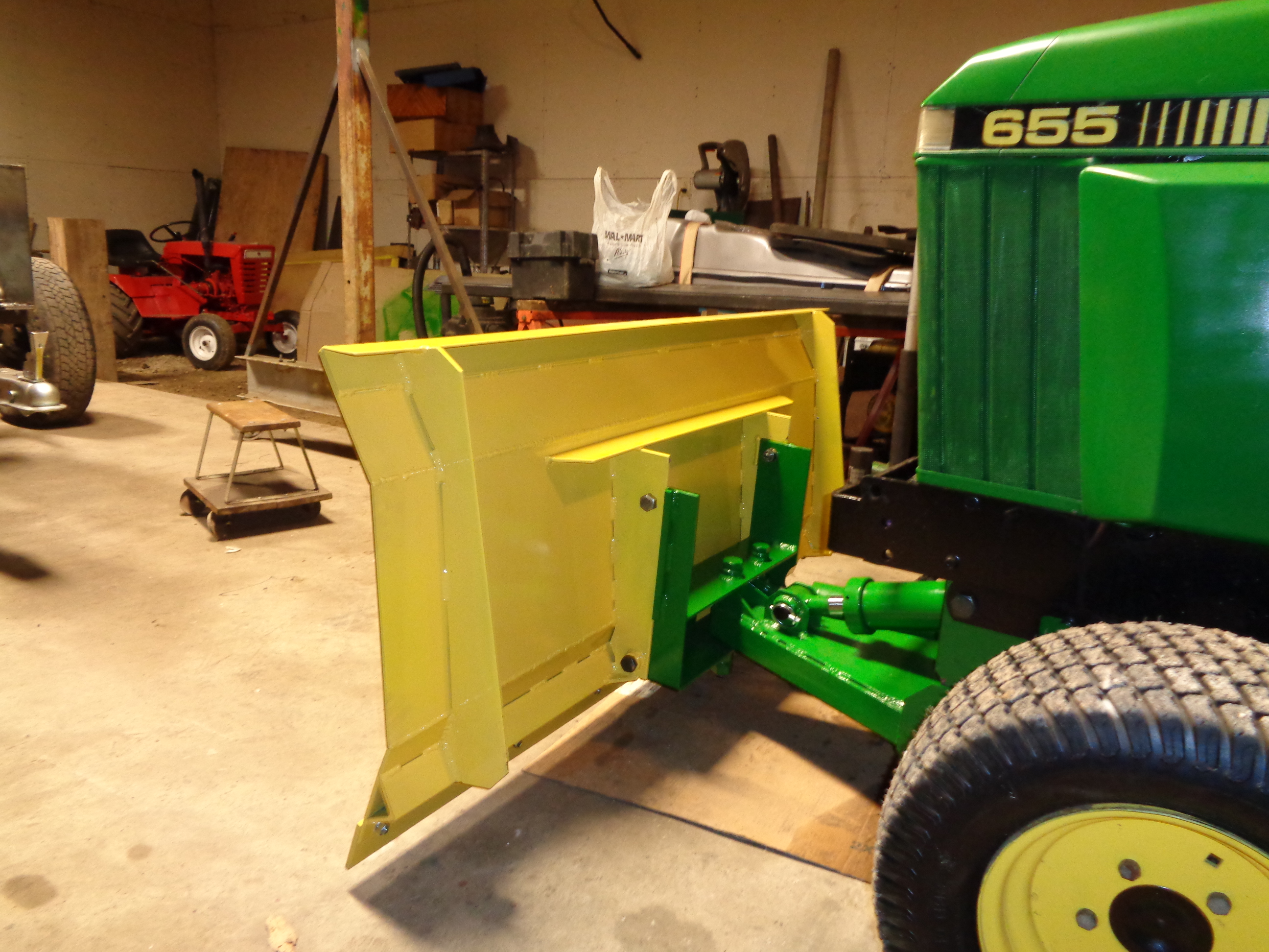

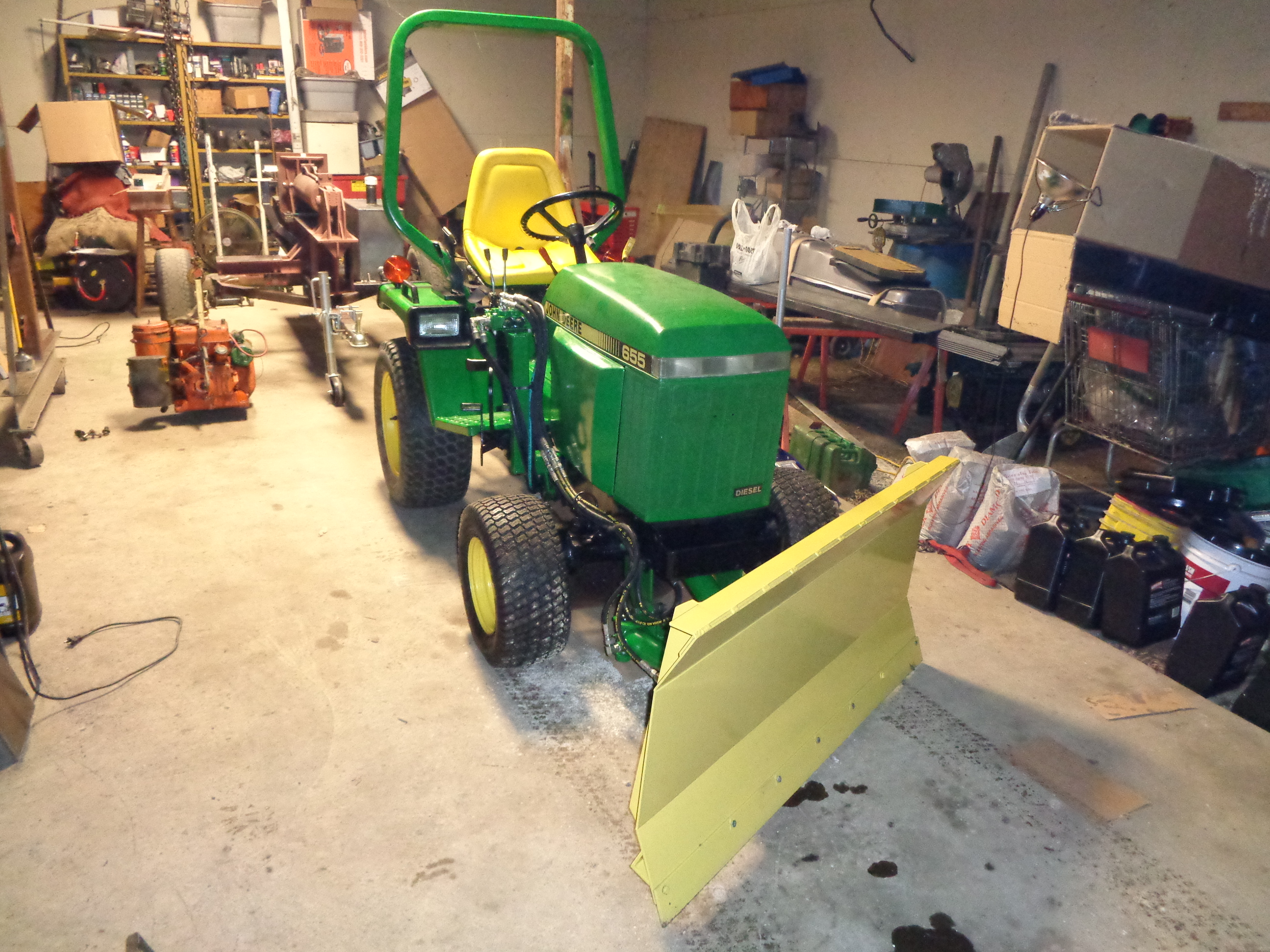

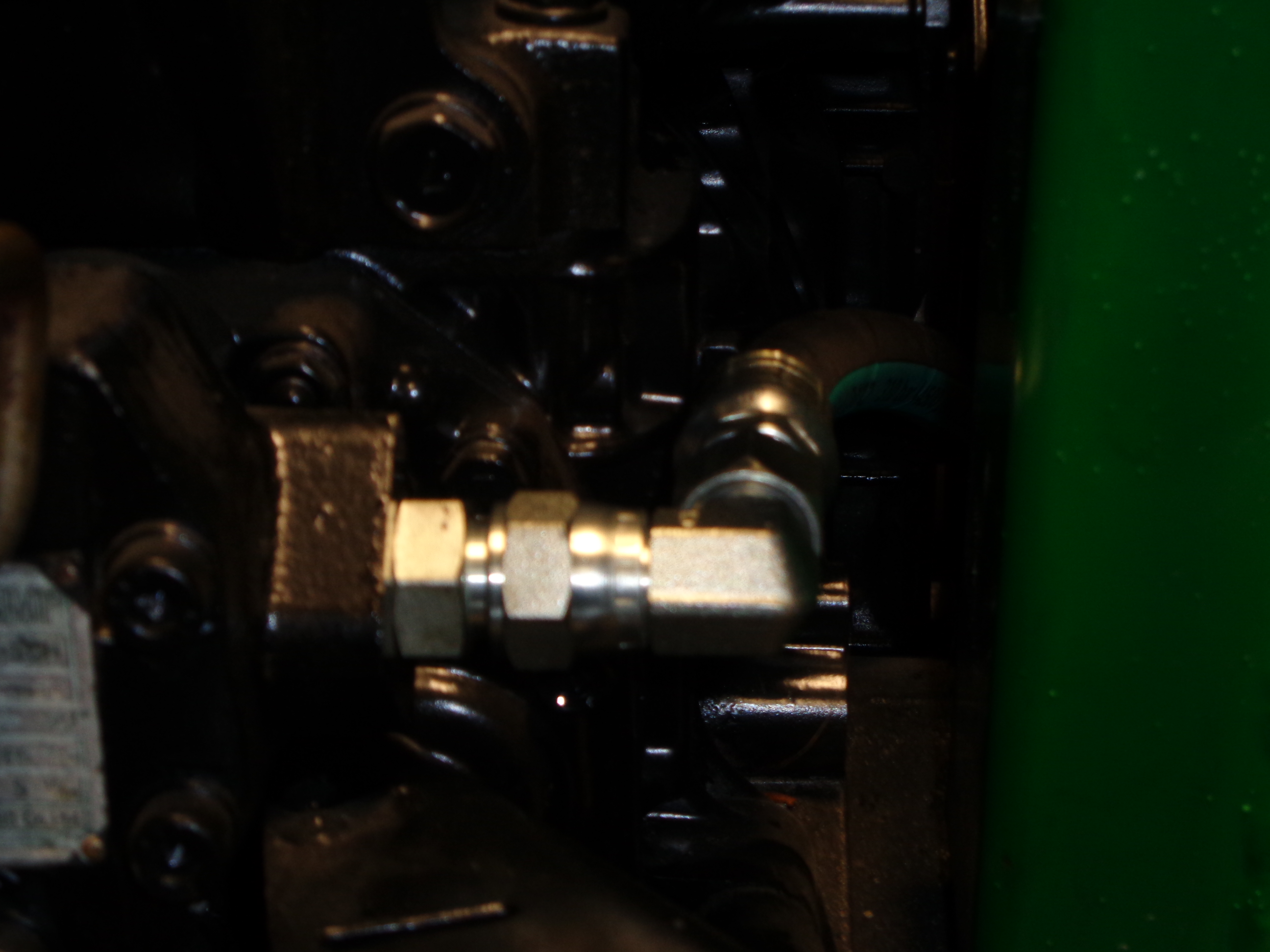

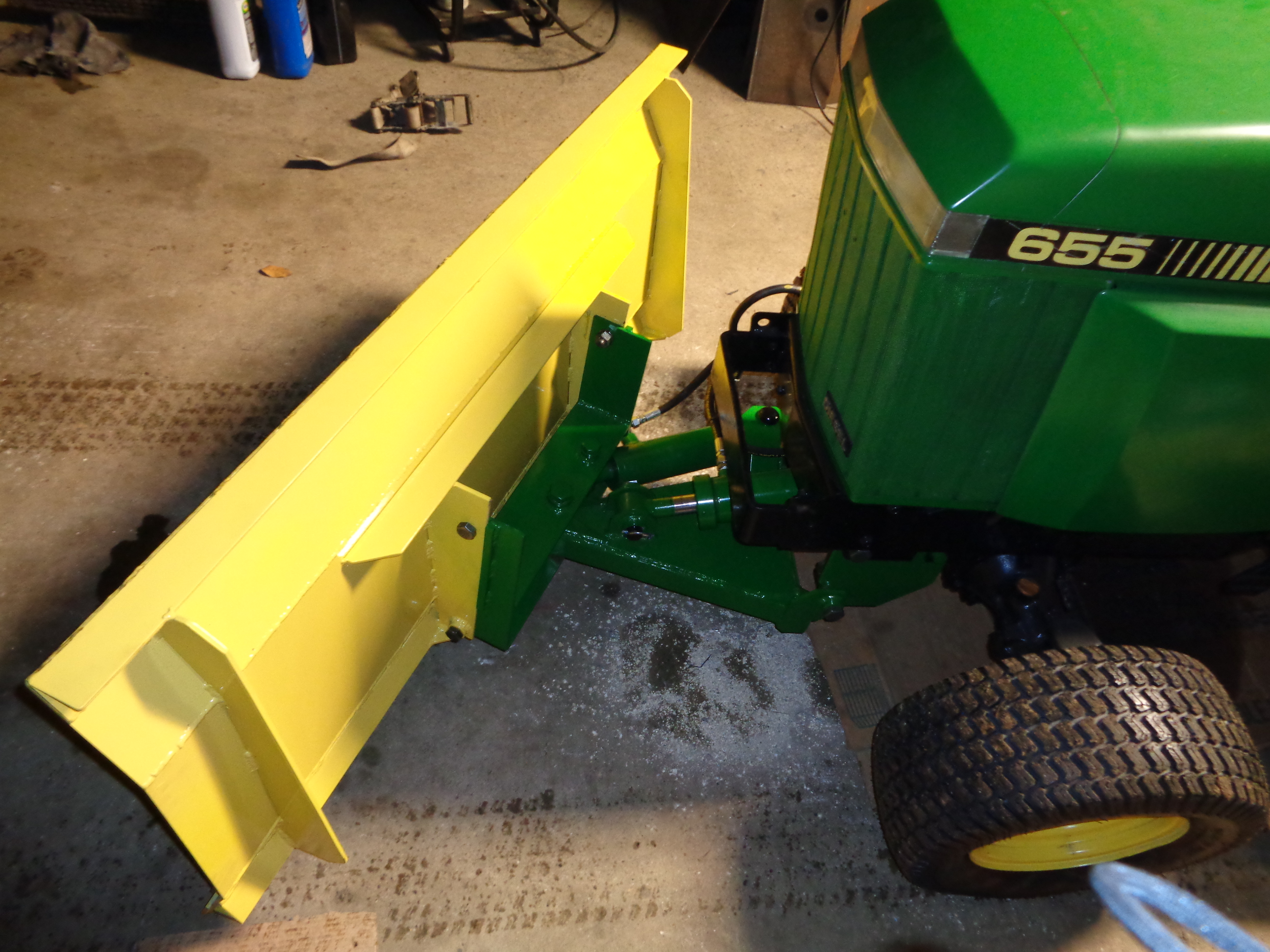

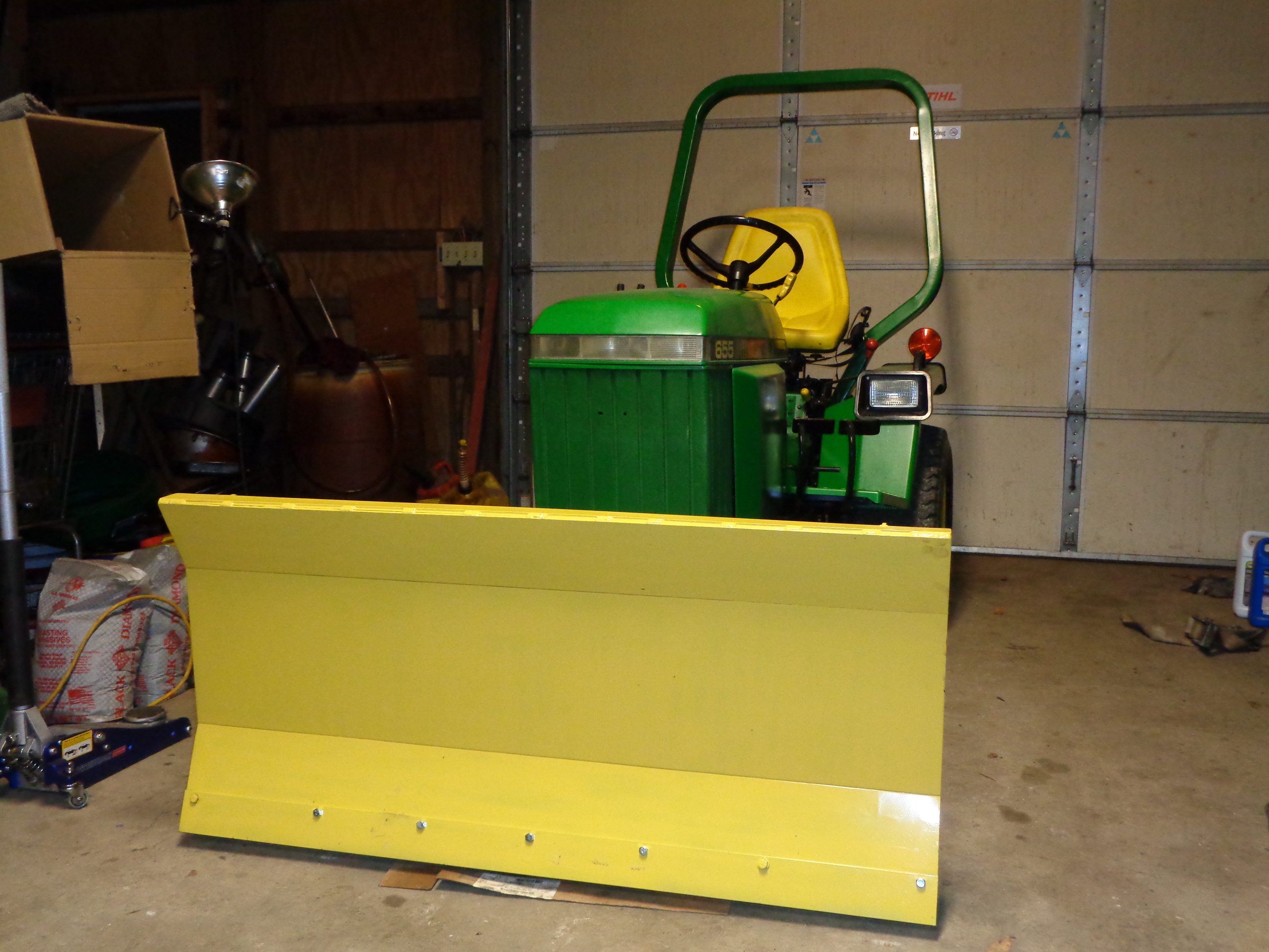

Got the hydraulics all hooked up today, they work pretty Good! Im surprised how fast and responsive they are. The only thing is is the steering wont work wile the plow is being used, but thats workable i guess. I know alot of the other models use a dual pump system to ensure no loss of power. The last pic is the new supply line to the new valve. Everything is painted and looks shiny. Im pleased overall with how it turned out, now to try it out.....
