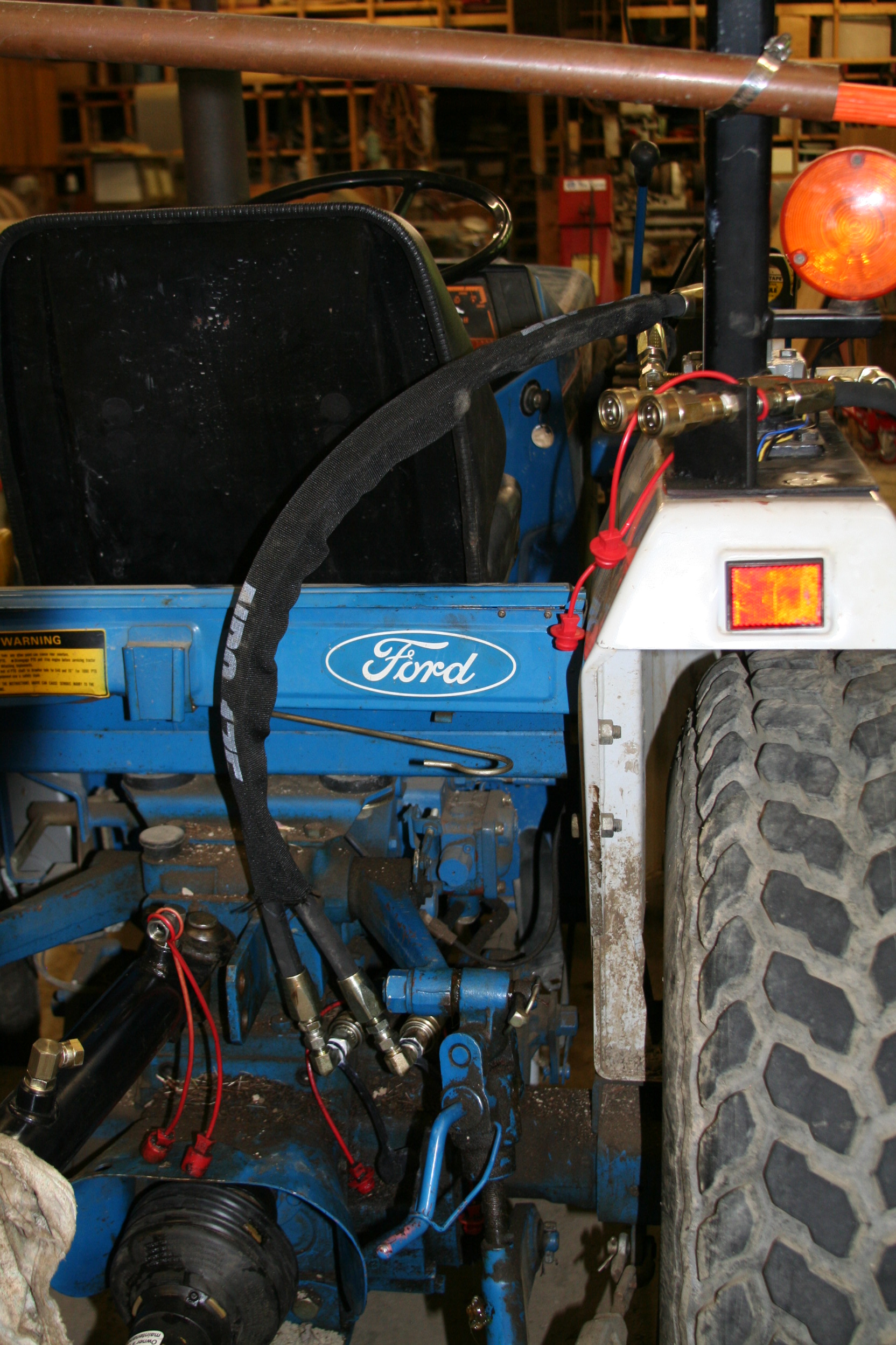

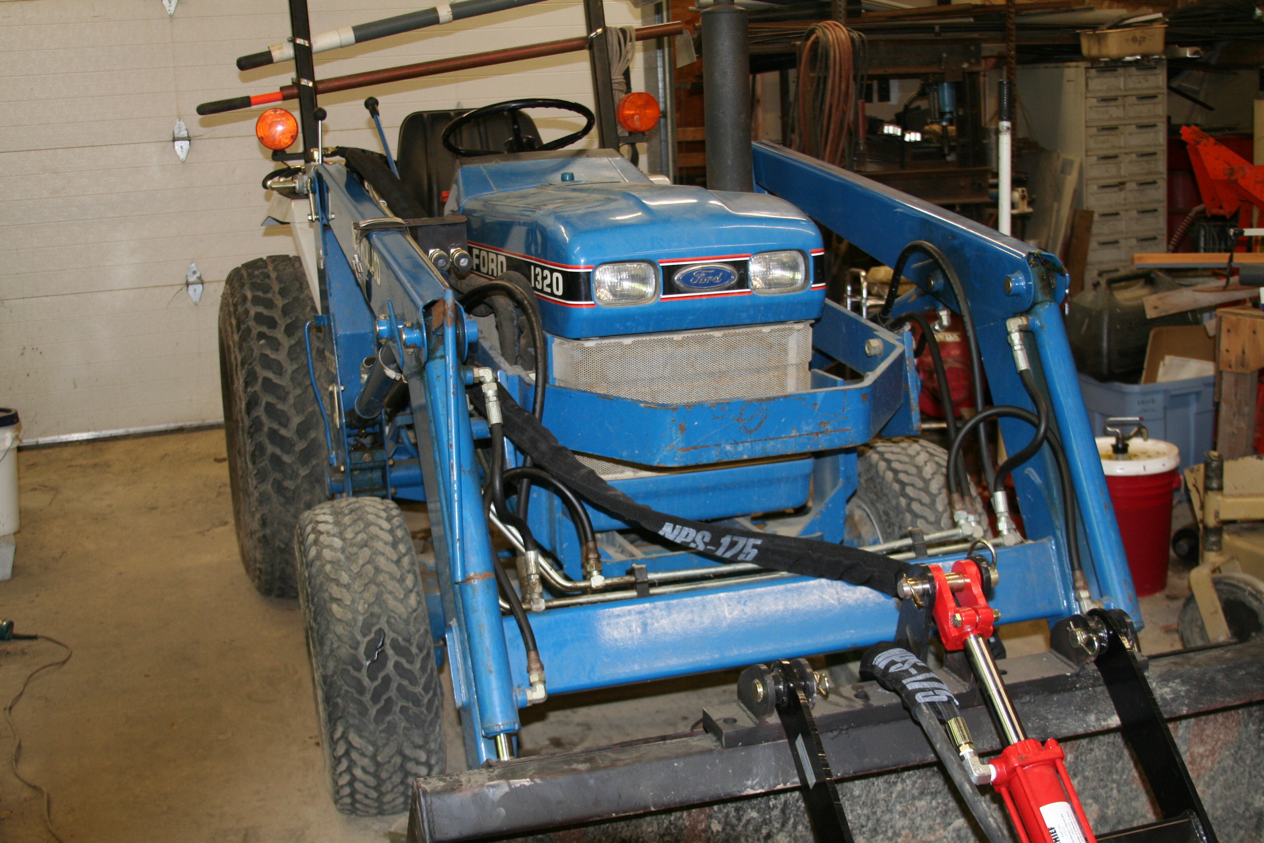

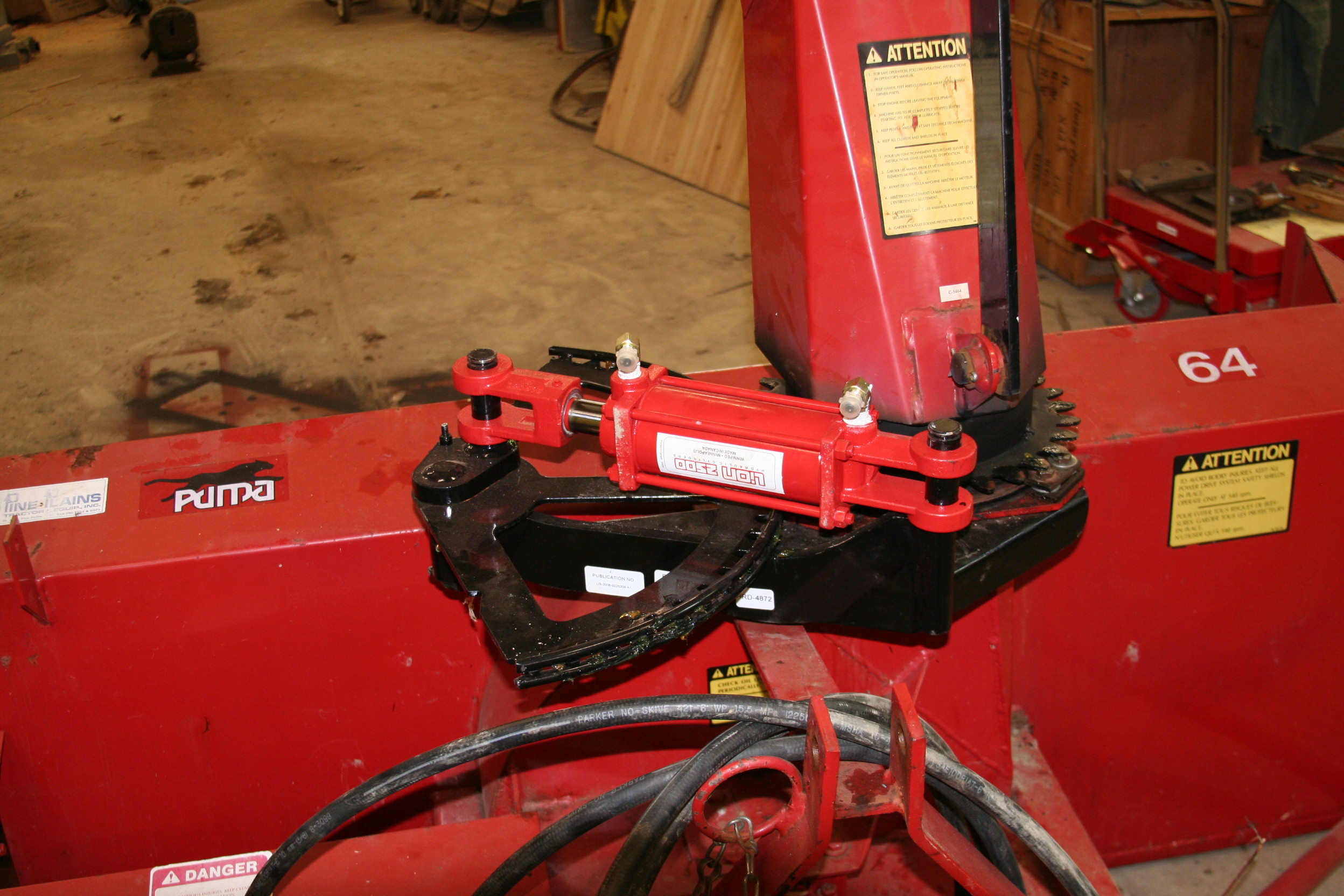

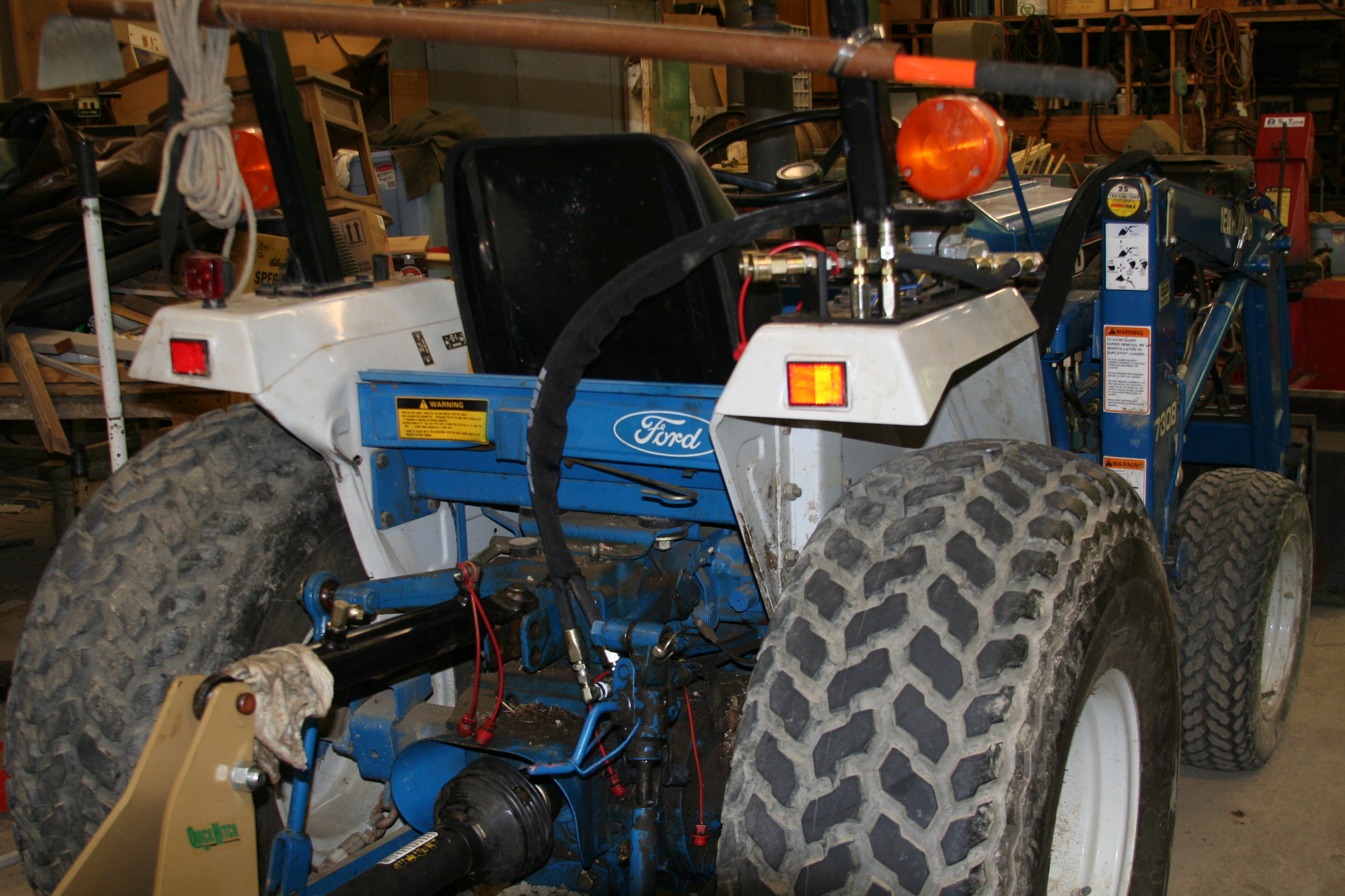

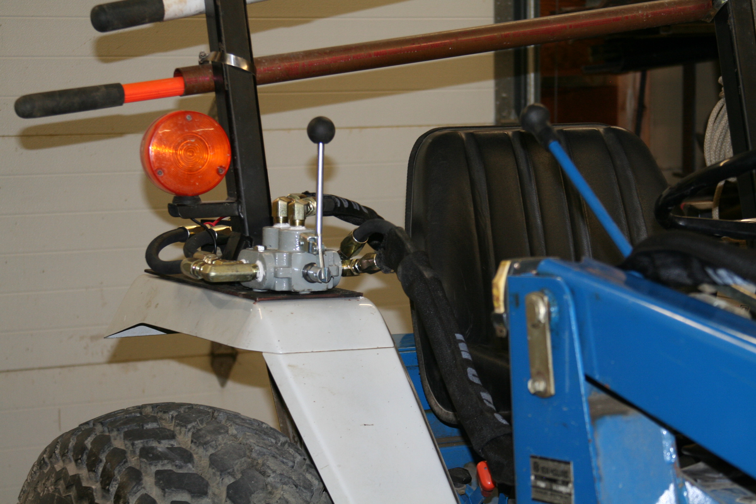

I guess this belongs here. One rear remote . Added a diverter valve to run angle plow up front and snow blower chute in the back. Front also runs a thumb in the summer.
First attempt at pictures.

Welcome and nice job! I like the hoe rack on the back. Any problems plumbing the lines?
   / Hydraulic adds
No problems plumbing except running out of fittings. Also could not decide on R1 or R2 hose. Had some of each. R2 is way over kill but much more robust. I use reusable hose ends and they are hose size specific. I wish I had a crimper $1000 and could use crimp fittings. There are more types available and they are cheaper.
There is a shovel above the hoe. It's nice , they go where I go.

Nice setup for the snowblower. Although I use a hydraulic motor and mine spins 360 degrees, cause I like to shoot myself in the face every once in awhile. :D

Nice clean install. That's a high dollar hoe holder you have there (copper pipe?).
