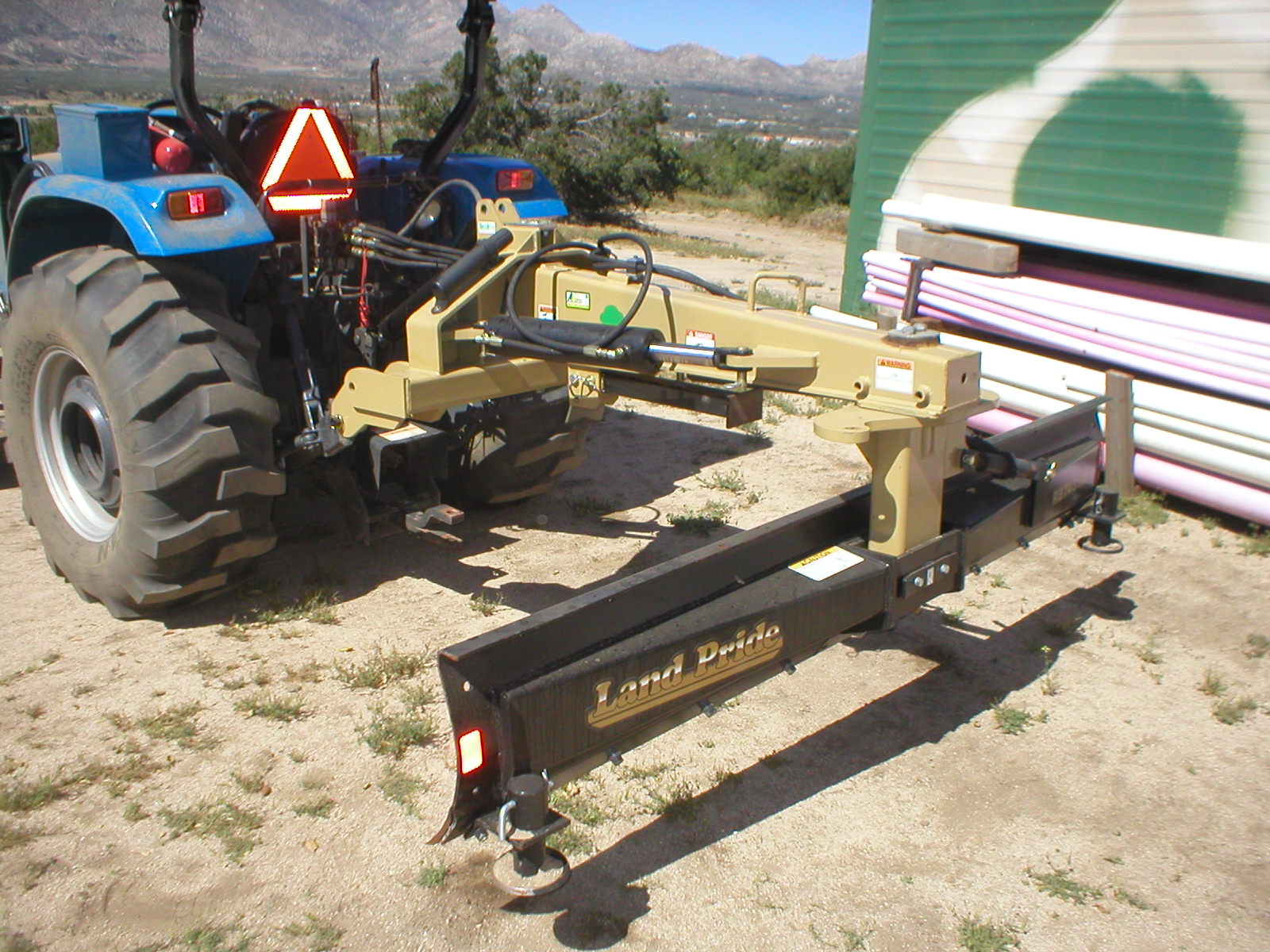

I just pulled the trigger on a LP BB with a hydraulic scarifier bar today. Really expensive but I decided I'll use it a ton and worth it in the long run.
tough decision because it cost fully triple what a pretty decent looking HD ETA BB costs.
But where does it end? Do folks think getting an rear angle blade (or landscape rake for that matter) with a hydraulic angle adjustment worth triple the price of a fully manual one (I will have TnT)?
Maybe I can rent an manual angle blade and then decide if triple the cost is worth it.....
   / hydraulic angle blade, worth triple the price? #2
I have a bb similar or the same as you, but don't have the need for one on my grader blade or at least not enough to pay for it. Our renters have on their big John Deere and it is nice, I just don't use a blade that much.
   / hydraulic angle blade, worth triple the price? #3
A couple of questions. Do you think that you will use the rear blade very often? If so, just what will you be using it for?
Pulling the lever, especially while your on the move sure is nice compared to stopping the tractor, getting down off the tractor, walking back to the blade and changing the angle, walking back to the tractor, getting on the tractor, start moving and then realize that you forgot to offset the boom. Now you get to do that all over again. Lets see, 5 minutes vs 5 seconds. You know what they say, speed costs money, and lots of it.
I know that I made the mistake of getting a $1000 medium duty manual adjust rear blade. Good blade for the right tractor and for someone that was not going to be using it all that much. None of which met my conditions. :( Two things, if you are going to be using it very much, get hydraulic adjust, at least the angle. If you can afford it, just do it right and get the whole thing hydraulic.
If you want all hydraulic and want to save some $$$, buy the unit without any adjusters or hydraulics. Waaaaay cheaper to get it that way and get aftermarket cylinders. I learned that the hard way. :eek:
Last thing, ARE YOU GETTING ANY YOUNGER? :confused3:
Good luck with your decisions. ;)
