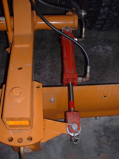

Has anyone added a cylinder to a standard rear blade (customized) so that the blade can be angled hydraulically from the tractor rear remote?

I put a cylinder on my Woods RB84. When you have a cab tractor, why get out into the cold to angle that blade /forums/images/graemlins/grin.gif. I will post a photo tomorrow night.

   / Hydraulic Angle Rear Blade #5
JD,
Here's a photo of my cylinder setup.

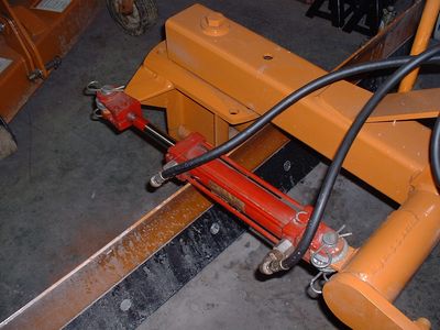

   / Hydraulic Angle Rear Blade #6
Here's one more
   / Hydraulic Angle Rear Blade #7
JD,
My setup allows the blade to be angled to within about an inch of the original manual blade holes. More than enough angle. I used a 2 x 8 hydraulic cylinder. I was not concerned about reversing my blade and pushing backwards. I pull all my snow and gravel towards the tractor.

   / Hydraulic Angle Rear Blade #8
Great idea and nice work on the hydraulic angle adjuster thinga mabob. I think I will have to copy your work. This also makes me think about using a hydraulic motor for 360 degree rotation.
   / Hydraulic Angle Rear Blade #9
Bill the hydraulic police are on to you now. Did I see common black pipe fittings (90 degree ells) subject to brute hydraulic force? If so a definite no-no in the hydraulic world. /forums/images/graemlins/wink.gif
Nice set up with the cylinder, gives me a few ideas myself. /forums/images/graemlins/grin.gif
   / Hydraulic Angle Rear Blade #10
PR,
Guilty as charged /forums/images/graemlins/blush.gif. FYI, two days ago I ordered the proper fittings from the surplus center and they should be here in a few days. Please, anyone out there thinking about doing a hydraulic project, use the correct hydraulic fittings. Spraying hydraulic oil IS very dangerous. Just to give you alittle background on my cylinder, it's 12 yrs. old and has been on 3 different pieces on machinery with those same black pipe fittings. It was one of those things that I used those fittings to test the unit and never got around to replacing them with the proper fittings. Everyone who is guilty of the above, please stand up!!!!!!!!!!!!!!
