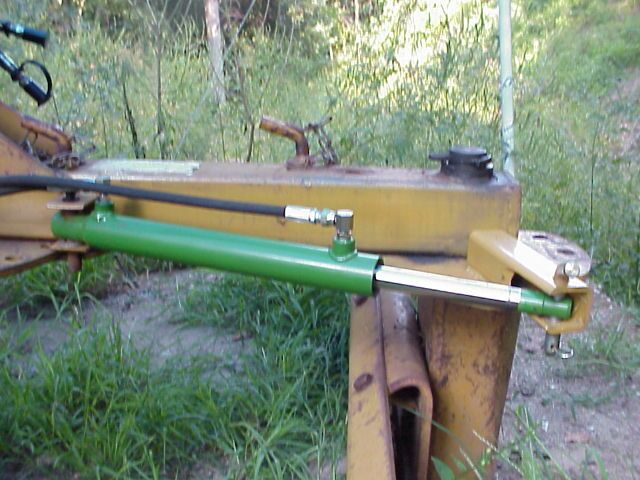

Check my approach on a low cost blade. It works great with no problems over the past couple years. Pictures are posted at: Pictures Several other public picture albums are available at that site.
The T'N'T really helps the blade useage. My design is easily removeable for reversing or puting it on the landscape rake.
I posted a full description of the parts, etc in a post a year or so ago.

Hey JR I didn't see any pictures of the blade reversed. Can you be so kind as to post a picture of either the blade or the rake reversed? I would like to see the hydraulics in that position as well. Thanks!
   / Hydraulic Angle Rear Blade #23
The angle cylinder does not work when the blade is reversed. It must be released from the blade before the blade is reversed and the lock pin inserted.

Looks great and appears to be a pretty straight forward mod. This is something thats been on my list to do for while.
I'm assuming you can still spin it around if you wanted to and pin it.
Can someone tell what a cushion valve is? Is this something that would be on the cylinder like a check/pilot valve?
   / Hydraulic Angle Rear Blade #30
CT,
You can spin it 180 degrees by removing the cylinder pins. With another front cylinder mount on the opposite side, you could rehook the cylinder and use it in the reverse angle mode. I plan to add that this summer.
