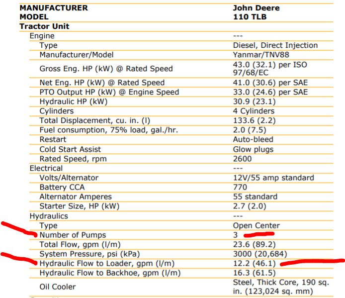

Hello,
I recently decided to purchase a new Danuser EP10 hydr auger with skid steer front mount for mu John Deere110 tlb. I have always used a rear pto 3-point w/ hyd down force in the past. Got an opportunity to try out the new one yesterday. This model based on the front flow of my machine is 12gpm which equates to approx. 60 rpms. Quit slow compared to the old 3point pto model. As far as performance the auger slowly corkscrewed full depth very easy at tractor idle, never even grunting. Plenty of power even in very dry clay/rocky ground. Prob is that I stopped the spin at the bottom then lifted the auger straight out, reversed the auger,etc. Only to notice the hole was completely filled with pulverized spoil. I dropped back in the hole, drilled quickly to bottom, started spinning while letting it dwell hoping the spoils would come out which it really didn't. Pulled up,etc,etc,etc. Did this over and over across about 8 holes(9' auger btw). Only to realize that every hole k=now needed to be manually cleaned out which is ridiculous. The old fashioned 3-point spun much faster which allowed to lift it out while slinging the spoils. The hydraulic units spin very slow which prohibits drawing out the loose dirt. Tried drilling a foot then extracting up then back down incrementally, etc. Didn't really make any difference. My as well be drilling holes at the beach. A heavy investment for the entire system with augers. Very disappointing results. Not sure what I'm missing here on operational techniques. Anyone own one of these that have any input appreciated. Thanks

I recently decided to purchase a new Danuser EP10 hydr auger with skid steer front mount for mu John Deere110 tlb. I have always used a rear pto 3-point w/ hyd down force in the past. Got an opportunity to try out the new one yesterday. This model based on the front flow of my machine is 12gpm which equates to approx. 60 rpms. Not sure what I'm missing here on operational techniques. Thanks
12gpm is most likely at rated engine RPM which is 2600.

That does remind me, (I know it says you have 3 hydraulic pumps) if the implement is sharing the hydraulics with the FEL (instead of auxiliary or using patch lines to the rear hydraulics - using the grapple hydraulic ports comes to mind) it will drop the flow while the FEL is operating.
That makes me wonder as I was aware of the the flow rates for the front end loader and backhoe, but the auger is directly hooked up th ethe 3rd function quick connects. I am not sure if they share the same front loader pump or if they plumb of one of the others?? The 3rd fuction control allows flow to both the front and rear auxiliary hydros. Regardless, the auger is turning at the speed Danuser says it should be, but I am curious.

If you have a spare rear remote, check and see what the flow through that is. If it is higher than what is available at the front, plumb from the rear remote to the front. Better yet, hook that auger to the back hoe arm and run it that way.
   / Hydraulic auger problem #17
Flow can also change by hose and fitting size. If your machine has factory rear remotes some where there should be info on the flow and pressure of each.
Do you have a hydraulic schematic?
