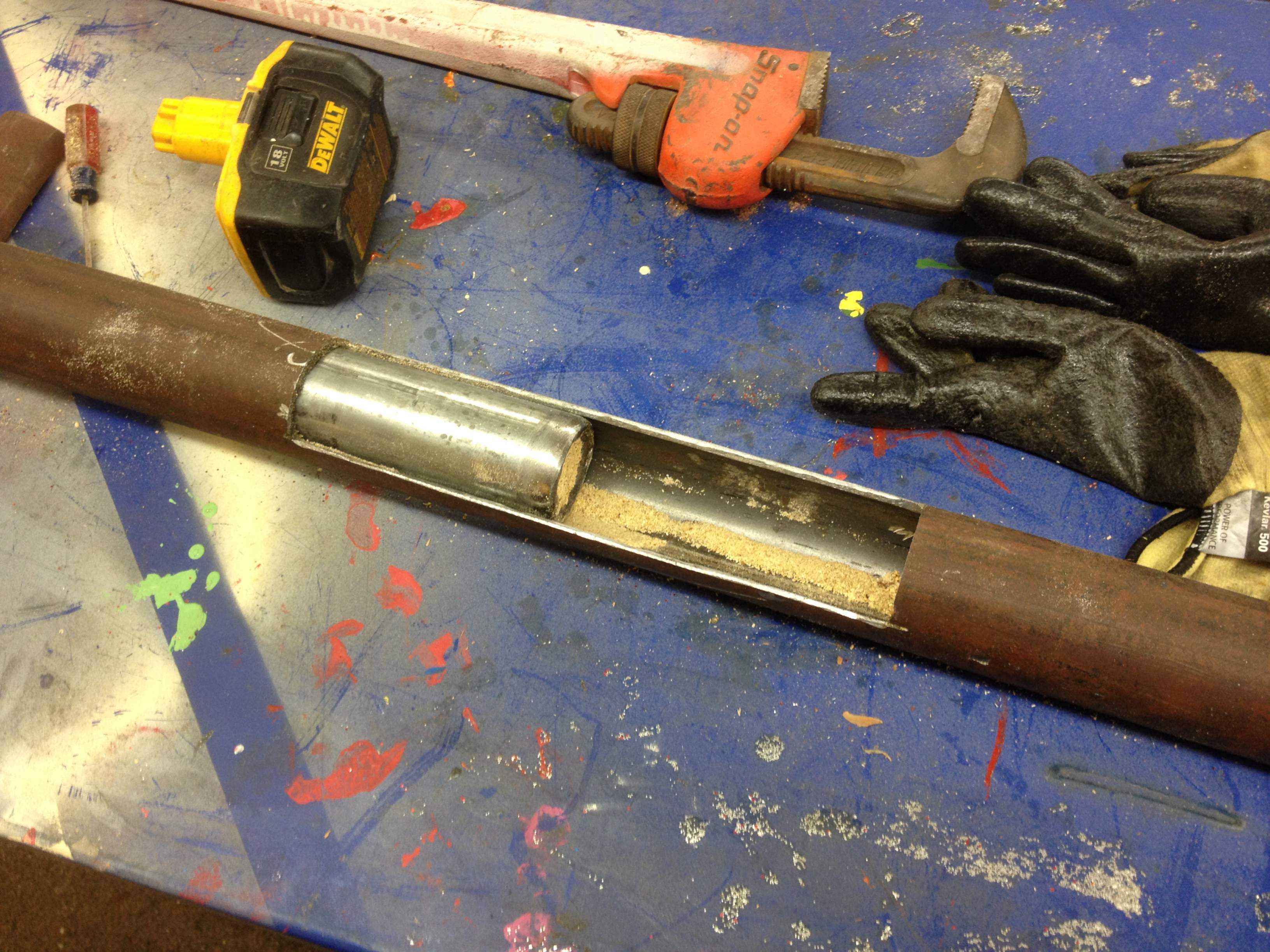

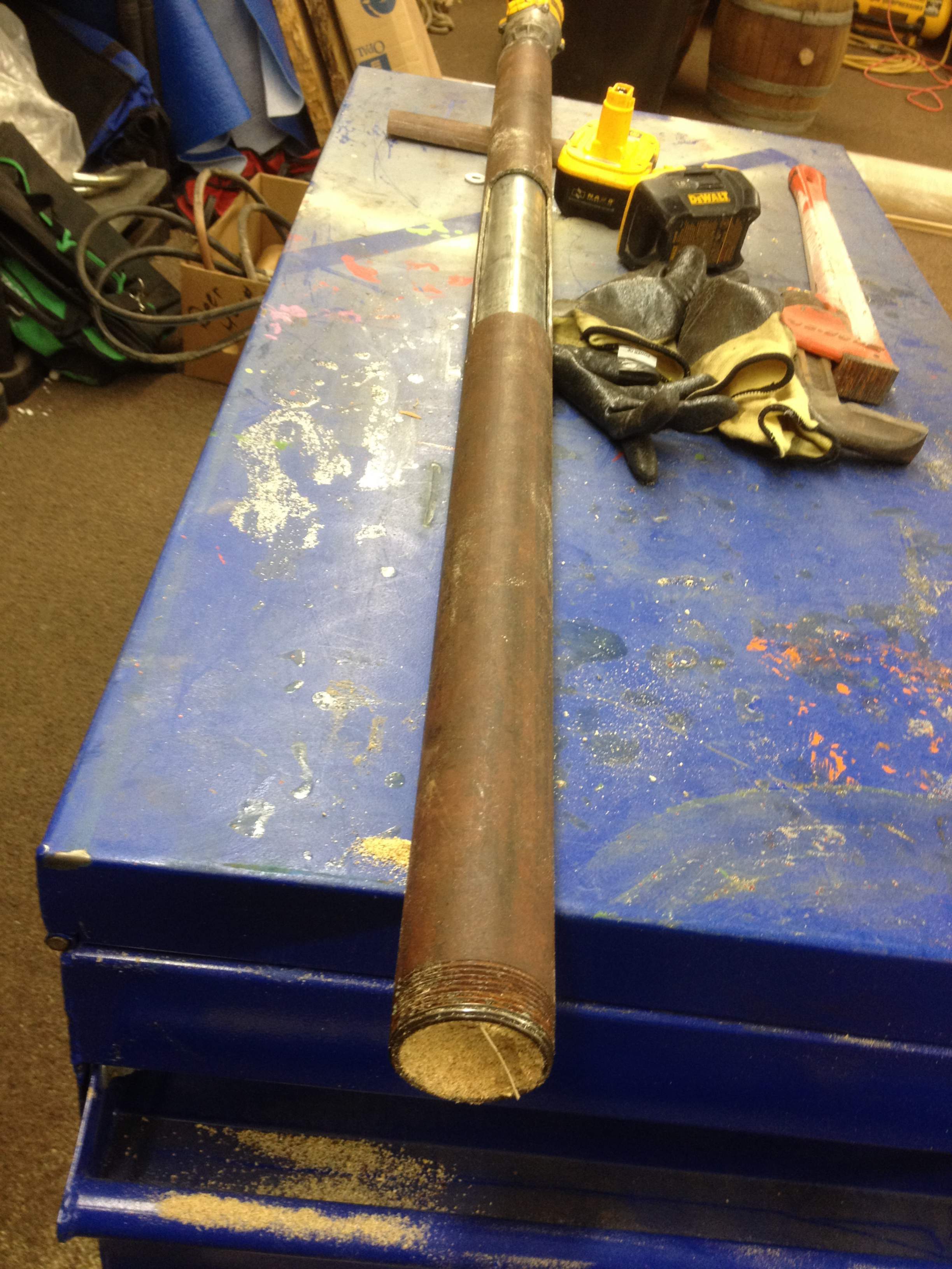

Well I had an idea to test some sawdust pressing with a damaged trailer jack laying in the junk pile (where I go for inspiration). IT was bent but I was able to salvage the guts out of it including the all thread. I tossed the housing and replaced it with a 4 ft piece of pipe with a threaded end and a 2"x1-1/4" reducer. Then cut a slot to add sawdust. I welded a 1/2" square female adapter to the end so I could operate it with an impact wrench. IT did press the sawdust but was not able to push it out with the reducer. Without the reducer it could barely push it out the end and the vibration from the impact wrench caused it to crumble as it exited. It was amazing to see how much sawdust it took to fill the pipe when it was compacted. Probably around 3 gallons of sawdust. What I gathered from the test was that more pressure and likely some heat will be needed to get the wood to bond properly and that a reducer may not be necessary at the end to further compress the biomass as long as the compression tube is long enough. I was amazed by how much resistance you could build with nothing on the end of the pipe. That was the biggest surprise. Adjusting the length of the exit tube is probably important for finding that sweet spot for resistance.
