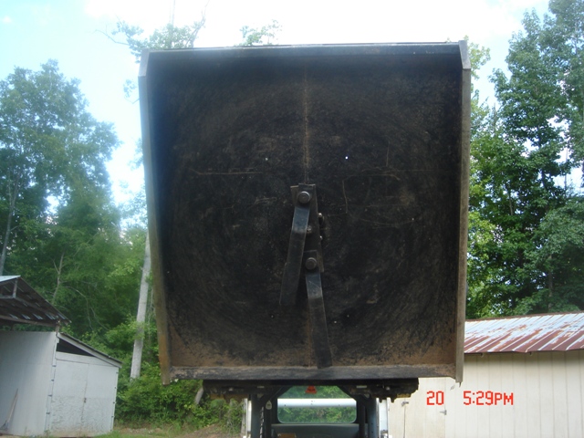

Good luck and keep them blades sharp. Don't let the bush hog people know that you sharpen blades. By the way, how about a picture of the underside. I would love to come across one of these real cheap. The blade housing can slide out and cover the blades or retract for some serious work.

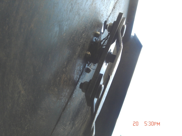

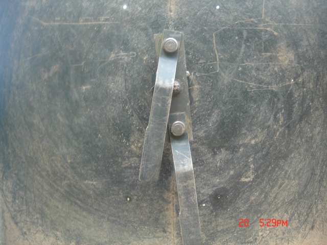

pics as promised.

That's good Mark , because a hydraulic slasher/brush hog on a skid steer without one or a case drain will dead head when you lift your foot off the pedal and will crack the motor case instantly . The inertia of the rotor will drive the motor and turn it into a pump , the oil has nowhere to go but out and that's why it has one fitted .
   / Hydraulic Brush Cutter Connections? #36
Isn't it interesting that there is no stump jumper on that cutter? That really surprises me.:confused:
