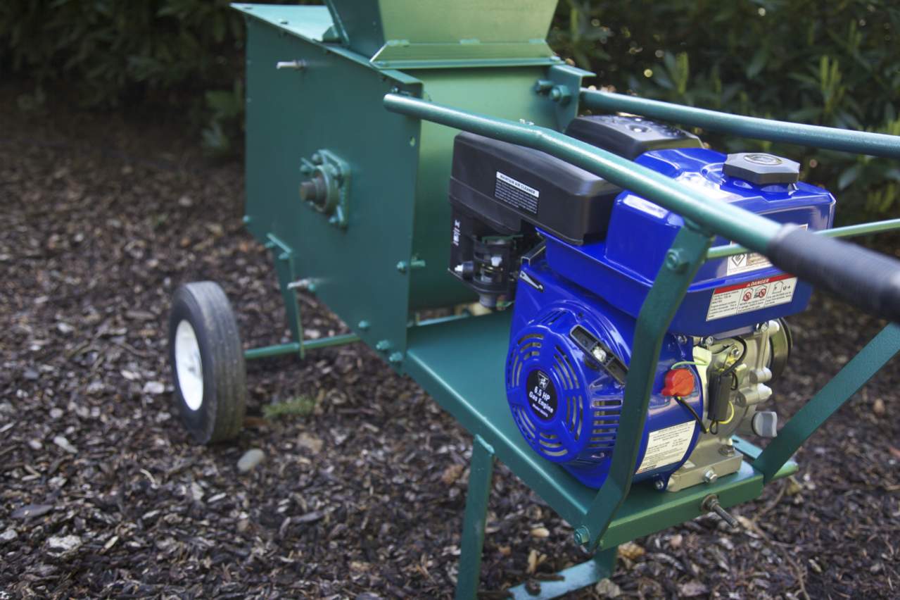

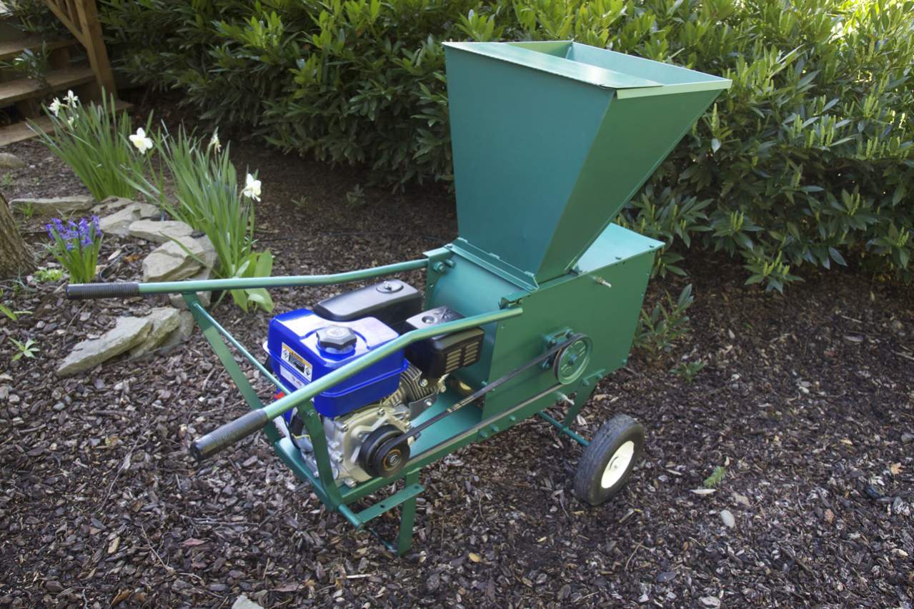

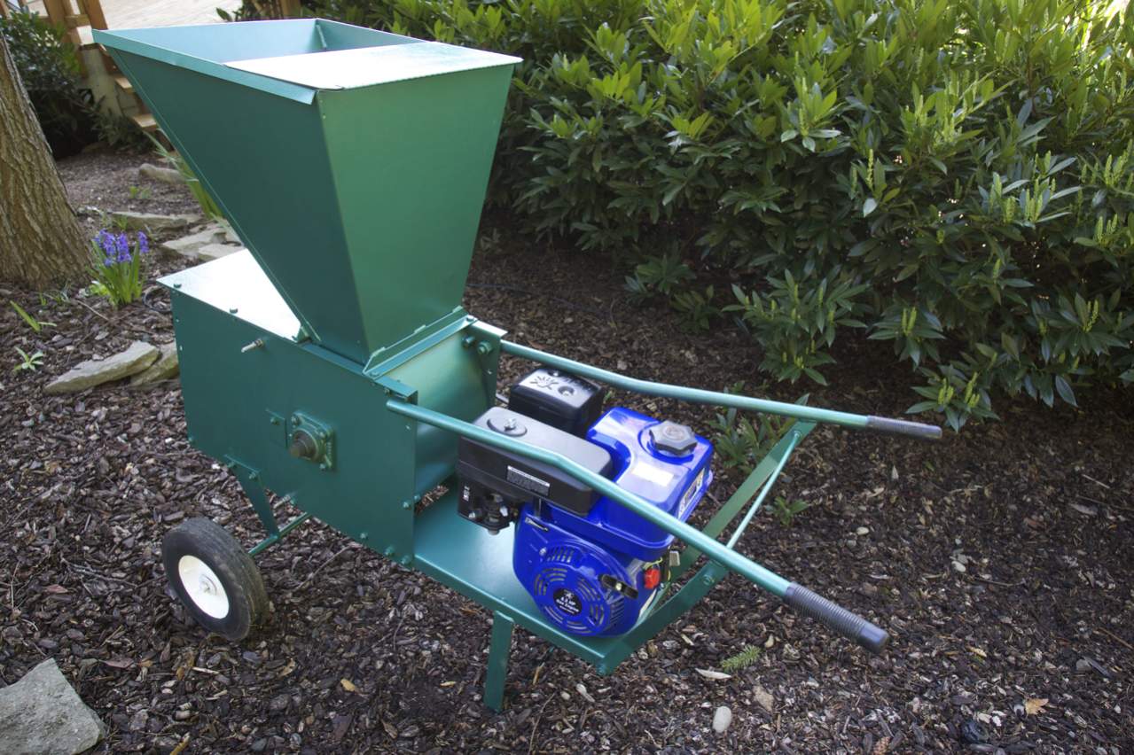

#46
UPDATE:
After solvent washing, wire-brushing, pressure washing, air-drying, and then painting the circa 1976-shredder, I was ready to re-power it.
After calculating out the costs of my hydro project, I happened upon a Harbor Freight flyer in the paper. Good grief, a cheapo Chinese 6.5HP engine for $99. Wow. That will be significantly less expensive than trying to convert this to hydro. *Sigh*
Well, I went ahead and picked up an engine, and here's what she looks like now...
I filled the engine with 30wt non-detergent oil, warmed her up, and 'broke her in' by shredding a bunch of brush and branches (some up to 1 3/4" thick!). Wow. It is simply unstoppable. Moss was right - it's like some kind of giant blender. The 6.5HP Chinese Clone engine, which appears to be a copy of a Honda GX200, starts easily, and is quite powerful. It is easy to start, runs quietly, and has a fair amount of torque. It has transformed this shredder into a beast!
I have found that this model of Hammer Mill Shredder-Grinder, MacKissic model 9PT, is designed to ingest virtually any kind of organic yard debris, up to and including mid-sized branches. It makes a racket, but doesn't really throw debris far or hard. It mostly captures stuff in the shredding chamber and beats the snot out of it using 24 swinging pieces of hardened bar stock.
It is very very tough. I don't think that anything short of a largish rock would stop this thing. I'll have to take a video.
Anyway, my hydro shredder project didn't end up as a hydro anything. Boo. At least I have a pretty decent shredder that is doing a good job clearing yard waste.
Thanks for all the kind replies and suggestions. I appreciate you guys.
-Rob :)

Hey, that looks real nice. Good to hear it is working for you. I like the third picture with the flowers the best. Looks like something out of Home & Garden. :D
