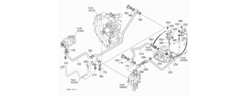

Does anyone know how the hydraulic circuit is supposed to be plumbed when using power beyond and third function on a Grand L (L6060HSTC)?
My backhoe keeps leaking at the valve block. When I purchased the tractor, the dealer told me over the phone they were working a problem waiting for the Kubota representative to help them. They mentioned when they hooked up the backhoe, that the loader stopped working, or something regarding the loader, backhoe, and third function not working when they installed all three. My first thought was oh crap, that's not good, because that typically means a fluid stop.
So, speaking with them last week after they worked on the backhoe valve block again to try to stop the leaks, I asked why it kept leaking and then told me it likely had to do with that event when they were installing everything. Given the block is still leaking when using the backhoe, I don't trust the plumbing on this thing anymore.
When I trace the lines, there are two ports on the top of the back hydraulic block, one on the left, one on the right. The one on the right seems to be the output that goes to the power beyond hose, which then goes through the backhoe to complete the circuit. After coming back from the backhoe (or if the backhoe is not there), the flow goes to another hose that is connected to the third function block on the middle right of the tractor. Out of the third function block it comes back to the back of the tractor and back to that left side port on the rear hydraulic block.
Now, those left and right ports seem to have a tee, and there are hard lines from them going up to the front hydraulic block. I'm not sure if this is the feed for the front hydraulic block, or if this is feed for it. Nonetheless, those two hard hoses go up to the front and appear to be in parallel with the power beyond.

I was looking at some parts diagrams over lunch.
My third-function kit is L2265 and the backhoe mount kit was BH4982. I can't find the BH4982 on Messick's parts diagrams, but they do have BH4983 which I assume is pretty similar.
The joint in my picture I thought was a tee, but it looks to be an elbow from what I can tell. That part # is 7K505-16910 and used for both the backhoe install kit and the third-function. So considering that is an ell and not a tee going into the block, then the backhoe and loader must be in series, and without a backhoe the loader and third function would be in series, so hence with all three they would all three be in a series like they are now. I'm still confused as to how they managed to have whatever issue they did during the initial install, but I can see how it happened when I can't find any diagrams of all three together.

I had a look at the parts diagram, flow goes as follows, pump>loader valve> SPACER(removed, now backhoe)>3pt
Your remotes bolt directly to the 3pt(rear block) so are after the backhoe.
In your picture you can see pipe fittings left and right of the 3pt where hoses have been attached, the spacer(070) has been removed, this is where they have broken in to run hoses to the backhoe I expect. Is the backhoe using QC valves?
Hey thanks for the diagram, I never looked at the oil line diagram to find those pipes. Also, sorry I missed your PM last night I had just went to sleep.
So this makes sense because they tell you not to use the rear remotes with the backhoe.
So basically I think I have:
1. Pump
2. Relief
3. Loader boom valve
4. Loader bucket valve
Out PB Port on front hydraulic block to right side of rear block into backhoe power beyond QC
5. Backhoe valve block
Return through backhoe power beyond QC but into third function hose tie in
6. Third function valve
Into left side of rear hydraulic block lines (where spacer is removed for PB addition) and into rear hydraulic block
7. Auxiliary remote valves
8. 3-point lift
9. Return to tank
It looks like in the diagrams there is another relief (not the cylinder safety valve) in between the auxiliary remotes and the 3-point lift position. The symbol is on the diagram, but it's not mentioned on the key. Maybe that is the same relief that is on the front block, because that would probably make more sense considering I don't see it in a parts diagram and never heard of one back here.

I did some more quick reading over my lunch and reviewed my videos I had taken of the hoses last night.
Bottom line is, the circuit is currently setup loader, backhoe, third function, aux/3pt. So the third function valve is after the backhoe.
Everything I have seen on these forums seems to indicate the third function should be before the backhoe. This seems to make sense otherwise when the valve is actuated the pressure is going to go back on the backhoe block and not directly to the relief at the loader block.
I don't know if this is what is causing the leaks on the backhoe block, because it was leaking when it came back from the dealer even before I used the third function. However, it probably isn't helping anything.
