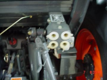

Another picture, this shows the linkage coming off the hydraulic valve that's mounted to the side of the transmission. You'd need little fingers to get in there without removing at least the wheel.

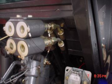

Another picture; This is the valve block, with female couplers. As I stated earlier, they are Pioneer style, push, pull. See how the bracket mounts to the tractor even though yours may be different. Also, note the hose routing and how tight the hoses are in relationship to the tractor itself. All the kits I have ever seen come with pre-cut hoses with ends attached.

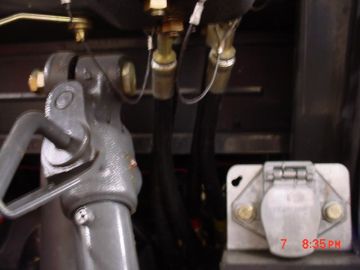

Another picture; This is another view of the hose routing. As you have a much smaller tractor than I, the hose routing will be more cramped.

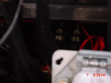

This is the final picture, looking down from the top of the connector block.

Thanks for the pics. After reordering the correct kit which should have the hoses included, I am looking forward to installing it. The pictures you sent will help. I had beening thinking the control would be mounted up front, but I can see now it will proably be back behind the seat. As pcmem says, it will likley mount on the ROPS.
