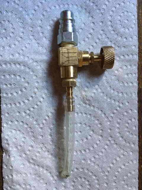

I made a couple of these up from some cheap parts on Amazon. Plug them into the loader when I remove it and allows me to bleed off pressure increase from temperature changes and easily reconnect them
