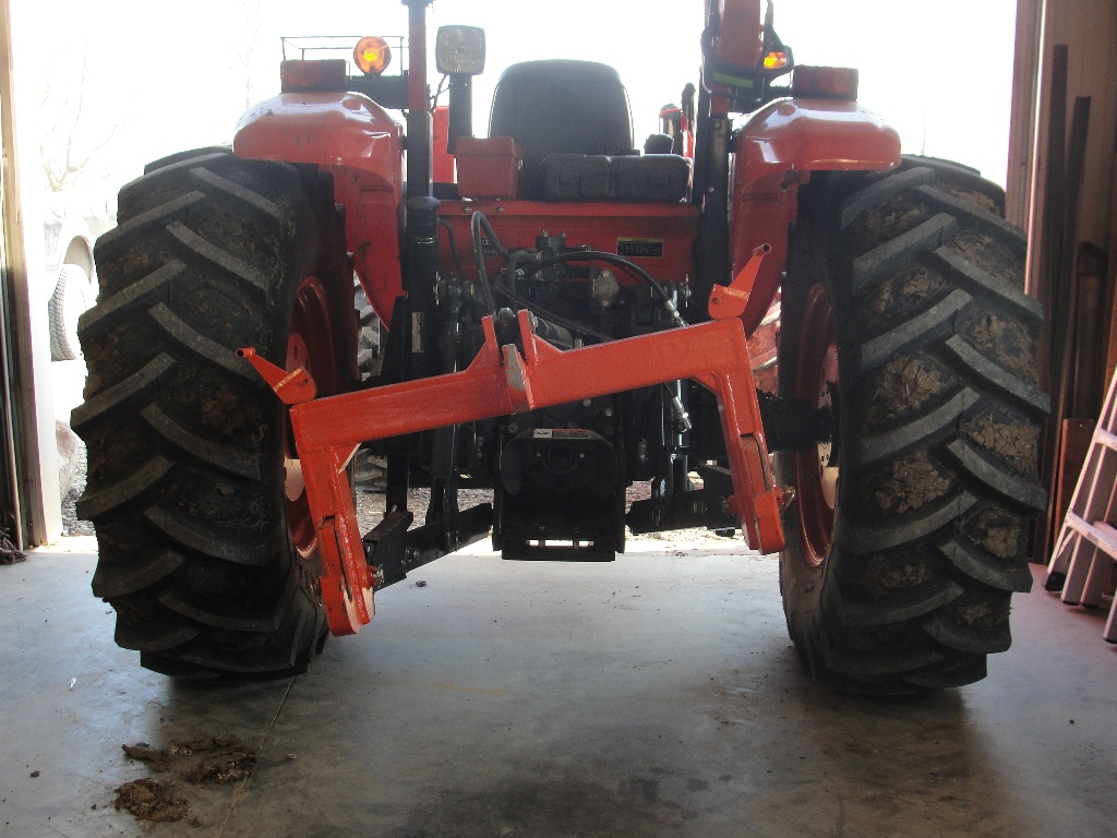

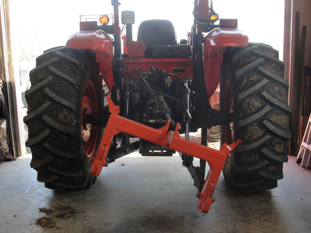

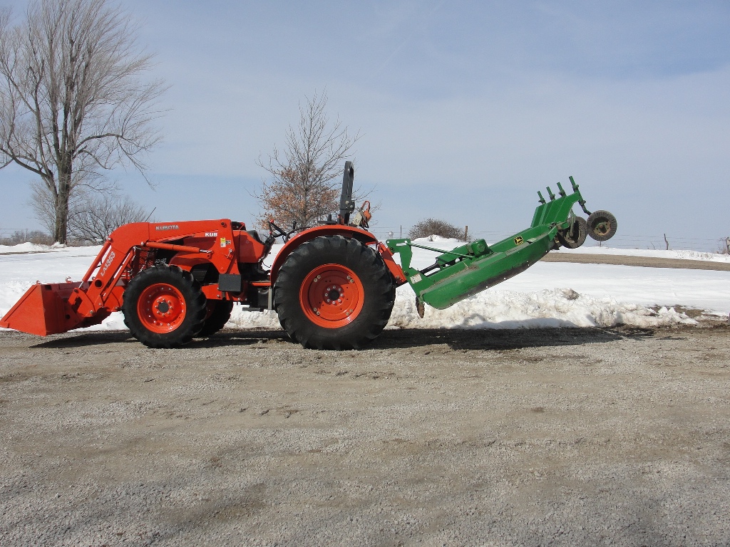

I've done a dozen or so modifications to my M9540. One of my favorite, right behind the cooler holder, is TnT. All accomplished with finger action on 2 very handy levers. See pics. :)
That looks pretty cool I must admit. That would greatly ease attaching the backhoe. Sadly, I'll need to wait until I find some gold or some other windfall comes my way. I do not want to add any more hydraulics to my small machine. Perhaps I'll invent an electric alternative? My link levelers (OEM) are pretty worn out anyway. Sounds like a project for the new TIG welder, maybe. Now my neighbor with the 50hp NH could really use a setup like that to ease his implement change hassles if for nothing else. But he is talking about trading in for an air conditioned cab. The guy goes through tractors like I go through jeans. :)
