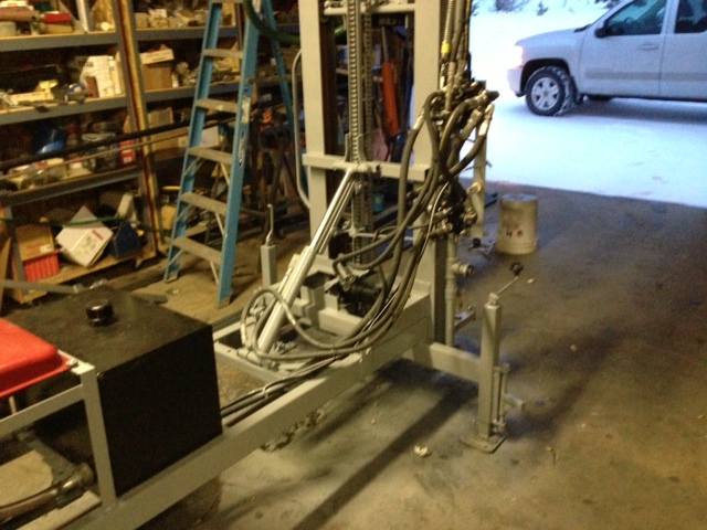

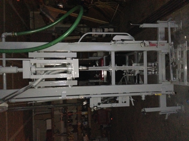

I will try these pics for you. You may understand my issues?

Very nice machine.
Is the problem only when the boom is all the way down. Will the boom lift if someone helps it by hand. I can't see the cylinder geometry when it's down from the photos. You could take the hose off the pressure end of the cylinder, put it in a clean container and see if the oil flows smoothly from the hose. If it does then the valve is ok.
I suspect you don't have enough lifting force, but can't tell from the photos. If you built that machine you know what you're doing.
   / Hydraulic cylinder jerky #13
how many valves are you using, and how are they plumbed in,
if using multiple valves are you using a power beyond port to feed it or a return line, off of another valve?
i can not see the hose configuration clear enough to make out what you have,
I see no issuers with the mast,
how does the mast lift with out the cylinder? with a chain hoist or other? is it smooth and not binding in some way?
my guess is it is an open system on the hydraulics, are all valves for the same type of system?
I do not think air in the system would cause the problem stall problem, are all other functions working the way they should, (guessing hydraulic motor, and a cylinder to lift and lower the head)
my guess is it is either in the valve faulty or wrong type of internal construction, (and the valve should have a relief valve in it so the engine should not stall, and the valve should be able to throttle the flow of hydraulic fluid some, with locking up), or a plumbing problem of how some thing is routed or plumbed If other parts are working OK and the only circuit is the mast lift, I would think that is where the problem would be found, if the rod on the cylinder is not bent or have some kind of internal flow circuits, my guess is it is not the cylinder,
may be draw out the system on paper and show how it is plumbed, show all hoses and valves and there conections,

You said you have installed a log splitter valve, maybe you crossed the hoses so the fast retract function on a log splitter is now on the lift side of the cylinder?
Just a thought.

Here is what I have figured so far:
The pump supply goes to the first two spool valve set the has a 1500 psi setting.
This set runs one head motor that gives little back pressure unless under huge loads, not too likely.
The second spool runs the chain hoist motor that has so much torque that even with my 200 pound friend staining on the head, the motor did not even breath hard to lift and little pressure build up.
From this valve I placed a power beyond port to the second valve that is a log splitter type set for now at 1500 psi.
Here is where the issue begins. The ram takes very little oil and does not need 1500 psi but now gets that. The rest of the flow goes to the relief valve and has to make it through the 1500 psi setting:(.
This causes two issues,,,,1. Heavy uncontrolled jerking of the mast due to the psi and fill speed and 2. The huge bulk of the flow when this valve is triggered has to go through the relief valve facing 1500 psi in a sudden shock thus stalling the engine:(.
My current lowest cost fix is:
1. Place a needle valve in the large ram end line slowing the fill to a crawl.
2. Replace the relief cart rage with a 500-1500 psi setting it at the low end if this range in hopes of this not stalling the engine?
More input on these ideas is welcome.
