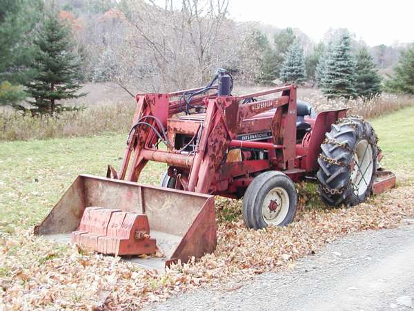

Well sort of. I had occasion the other day to move the weight bar you see in the bucket of the 484. I've been wondering how much it weighs. There are 16 weights on it. Anyone know what those weights weigh? The forks would just barely lift it at ground level but would raise it ok once it was up a bit. It caused a nice case of PT pucker too, just about the same a fully loaded small bucket of wet dirt! So I'd say whatever that bar weighs plus the weight of the forks is close to the limit of what my 1845 will lift. It's rated at 1200 lbs. Assuming those are 100lb weights, I was lifting close to 2000 lbs, if you include the forks.
