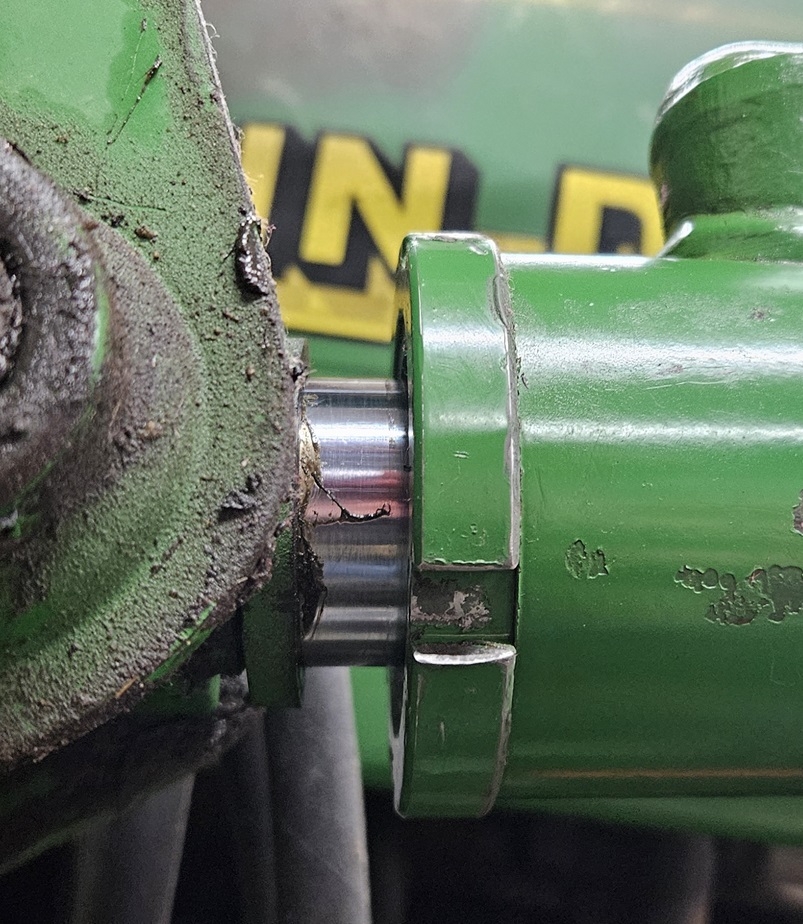

Got the first cylinder back together last night. No issues running the loader and no drips from the seals overnight. I'll run it outside for a while today to get the hydraulic fluid nice and warm and run it just to make sure everything is good. I'll tackle the second if everything goes right with the first.

So far, so good.

I got the other cylinder fixed a couple of weeks ago. It was much faster since I knew a little more of what I was doing. So far, they seem good.
