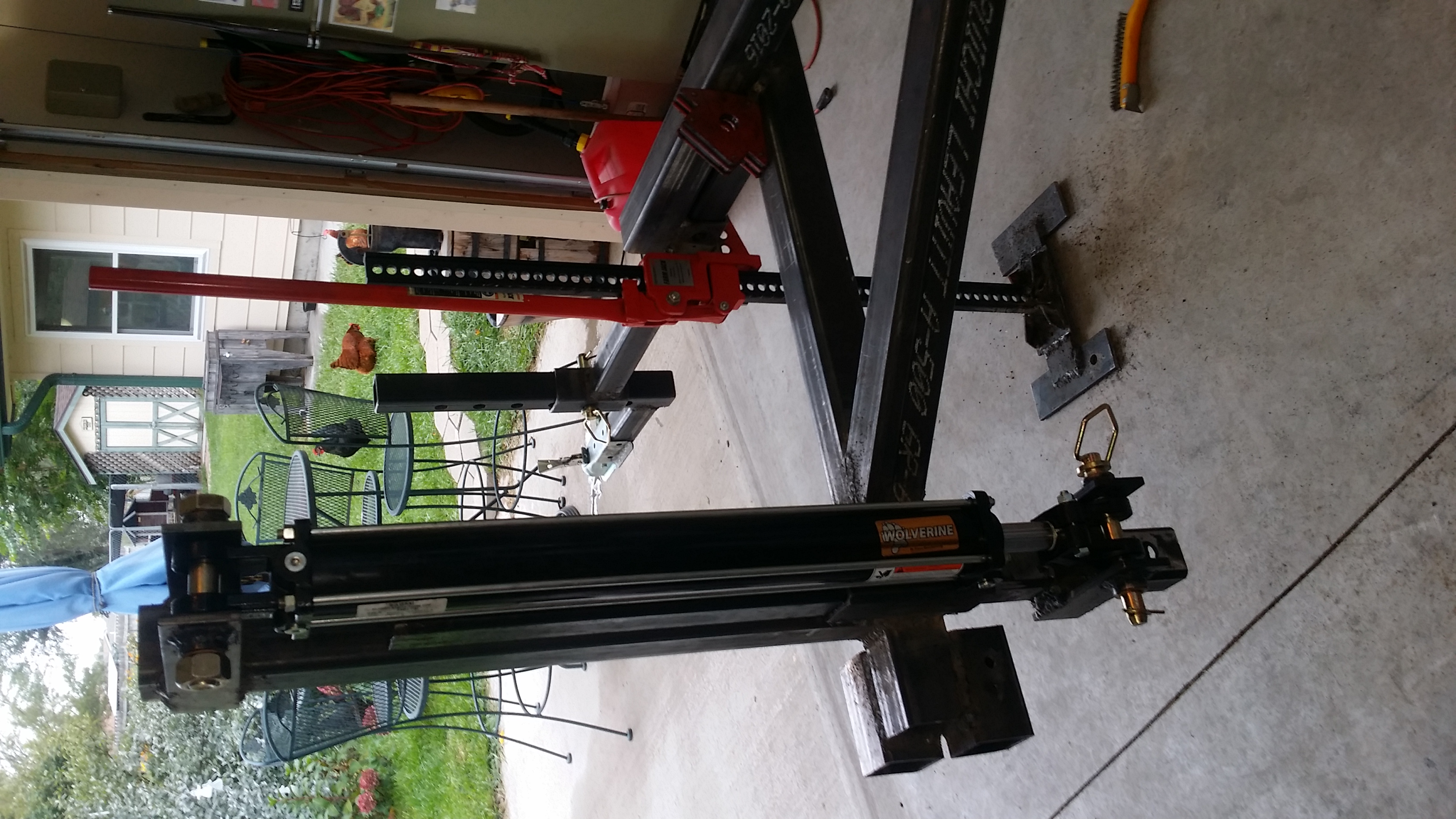

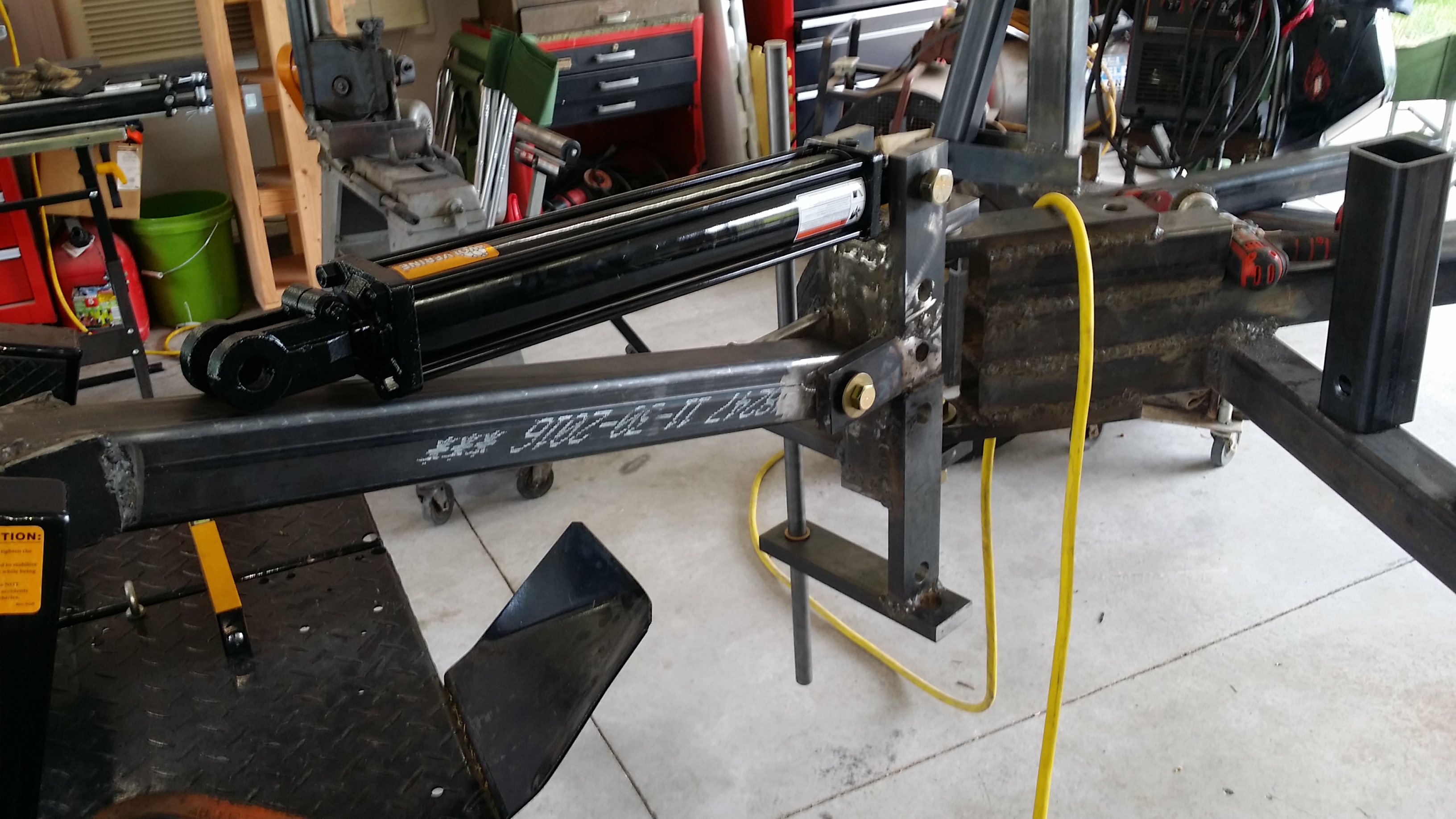

#14
A few pics

Good afternoon: I am building a towable backhoe (I will post some pics) and am getting to the point I need to begin the attachment of hydraulic cylinders as well as motor, tank etc.... Most of the fab and welding (other than cylinder mounts, valves mounts, etc) including frame, boom, pivot, outriggers, wheels and tires is done.
I have attached the hydraulic design for your review and thoughts. I have already ordered and received the 4 outrigger cylinders as I want to weld the rear outriggers prior to the installation on the frame (they run straight down). The front outriggers are already on the frame.
One thing that has me puzzled is the source and return line sizes for the tank. I am looking at a 15 gallon tank online and the openings are 2 inch 1 1/2 inch and 3/4 inch NPT. I am not sure what size line to use to run to the gear pump and also the return lines. I would like to use 2 wire JIC hose. I am also not sure where to get fittings to move from these size NPT to smaller JIC and SAE.
Any constructive help would be appreciated.
