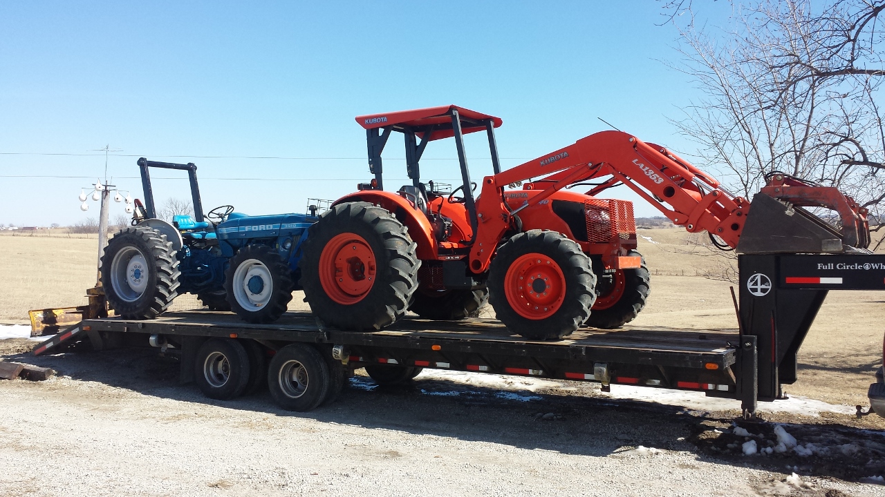

Here's an example of the ramp problem I was referring to.
   / Hydraulic dovetail trailer questions #22
No flame here. The flipping part doesn't concern me. My comments are pointed at useable trailer space. What would you do with your ramps in this situation?
My ramps flip over and fold flat for deck space. I would drive both tractors all the way forward, flip the ramps, and then back things up into the proper position. From the pic it looks like there is plenty of room to do that.

If I had to make that work I would do what bdog said or remove the rear blade and put it in front of the kubota. Hydraulic dove would be perfect there though. My ramps have the support brace built onto them so they don't leave a flat deck. Really a pain but better than the other option of loading off an unsupportive trailer and torque the frame and rear axle.
