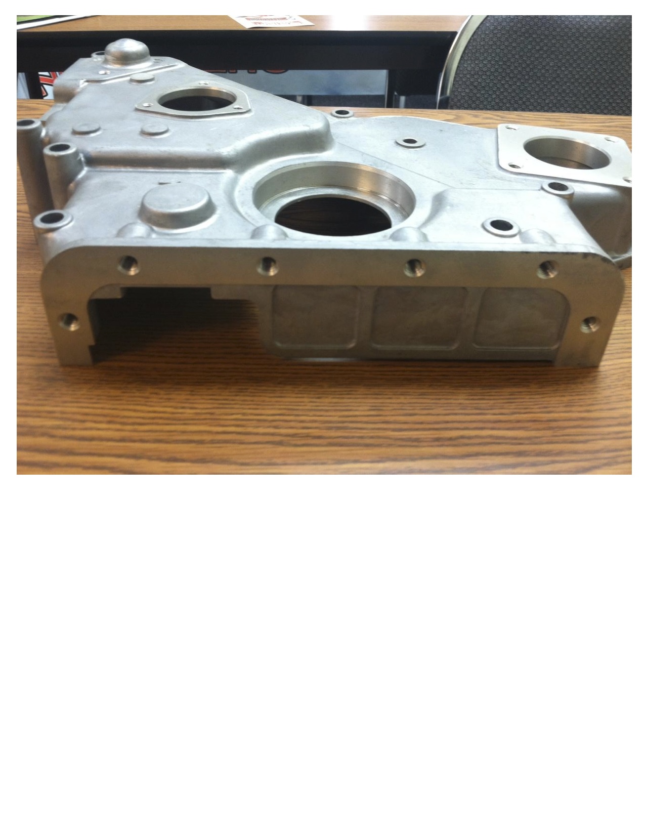

Hi guys!
New to this page, but I have a Branson 2810 with hydraulic gear failure, both power steering and bucket. Question: How many bolts are on the gear case? I've removed all the face bolts and one from each underside, but seem to remember some hidden ones. I don't want to break or pry the case. Any help is greatly appreciated.

Have the manual, no indication in it of where the bolts are. I took the bottom oil plate off to check, but no go.

Thanks for all the help guys! I did get this response from the good folks at Branson regarding the "hidden" gear case bolts (hidden to me because I'm not a mechanic!!)
"Rex,
Please find attached file. It is pictures of the 2810 gear case. For the gear case to come off you have to remove the oil pan. If you have any further questions jus let us know.- Aaron"
I've attached the picture they sent me. Hope this helps anyone in the future changing the hydraulic pumps and gear bearings!
