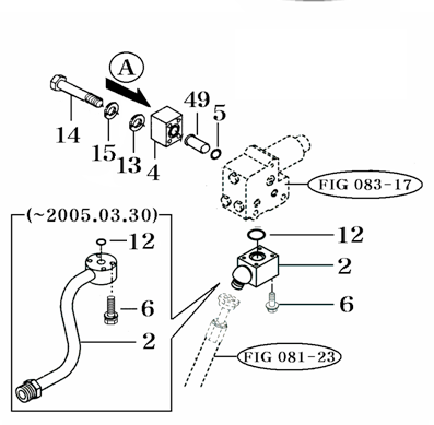

There is a second filter in the diagram for the PTO, just a 80 mesh screen (# 49 in the pic) Is that the one?
I haven't seen that NAPA #1621 listed, but looking at it on napaonline, it looks very close. Keep us posted.
Yes, the cross reference (I didn't put the list together) is for the long can filter.

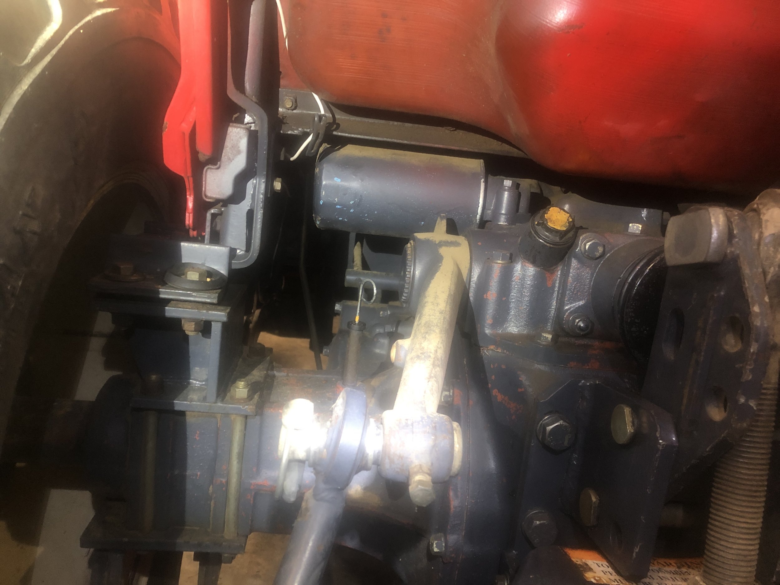

I’ve got an 02 3510 that has that filter on top of the transmission. Best I can tell it is a 15645153410 that is a left over from the old sheetmetal tractors. Billstractor says it would be on top left of transmission. Just when I thought I had changed all the filters I found your post and checked my tractor.
Next question, what fluid flow does it filter since there is another screw on filter under the floor on right side?

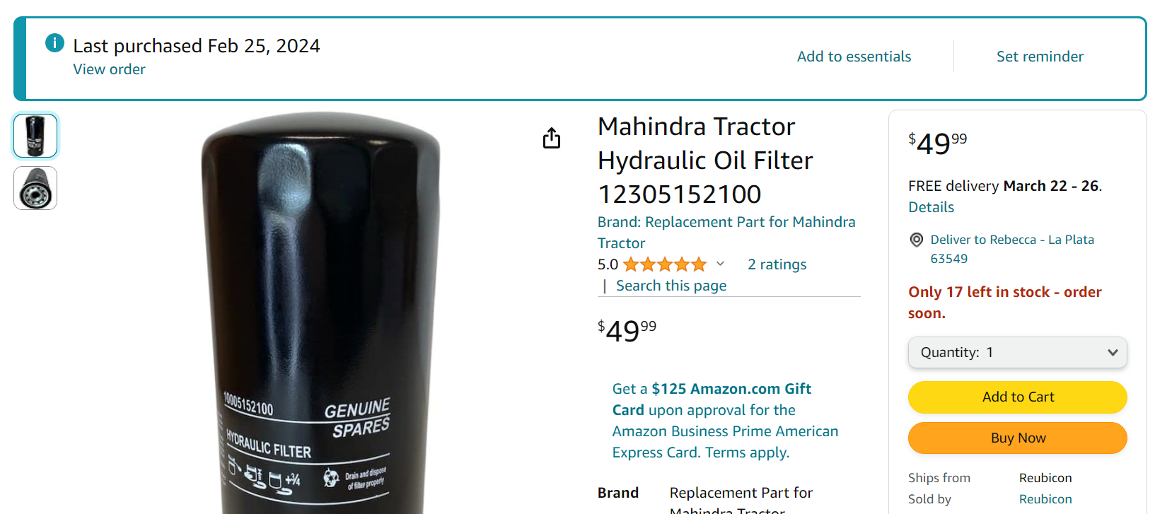

My 02 mahindra 3510 uses the suction style filter Mounted low in front of right rear wheel. I could only find Mahindra brand online.
Was 50 dollars on Amazon
My filter wrenches wouldn't fit it so I put a radiator hose clamp around it and was able to turn it off pushing mainly against the worm gear housing with a slip joint plier.
