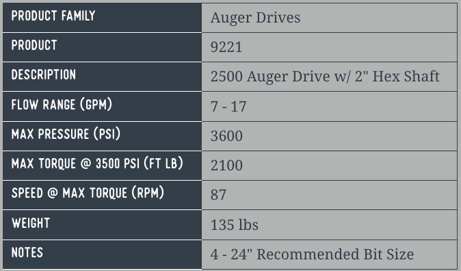

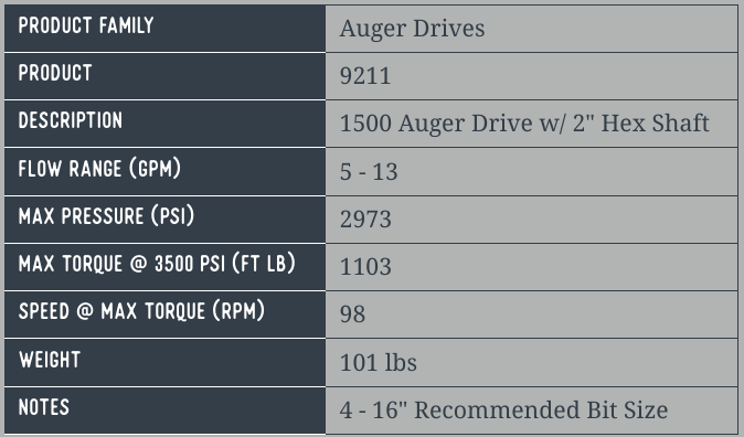

More flow will allow it to flow faster, but any flow at all will turn it at full torque minus momentum.
Is that a 100% true statement?
If so, I might take a pump requiring a little more GPM to get a torque increase.
Although, this is kind of a weird comparison, because they show torque at 3500psi, and one is higher than the max limit, and my tractor has about a 2500 psi limit anyway ....
I'd have to ask them for comparison numbers at the same ~2500psi unless that psi number is something different than the tractor hydraulic system psi.
