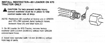

How do I know the one posted "wont work"...well, its only rated to 2k PSI.. Spec sheet from Deere on the 4120 show the hydraulics being rated to 2500 psi...could you use it...yeah, probably...as for the size, well, 1/8" NPT isnt a common hose size. getting a 1/4" NPT hose assembly is cheap & easy.

TSC has a 3/8" pipe thread (NPT) fitting with built in restrictor. I use them frequently. They cost around $5. Hydraulic fitting retailers will also have them. I use them frequently on cylinders, hydraulic side links ect. If it is too restrictive, (but I don't think it will be), you can drill out the tiny orifice slightly bigger.
