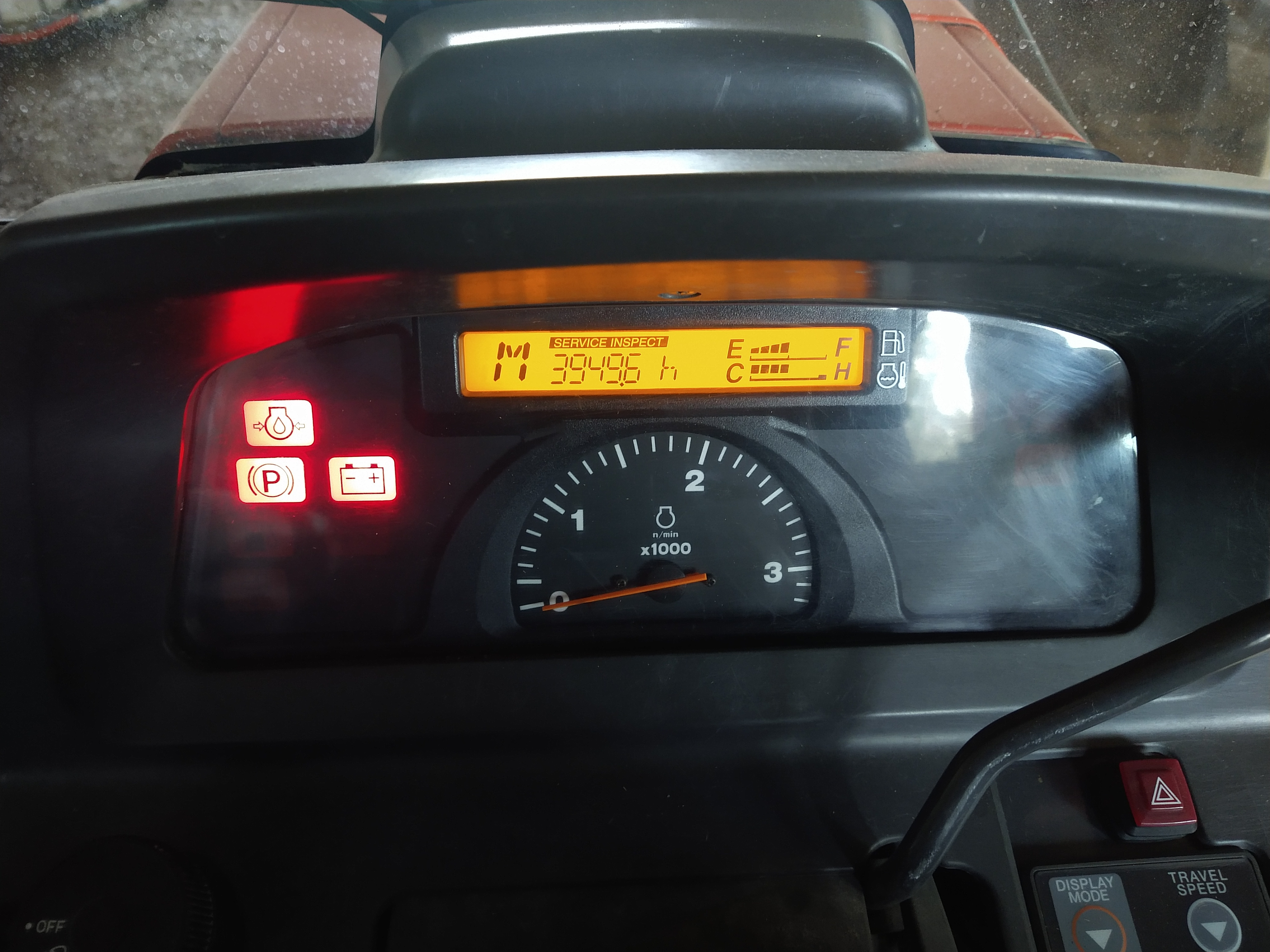

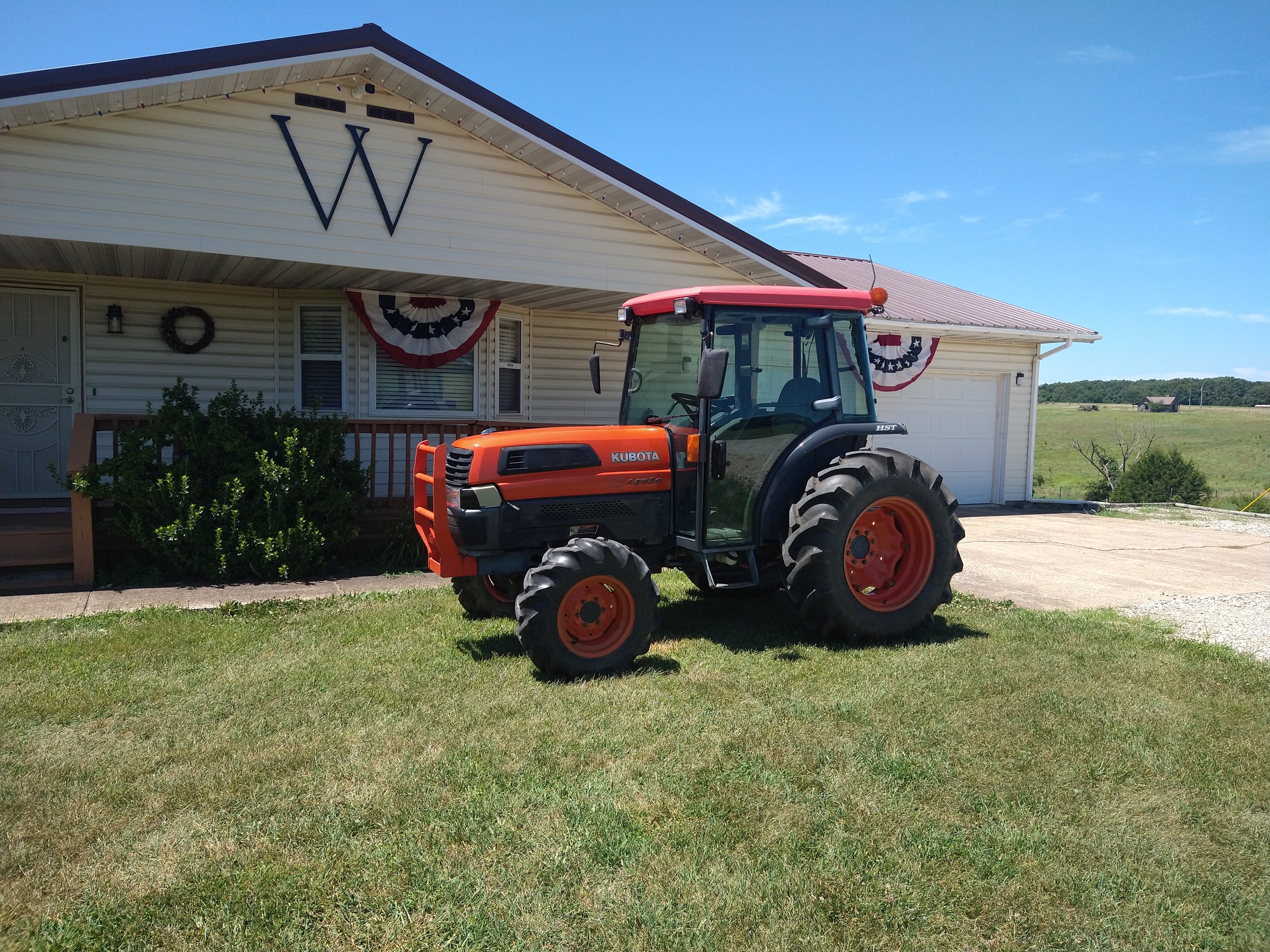

I have the same tractor, other than I'm not sure if his has a cab like mine ... I'd not take a chance on non-oem ... While my own 20 year old tractor is long past any chance of warranty ... I bought it to use, not rebuild it because of premature wear ... These are quality built machines that require particular maintenance to ensure longevity.

4000 hours is a fair amount of hours for the average owner here on TBN. My 10 year old L4060 only has around 1200 hours, but the plan is for this to last many more years.
