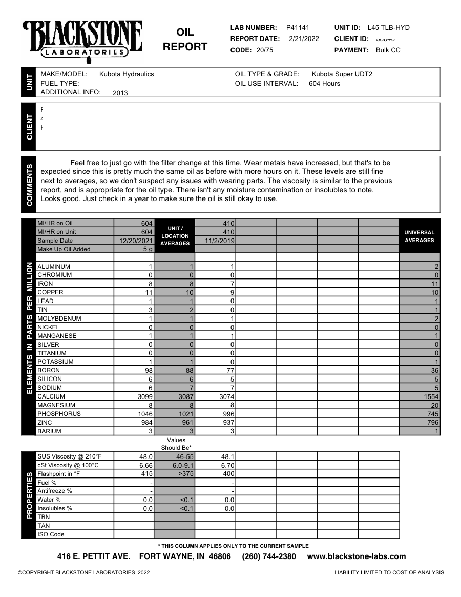

I just sent a sample of hydraulic oil for testing. It looks milky in the sight glass, and I think there might be water in it from the previous owner's use. I have always used Blackstone labs in Indiana, and just noted that it's hydraulic oil. I don't have the report back yet, but will let you know when I do.
