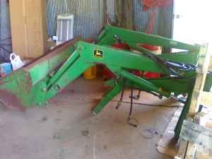

Here's a video of what I have. The bucket and hydraulic assembly has to be removed. John Deere 8 Front End Loader for Tractors - YouTube
Why would the hydraulic assembly need to be removed?

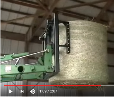

And a video of the type of attachment (but with spears) that I'm looking for. W R Long Round Bale Mover - YouTube
Appreciate you guys, tho.

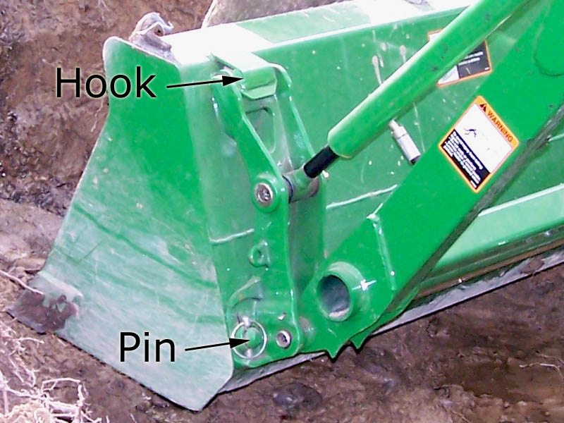

That type of attachment is a John Deere Hook and pin attachment system:

So you want to remove this:
And build something lighter that will do the same thing with your bale spear?

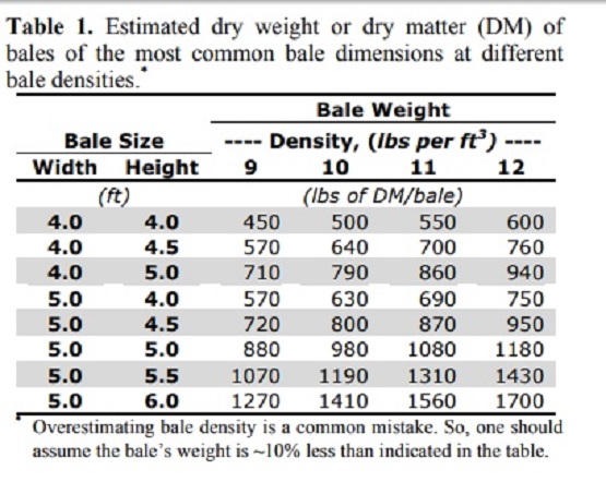

What size bales and how heavy?
This looks like my model 80 bucket assembly. If it is then, yes.
4x5 & 5x6 bales. Guessing 600-800 lbs?
Sounds about right for 4x5. 5x6 are a lot heavier:

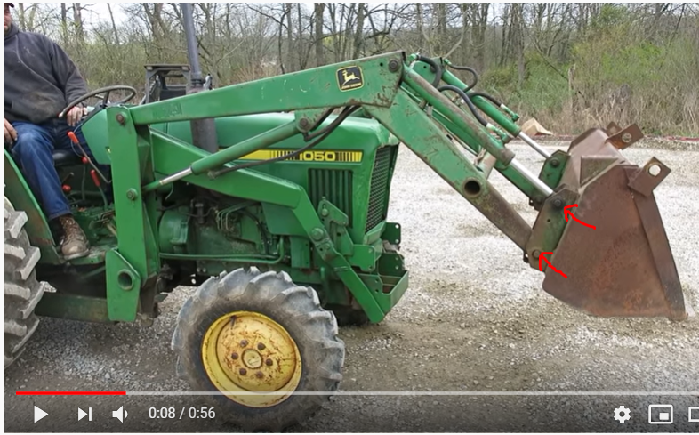

The model 80 bucket doesn't easily disconnect from the arms. No hook & pin. I've attached a link of a model like mine.
Your bucket is the old standard "Pin On" type. It can be converted to a Quick Attach type, there are several threads here on TBN showing how to do it.
From your link:
   / Hydraulic Hay Spear Attachment for John Deere 870
#17
   / Hydraulic Hay Spear Attachment for John Deere 870 #18
I love my SSQA. But they do reduce lift capacity a bit & push the bucket (or whatever) out a bit. That is likely to be problematic if you are already close to capacity. Starting price will be a fair bit north of $500 for an adapter. Maybe a bit for SSQA parts if you can weld up your own. Either way you'll still need to weld & probably cut on the bucket.
