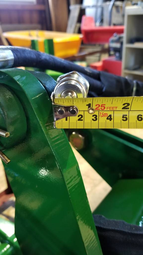

I ordered a Titan Attachments Grapple (after calling their Customer Service to verify which model grapple would fit my JD4410 tractor with 430 loader). After I unpacked the shipping crate I looked at the hydraulic quick connects. Not even close to the same size!
I called them and they told me to go to a hydraulic shop and buy new hoses! That would run $200!!! Actually a very poor response from them, but they did say I could return it at no costs.
Before I escalate with Titan CS or return it, does the brain trust of TBN have any suggestions?
Grapple:
Tractor:

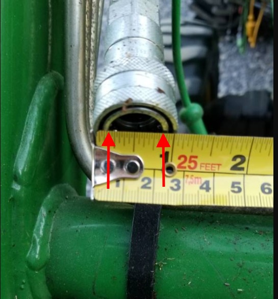

Might be my eyes but they look correct. It appears that you have measured the outside of the male end and the outside of the female end.
   / Hydraulic hook ups to Titan Attachments Grapple
Grapple male
Tractor female
   / Hydraulic hook ups to Titan Attachments Grapple #9
The grapple male goes in between the red arrows. will it even start to go in?

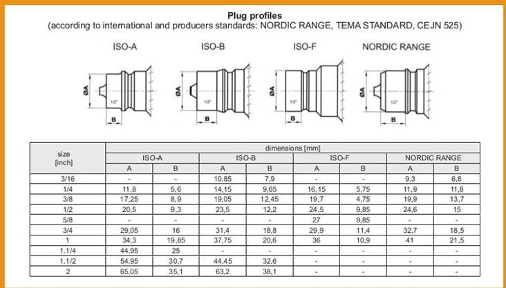

It looks like you have a 3/8" ISO-B coupling but you need to confirm the distance from the face of the coupling to the edge of the ridge as shown in the pic of the different styles I attached. I bought mine on eBay. They're also known as ISO-7241 couplings. If you have 3/8" couplings then they are most likely the ISO-7241 as 3/8" AG style couplings are not very common. Ag style couplings are ISO-5675 or ISO-A in the picture. (note the measurements in the chart are metric but it looks like you're at just over 3/4" which is closest to the 19.05mm measurement).
I bought two sets which is what this link is for since I needed them for my plow and a future grapple purchase. I'm sure you can find a single set to order if that's all you need.
