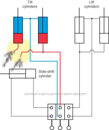

Here is a quick diagram I found, just look at the right side marked lift cylinders to see how to connect them.
   / Hydraulic hookup on bush hog
#12
I put the tee in and when I lift the wings it will raise one wing and when it gets all the way up then the other,I assume this is the way it should do. I also have another question about the cylinder that raises the bushog up and down, when gets all the way up it squirts fluid out a bolt with a small hole in the side of the head of it and it only does it when it all the way up, does anyone know how to correct it?
   / Hydraulic hookup on bush hog #13
Dmaxx, the operation of your wings sounds normal since the cylinders are plumbed in parallel. It sounds like the internal seals on your lift cylinder is leaking by a little.
#14
How do I fix this or do I need to replace the cylinder.
