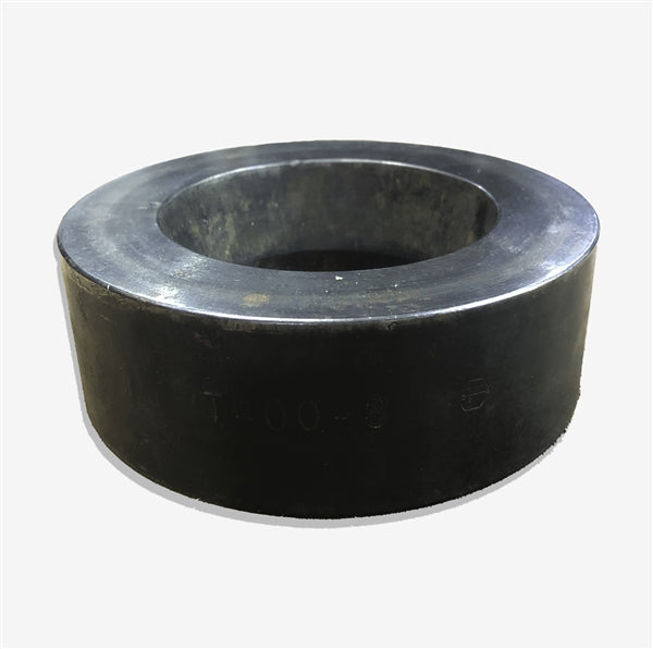

I have an old Weatherhead T 450 crimper I've had for many years. I never got the (optional) hand pump they came with, but instead I have an air over hydraulic pump that operates it just fine, and plenty fast enough for me. I doubt I would part with it as long as I'm still "in the game" and need to make a hose now and then for whatever reason. If I were in the market to replace it, (or start over looking to) I would seriously consider the option of just making the bulk of the parts considering the prices listed for them and using a shop press for the power. Other than the dies, there's nothing to it that any half qualified machinist can't turn out. I also have the bowl (T 400-8) for using the shop press, and use it for crimping 3/4" hose ends since the T 450 struggles with that size. The dies would be the major expense I think. The rest could be made at a reasonable cost.
