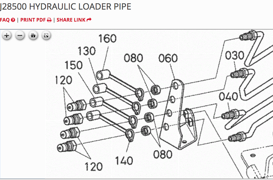

I just noticed a leak on the floor. I thought it was just from taking the hoses on and off. I wiped everything down best i could and revved it up to 2000 rpm's. I can see the blue male end leaking from the center pin piece. Is this something I can order and simply screw on and off myself or should I have the shop do it? It's still under warranty. I wonder if it has anything to do with the hydraulic cylinder breaking a few days ago, when I turned the blade to the left and it popped. Is left blue?

If those QDs were connected when things popped those sealing surfaces would be not touching at all. It could be a result of the repairs if you got any pipe tape, dope or other grit in there. It would prevent the poppet in the QD from sealing properly if it got lodged in the wrong spot. As likely to be a cheap or defective QD though. They are $30 or so to replace, but your dealer should take care of things under warranty.

Revving the engine up should have no effect on that QD leaking, unless the control valve is leaking a LOT. Maybe the extra vibrations or something, but there should be no real pressure on that QD unless you as actuate the valve.
Even if it costs me a few dollars, it's much easier to do it myself. The dealer is 35 miles away and usually busy and it will take days if not weeks to get my tractor back. I try to avoid them unless its something major.
I found the QD nipple on the messicks website I like to use for parts. I navigated and found that the part number, 7J612-66222, was replaced by 7J612-66223, which in turn is now replaced by K2581-66220. Luckily it's only $8 down from $24. The parts staff didn't know why it was replaced. I was worried it was a defective part. Guy said it happens, different manufacturer, whatever.
I hope it's just a piece of foreign matter or something that just got stuck preventing the poppet from reseating. I've never done any other hose repairs, so it can't be something I've done. Maybe it's from a piece of tape that got in the system from whoever assembled it to begin with. I'm hoping it's just a defective nipple and should be a relatively easy fix.
When the tractor is running the nipple leaks, and continues to do so unless I shut the machine down. When I revved it up maybe you're right and it's the vibrations causing it to seem to leak more. If what you say is true then it shouldn't leak period unless I actuate the valve? I wonder if there is another mechanism besides the nipple that could be faulty?
