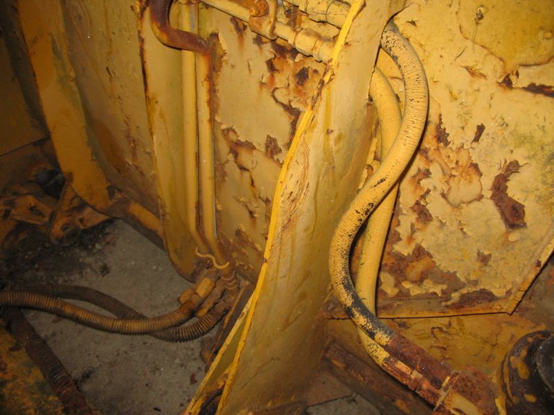

Hydraulic hoses should last a lifetime if not abused. I have a 42 year old dozer that still has the original 1/2" 2-wire hoses on the 4in1 clam bucket. They have probably been abused but the outside is just cracked.
If you are worried about breaking a hose out in the boonies then purchase a male and female set of reusable fittings. All you have to do is cut the hose at the failure and put a male fitting on one end and a female on the other end and fasten them together. No need for crimping. This repair will get you back home or to a dealer. These fittings for 3/8" hoses run about $7 each.
