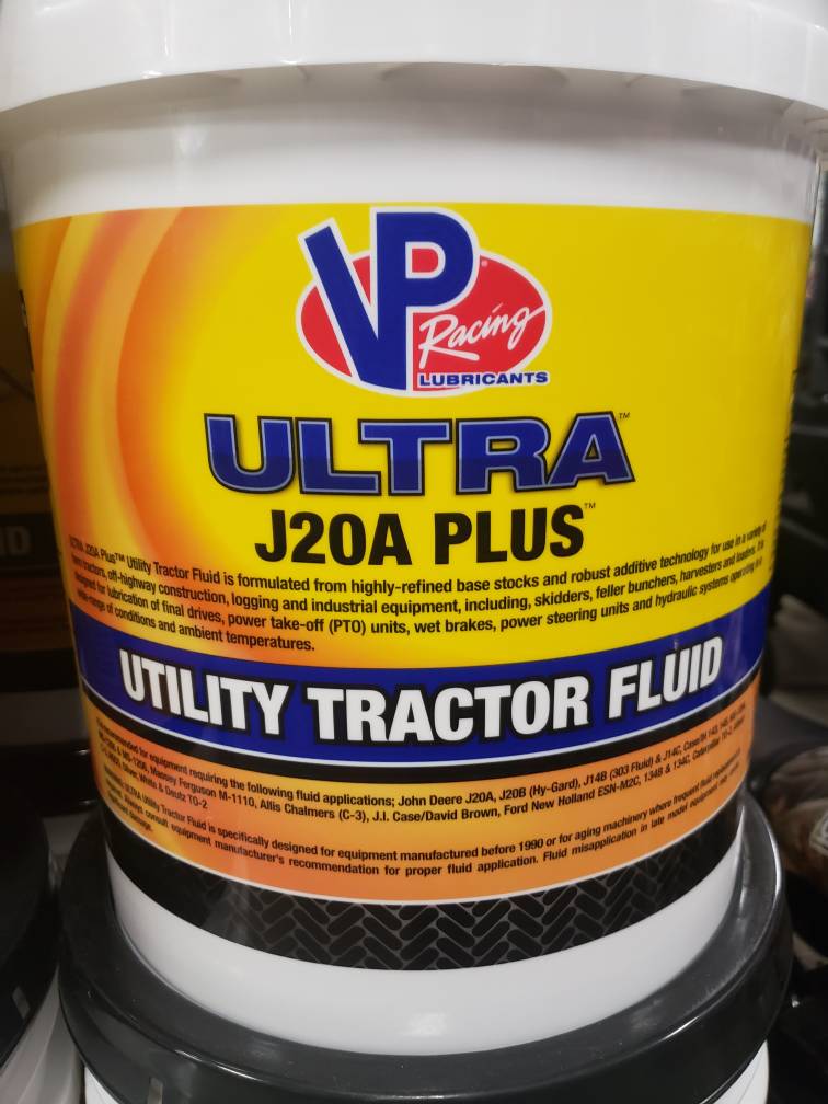

And then there is this at the "tractor" store: 20191214_100603.jpg

What are people using for oil? I couldn't get a straight answer out of the dealer I just did my break in oil change for the engine and I'd like to replace the hydraulic and hydrostatic oil filters but I know I'll have to top it off but don't know what exactly to get. The excavators I run at work have AW32 oil full synthetic I believe. The dealer had told me to ask the guys at Piston Ring since that's where they bought it from but Piston Ring wasn't sure what the dealer had put in my tractor. I'll give them all heck on Monday (naturally) but I have some decent weather finally so I can do all my servicing before it gets cold again as I can't get in the garage door with how tall the cab is. lol
Good day from a fellow Canadian. With temps in my area hitting minus 35 Celsius or lower I went with a Co-op tractor hydraulic fluid Super T-HF synthetic blend that has a pour point of -60 Celsius and meets all the specs listed. The price is reasonable and now with 200 hours on it, no complaints. The biggest issue in the winter is getting up to temp when it is cold, and on initial startup this fluid seems to flow ok. Have not tried any of the others listed.
   / Hydraulic/ Hydrostat oil? #16
I use Mobile 424 it has a pour point of -42
I was using TSC's traveller premium. I was getting whine with the hst in the winter. Switched to the Mobil and it's gone. A local fleet farm sotre carries it in 5 gallon pails.
   / Hydraulic/ Hydrostat oil? #17
I have switch over a couple of machines to Shaeffer Oil's 315 Simplex Supreme & have been very happy with both the cold & warm weather performance (much better performance in cold weather) .... probably not the cheapest (not more than any other good fluid) but I don't have that many pieces of equipment that I need to change the fluids on so to me it has been worth it... Have switched to their grease also & find I'm using a lot less with almost zero wash / bleed out... going to be moving over to their engine oils for everything as soon as I use up the Amsoil I have in stock.... Just something to look at....

I just went to NAPA and ordered a 5 gal bucket of Coastal full synthetic THF and it works just fine in cold weather. I bought a gallon of Kubota full synthetic to top it off if needed.

I'm very happy using AMSOIL Tractor/Hydraulic oil in my Kioti. I have nearly 300 hours on this oil so far and it works well in the cold with almost summer-like characteristics right from a cold start. I can blow snow in -25C, within only a couple minutes after a cold start, and the hydraulics think that it's summer weather. Covers the JD, Kubota specs and many others. Dutchy
