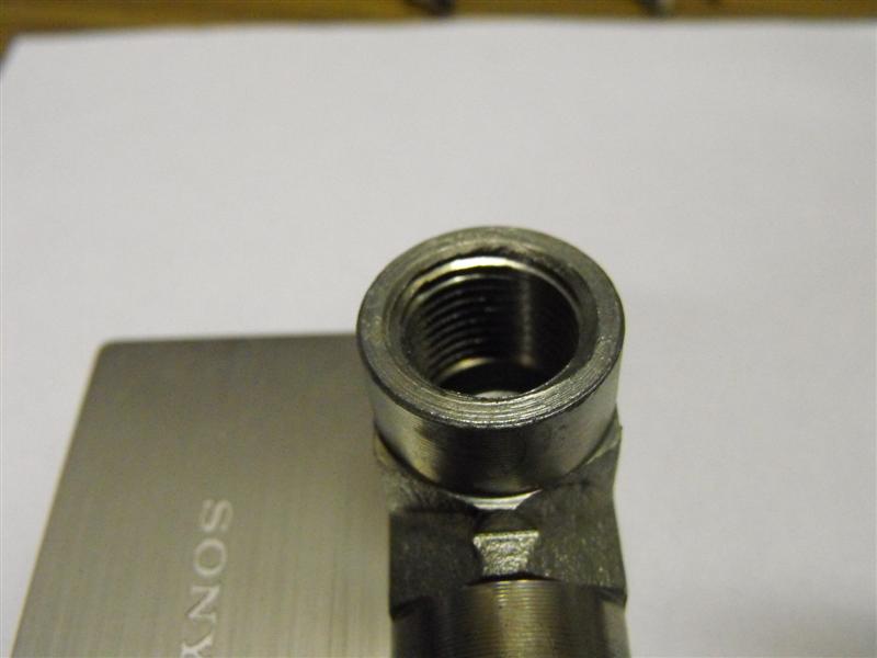

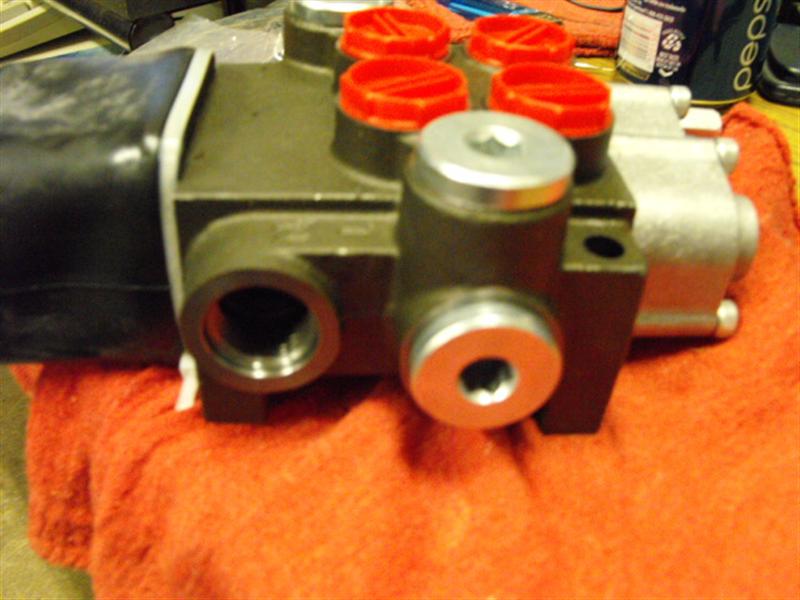

I don't know if this will help or not.
When you took the elbow off the ram, did the threads go all the way to the top of the hole (first picture) or did it have a short recess down into the hole before the threads started like the hole on the left side of the valve photo (second photo)? It may be an ORB fitting on the cylinder and need an o-ring.
Sorry for the fuzzy picture of the valve but it's the only one I could find right now.

Not 100% sure but I think the threads came all the way up. Its soposed to rain here till Wednesday so when things dry up Ill take another loook at it..
Thanks
