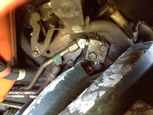

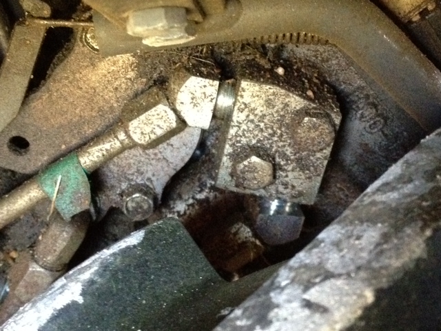

Good Morning everyone, even though I am a new member to this site, I have been reading it since I purchased my first tractor, a 2000 Kubota Bx 2200 currently with only 348 hours! What a machine.
I was wondering if someone could help me. I noticed last night while cutting the lawn, when the tractor is running and I come to a stop, I am leaking fluid. If you were sitting on the machine, it would be on your left side. After checking around, I noticed that I appear to be leaking fluid from under the machine,behind the rear tire (left side if sitting on it), where two steel lines go into this valve(?)
I have attached two photos of it. I was wondering what is this and does it look like the steel lines had backed out and this might be the reason for the leak?
It only leaks when tractor is running.
Thanks for any/all help in advance!!
Jeff

That block with the line coming out of the left side, is the pressure line for your loader controls or rear remote hydraulics, whichever you have.

Hi, I had a line at the rear of my BX2360 leak....by the looks of the picture, I don't think it's the same one, but I can't be sure. Mine leaked where the steel line was joined to the hydraulic housing. It might not be the same line, but it's the same type of fitting. The steel line cracks with vibration. Mine was replaced 2 or 3 times before the dealer took off the steel line and put on a proper hydraulic hose and fittings.
I don't know much about hydraulics, but my brother-in-law does....he was surprised they used this type of fitting on these lines....not great news, but the fix isn't that big of a deal.

Thanks Brian. Do you know if the lines should be flush with the block? I was wondering if the somehow became loose and pulled back, but the line isn't losoe when I grabbed it.

I own the same bx. My steel line for the loader had a leak and I had to replace the line. I had to remove that block because the threads on a fitting were bad. That block bolts to the hydraulic port with the two bolts you see. The block has O ring on the back of it that seals the two surfaces together, you could try and tighten them along with the two fittings. I would clean that area to see exactly where the leak is, one of the fittings or from behind the block. There is a lot of pressure in the hydro lines, in the area 2000 psi or so a slightly loose fitting will leak as will an O ring that's gone bad well.

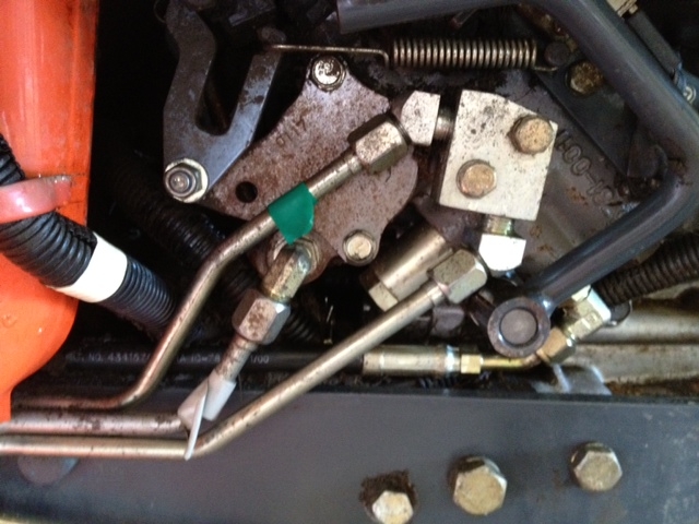

Okay, so yesterday I removed the rear tire and cleaned the block to determine where the leak was coming from, and found it to be at the threaded connection for the lower line on the block.
After removing the line and using teflon tape and connecting everythink back together, it is still leaking, and appears to be at the fitting itself where it connects into the block. The two bolts holding the block to the hydraulic controller were tight.
Maybe I used not enough or too much teflon. Will try later this week to remove it again, and re-do. Does anyone know if I can removed the block without causing any further problems?

Mine leaked right after the dealer delivered it. They sent a mechanic out. He swapped out an o-ring in the small block. When they setup the FEL they had to attach the block and felt it was nicked in the process. Also recommended teflon paste as opposed to the tape. I removed my fittings and replaced with the paste. Other leaks also stopped. Live and learn. Minor issue in the big picture.
