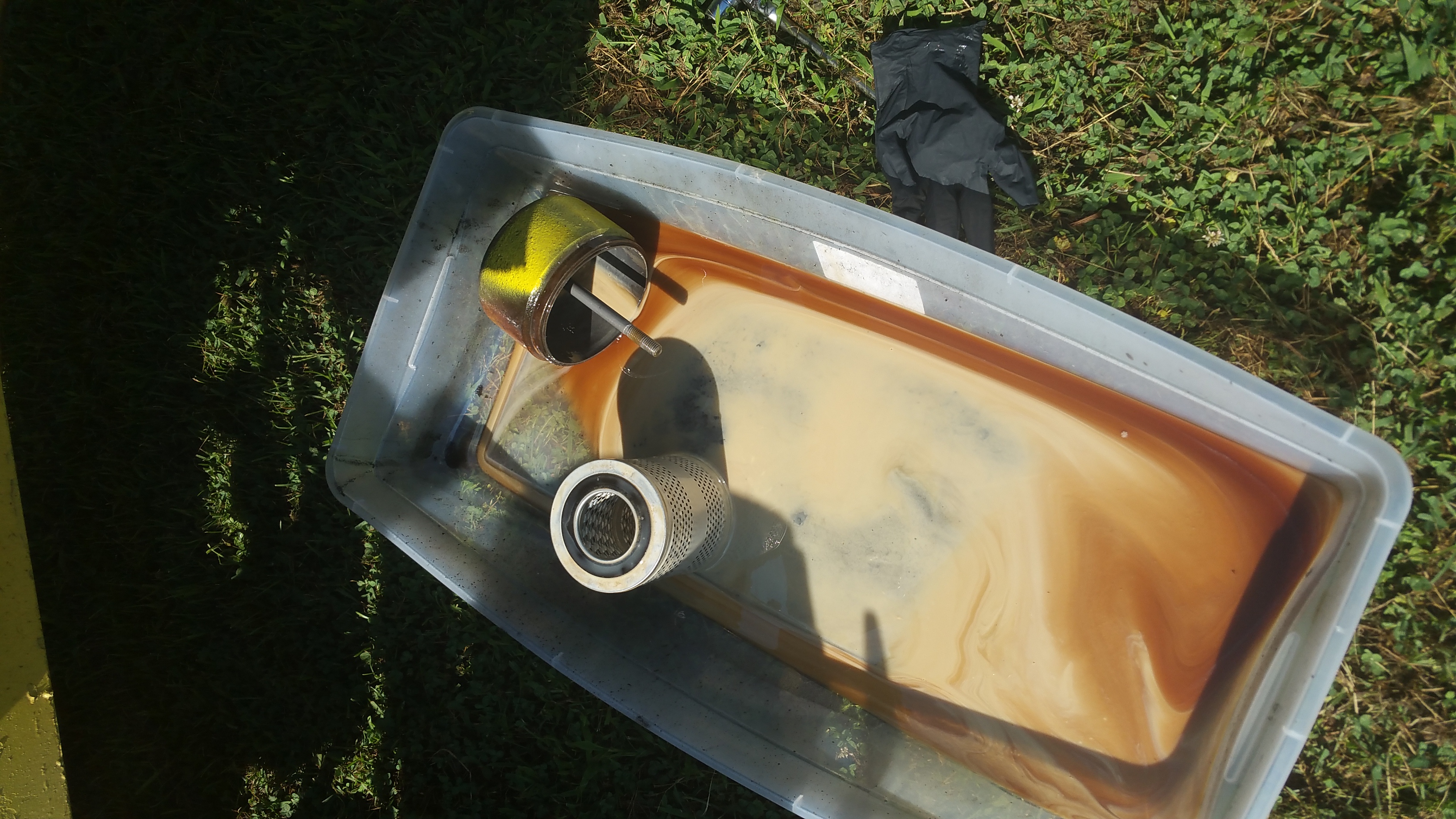

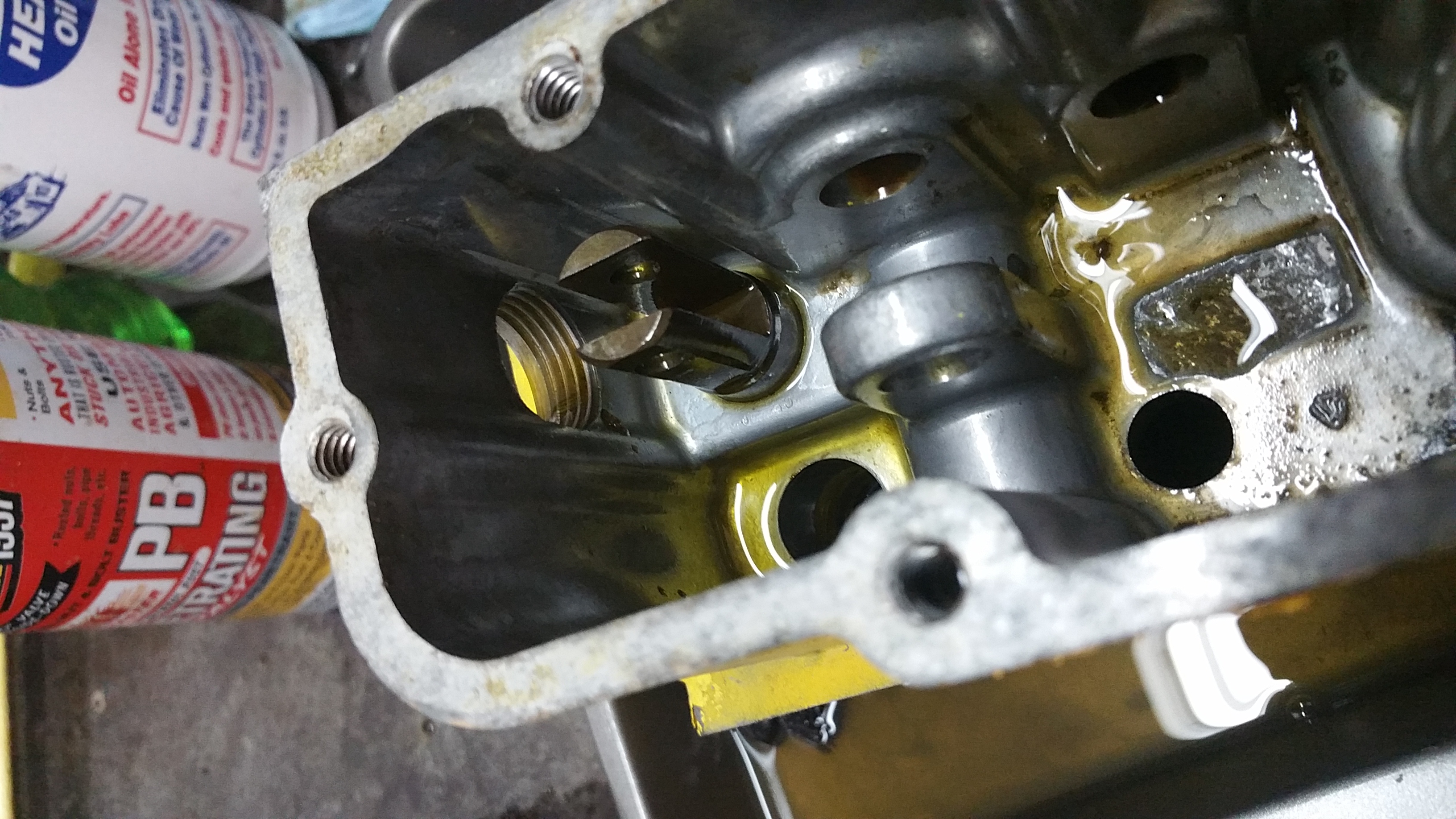

20170719_103400.jpgThank you TX Jim, I just got the tractor home Monday, but I have had to work until today. I drove the tractor about 1/4 mile and let it idle for some time. I pulled the transmission filter housing and found the fluid looks like gravy. I also pulled the plug out of the relief valve (which I don't believe has ever been out) and tried to pull the valve with my fingertip but I haven't had any luck. The tractor is away from my garage so I am walking back and forth for tools. 20170719_094144.jpg20170719_103925.jpg

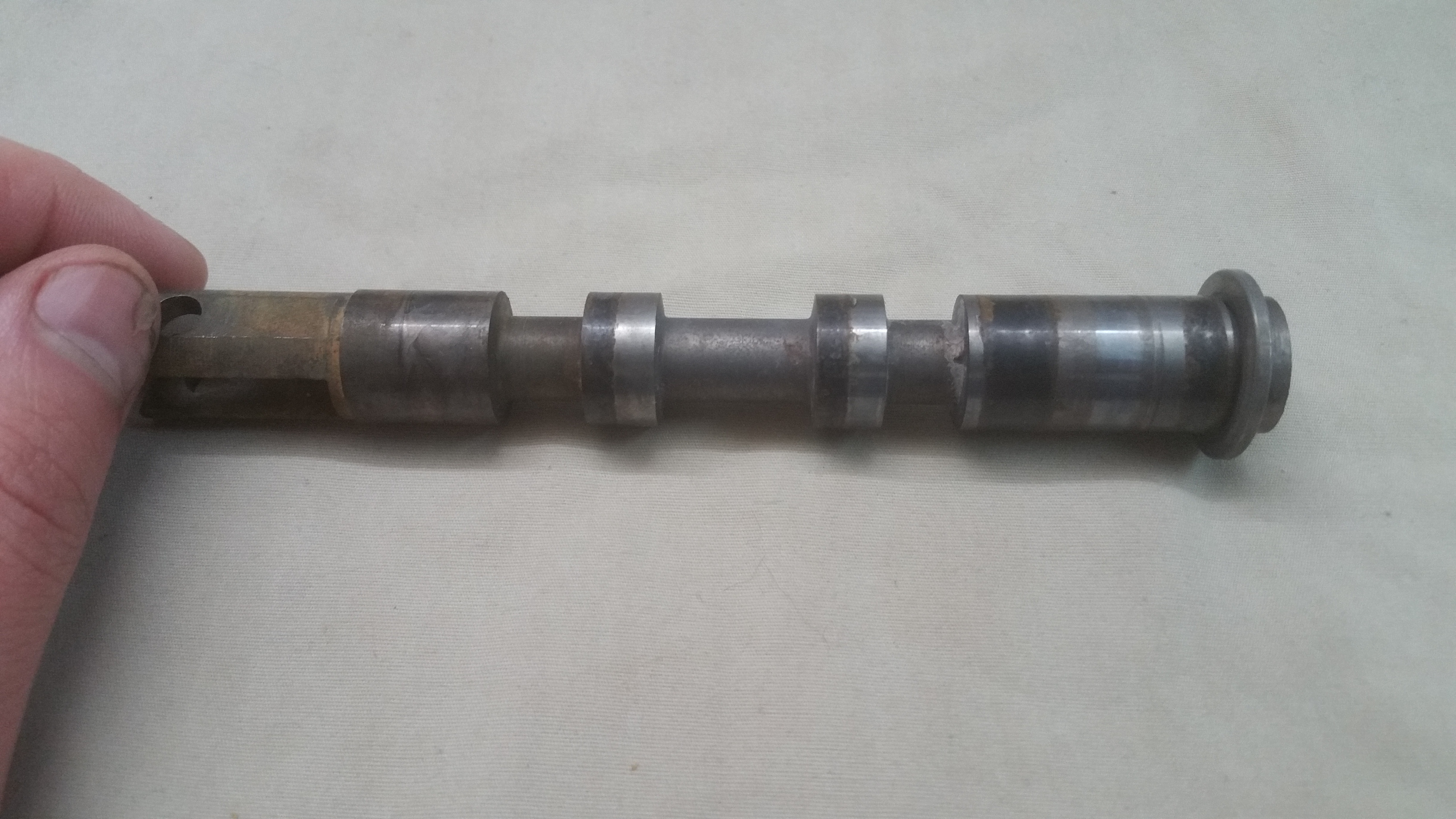

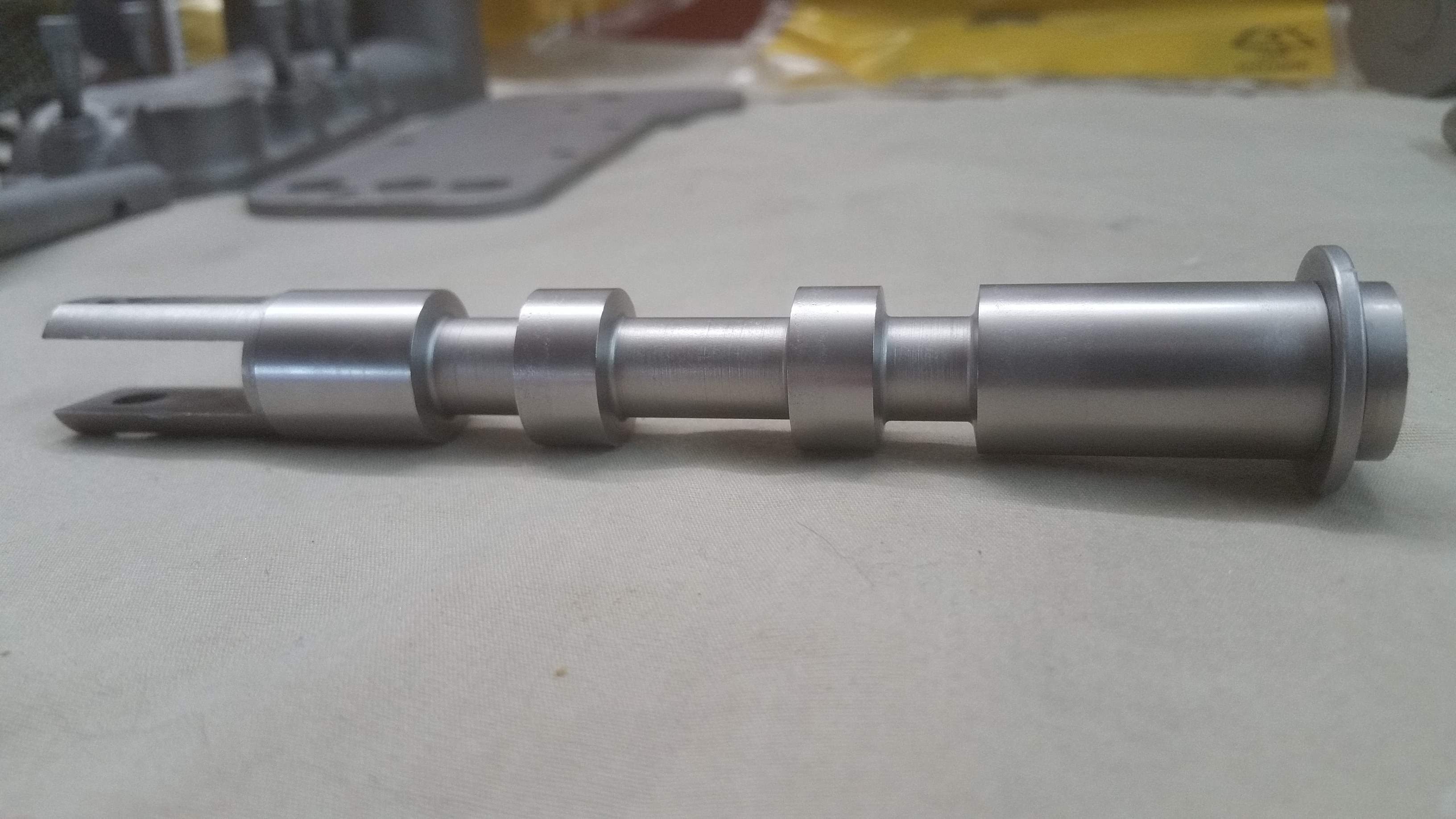

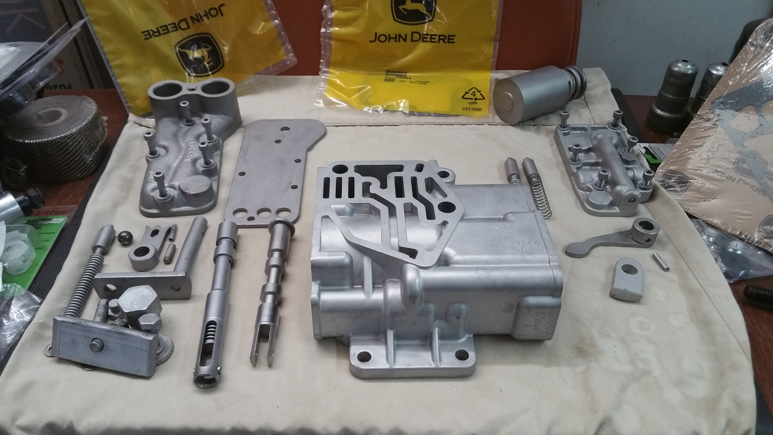

I have replaced the sump screen, changed the fluid, as well as a lot of hoses. I checked the pressure on the reverser and it was at 160 psi. I have been using the tractor for some time with no reverse or breaks. I finally got it in the garage. I pulled the top cove and checked the linkage to the reverser, all was good. The lever would not move. I pulled the master cylinder and reverser and found the control vale was stuck in the reverser body.
I let the assembly soak in pb blaster for a day and applied heat from a heat gun and freed the valve. I cleaned and polished the valve, but I can see a little pitting. I checked the diameter of the valve with mic and the is no variation. Should I replace the valve with a new one, or reuse the old one? ATTACH=CONFIG]543901[/ATTACH] 20180311_115347.jpg 20180311_124606.jpg 20180311_141353.jpg
