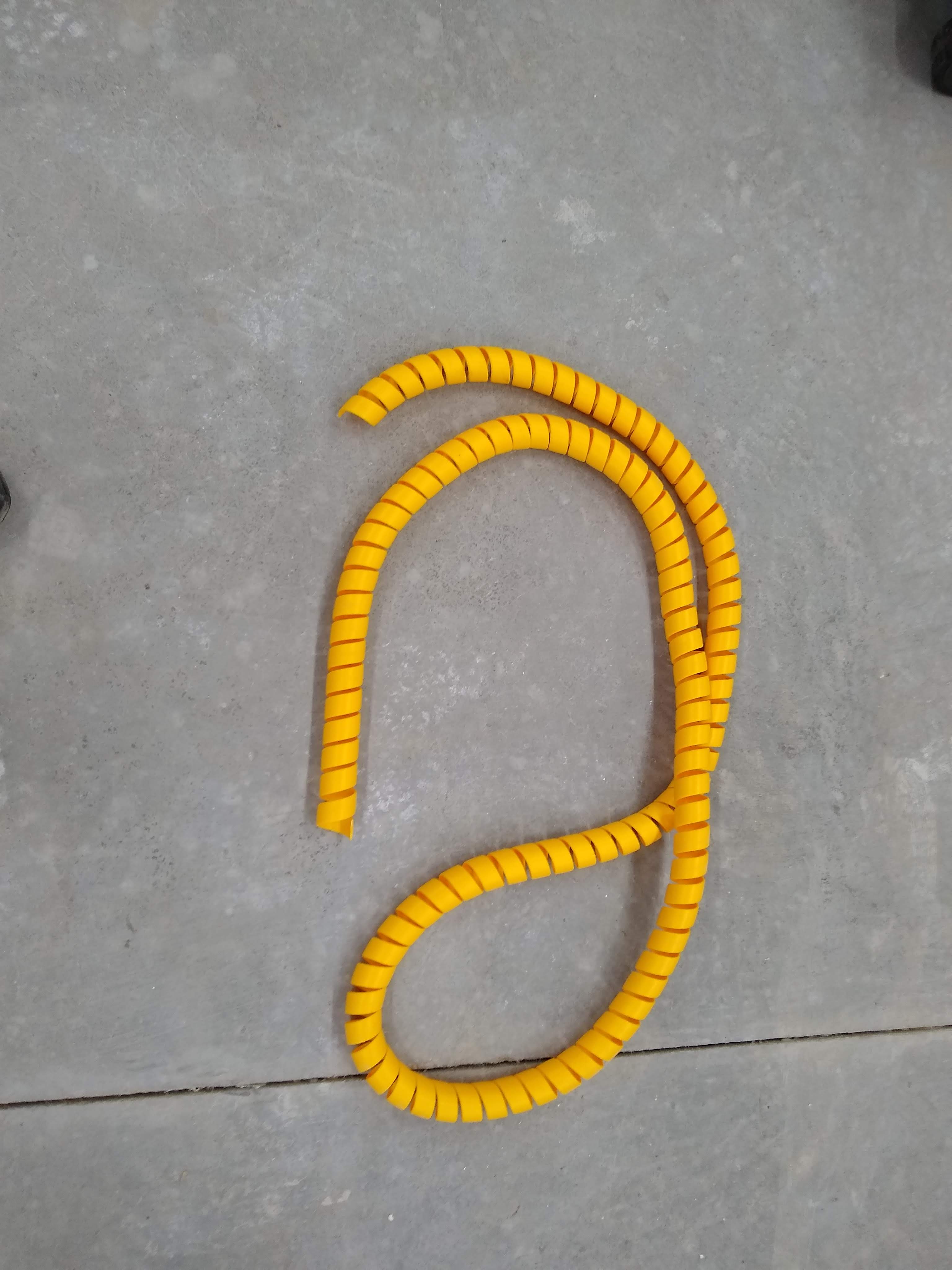

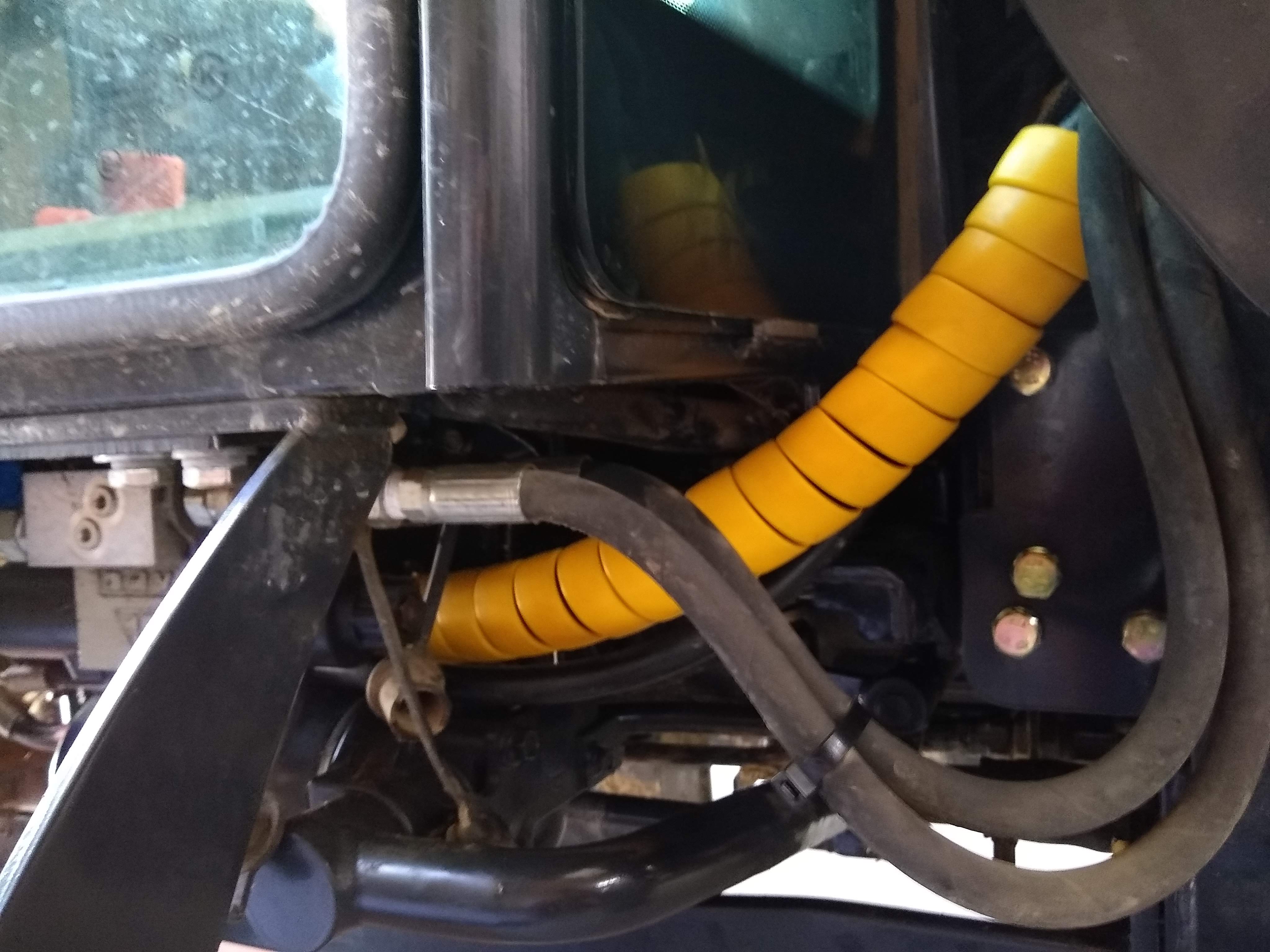

Update - Ordered the parts locally, was actually cheaper and same time frame. Got the hose and a new bulkhead fitting as the original was belled from over tightening. I ordered plastic spiral hose wrap (12' - $32 on amazon) to go around the 3 hoses that were close to frame. 1 1/2" ID was good size, not too lose or tight for 3 hoses. Will be ordering a length of 3/4 for use on single lines. Noticed that the quick coupler for the other side of the bulkhead fitting was allowing a loader hose to rub against the hood and wear the paint. Will address that too.
Attached a pics of the hose, the repair and the extra spiral wrap.
   / Hydraulic leak under pedals NX 5010 HST #17
Good stuff spiral wrap. Buys itself after the first blown hose you don't have.
I'm a big fan of nylon protective hose sleeves too, usually around $1 to $ 1.5 per foot. Provides a bit of chafe protection, but it also keeps the elements from breaking down and cracking the hose outer rubber layer, which would then allow the first braided layer to corrode, eventually destroying your hoses. Takes many years before you reap the benefits of this. But def worth it. have done all hoses on my dk54se and loader.
