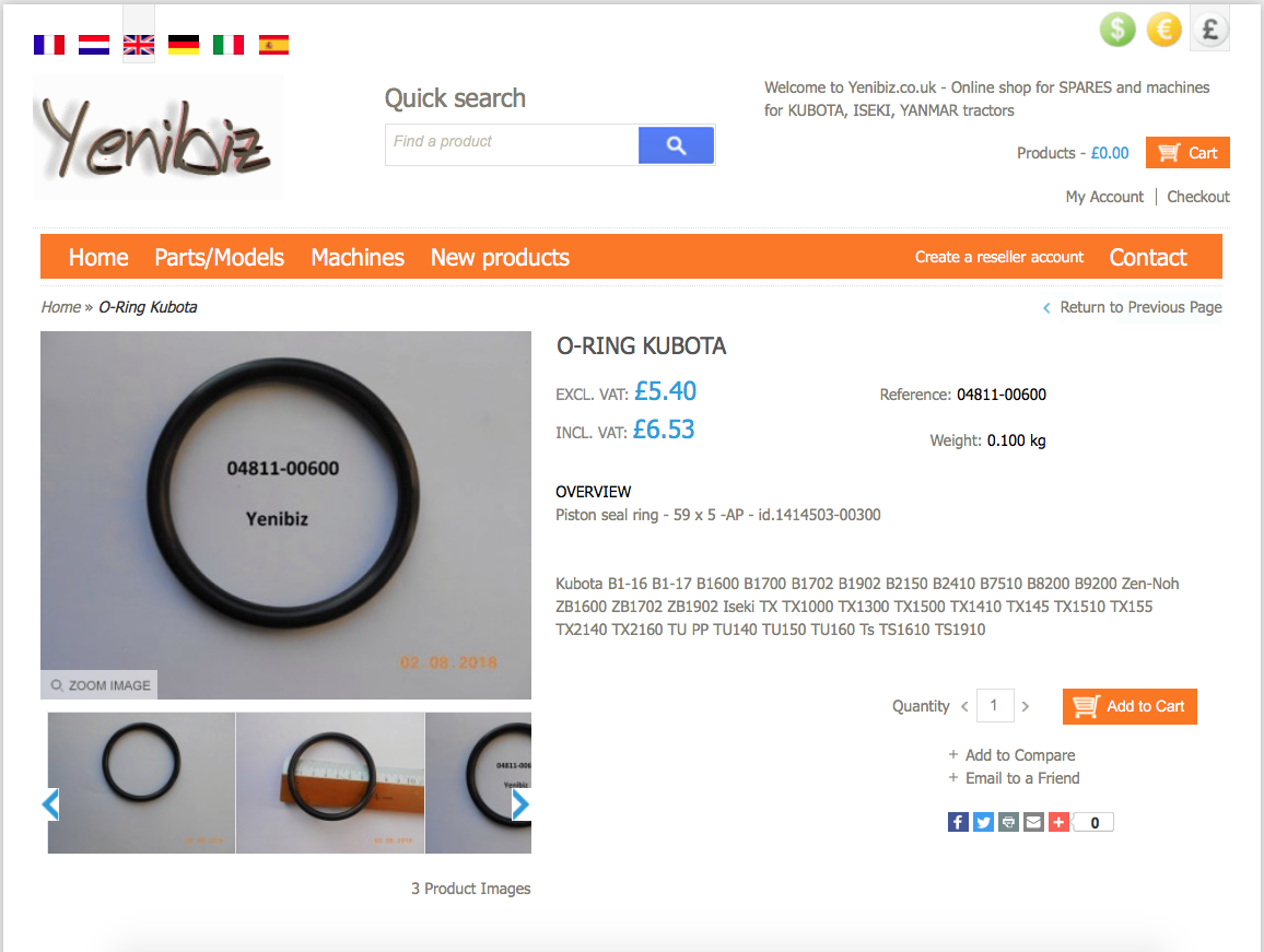

can anybody on here got or can point me in the right direction for a set of the 3 point hydraulic lift ram rings to fit a TX1500f just done a couple of hours on the internet and found jack every other tractor but a iseki tx

The Bolens G172 is the same machine. Have you tried finding the part from a Bolens supplier? I also wonder if you just cant find the OEM part, can you take the piston seal, take good measurements and find a match through a hydraulic parts supplier?

Hi Darryl thanks i didn't think of that Bolens G172, do you know if its just that model number or through the G172 - G range
i can't measure it as its still in working its just that it needs changing because it slowly creeps down overnight so i thought i would get a set now and on the next five minutes i get i would have everything ready to change it

I cant say for sure if the G152/G154 ( Iseki TX1300) seal is the same as the G172/G174 seal but I would bet my last dollar that the G172 ( 2 wheel drive) and G174 (FWD) use the same seal. Here is a link to another forum discussing a G174 3 point lift issue. The OP says the G174 ( iseki TX1500) and the Iseki TX2160 share a lot of crossover parts. https://www.tractorforum.com/threads/bolens-g174-hydraulic-lift-problem.24600/ A little more searching indicates the White Field Boss 16 appears to share a lot of parts with those Iseki and Bolens models. White Field Boss 16 parts diagrams and part numbers are available to view at https://apb.agcocorp.com/ -- enter site as "Guest User". (You may or may not be able to view this site since you are in the UK)
Here are part numbers for the 3 seals on the FB16's 3 point piston.
33-0129011 1 RING - BACK-UP
33-0128872 1 O-RING
33-0042331 1 O-RING
Who knows if any of this will match your TX, I'm just try to give you some options.

are thank you so mine is a G174 and with that information i found this and it indicates to me that a whole range of tractors have the same piston seal but no leather backing washer tho

the site will only let me find a dealer in the uk for massey ferguson tractors must be a big company tho got a few dealers over here

Hi Second (sorry don't know your name), i was in contact with this Yenibiz company.
I can order those rings (i need two sets myself actually), and shipping to Holland will take total of 5.45 euro.
The price for rings are
- o-ring: 6 euro
- backup ring: 11.23 euro
So i can order this, we will split the shipment charges.
What do you think?
thx
M.

Hi marcel that would be great yes I have 2 sets as well all ways good to have a spare set
Best regards terry
   / hydraulic lift cylinder rings #9
Ok no problem.
Just one remark: i hope you are not in a hurry. I am travelling, cannot order before friday. Then the stuff has to be sent
- from Belgium to Holland
- from Holland to Poland
- from Poland to UK
I guess/think the whole thing will take 2 weeks. Is that a problem?

No worries there I been looking for a while now so a few more weeks isn稚 going to corse any problems I am just pleased I will be getting it fixed many thanks to you sir
Best regards terry
