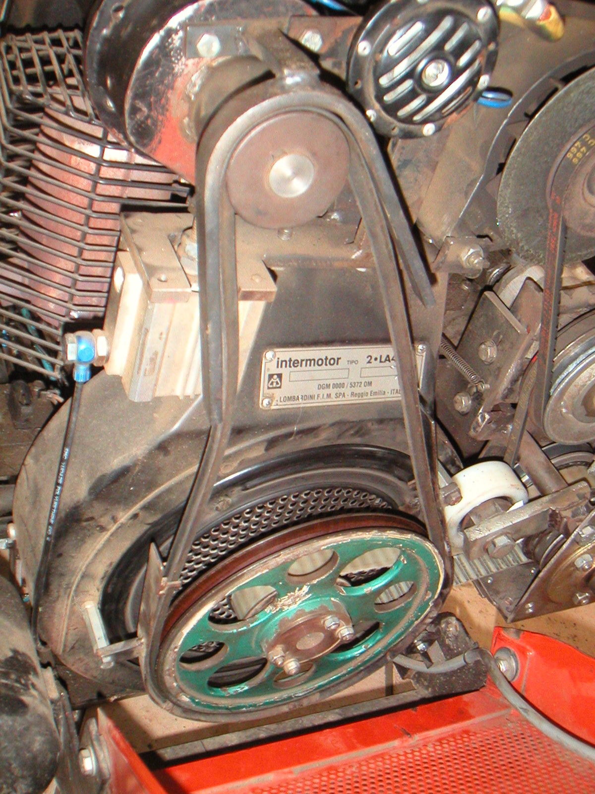

Very nice! Did you make the pulley to go on the engine crankshaft or were you able to find one? And, by the way, do you have any german online shops you would recommend for hydraulic pumps and pulleys and stuff? With other things, i have found that ordering from germany can be cheaper than Slovakia.
Hi,
i have built an new shaft, matching to the motor crankshaft. On this shaft i have mounted the pulley. This system was for an 2- Cylinder Diesel engine.
For a lombardini 1- cylinder petrol engine, i have mounted the pulley drive directly on the crank shaft. Fixed with 4 screws.
