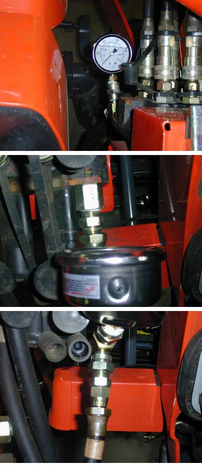

I too was surprised to find the pressure off by that much, but I'm glad that I didn't need to set it over pressure (just to the correct pressure) to get my chipper to lift.
The loader relief valve is on the loader valve. If you remove the cover over the control lever, there is a stacked-nut thing (sorry, I don't know how to describe it better) to the left of the actual valve control plungers. The top nut is actually a cover over a screw, and the second nut in the stack is a lock nut for the screw. Remove the cover, losen the lock nut, and you can turn the screw to set the relief pressure.
I'll mention again that you really shouldn't screw (no pun intended) with this unless you know what you are doing. Over running the pressure can be damaging to your tractor and dangerous to you. Hosed and other parts could crack and fly apart, and an over powered loader will do what you want, which is also what you shouldn't do - lift more weight than intended.
OK, now I can continue with a clear conscience.
Regarding the pressure gauge, I bought one from Northerntool, but it's glycerin filled (for damping of movement) but it's not fully filled so there's a big bubble at the top of the display. It's very annoying, but not worth the return shipping the get it fixed, so I'll just stay mad at Northern. I picked the IN line on the loader valve. It brings fluid directly from the pump and there are no relief valves upstream from it. It took a Tee and a collection of other fittings and several trips to the local hydraulic and tractor show to get everything. I took pictures and will post them one of these days, but they are still on the camera and need to be shrunk to a TBN-friendly resolution for posting, and I'm too tired right now.

</font><font color="blue" class="small">( Regarding the pressure gauge, I bought one from Northerntool, but it's glycerin filled (for damping of movement) but it's not fully filled so there's a big bubble at the top of the display. It's very annoying, but not worth the return shipping the get it fixed, so I'll just stay mad at Northern.)</font>
There is nothing wrong with your gauge, the air bubble is for expansion. /forums/images/graemlins/smile.gif

Here are some photos of the pressure gauge. The first is the dial gauge, and you can see the big air bubble (are they all that big?). Next two show the adapters on either side.

Hi Peter - good job getting that 3 pt up to spec !
Btw, filled gages do NOT all have that big an air space. But unless it is on a system with rapidly fluctuating pressure (usually a piston-type pump) the damped movement isn't needed anyway.
Another point I'd offer is that many standard industrial hydraulic systems run at 3000 psi. So it wouldn't be a surprise to find that most of the hoses, fittings, cylinders, seals, etc will handle that ok. You are smart to keep your system in the region of 2000 - the links, arms, etc have more safety margin down there.
