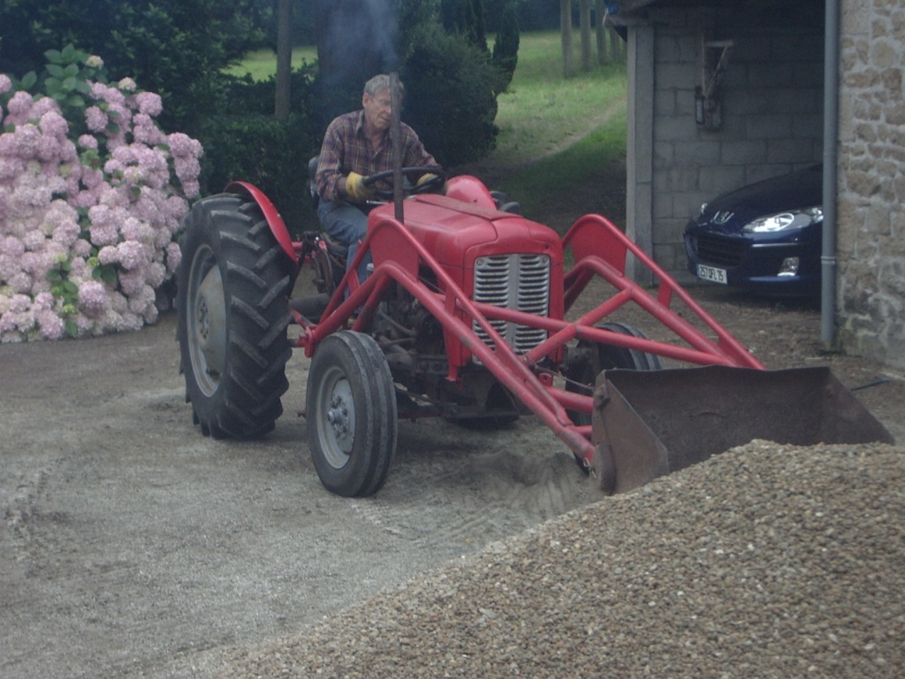

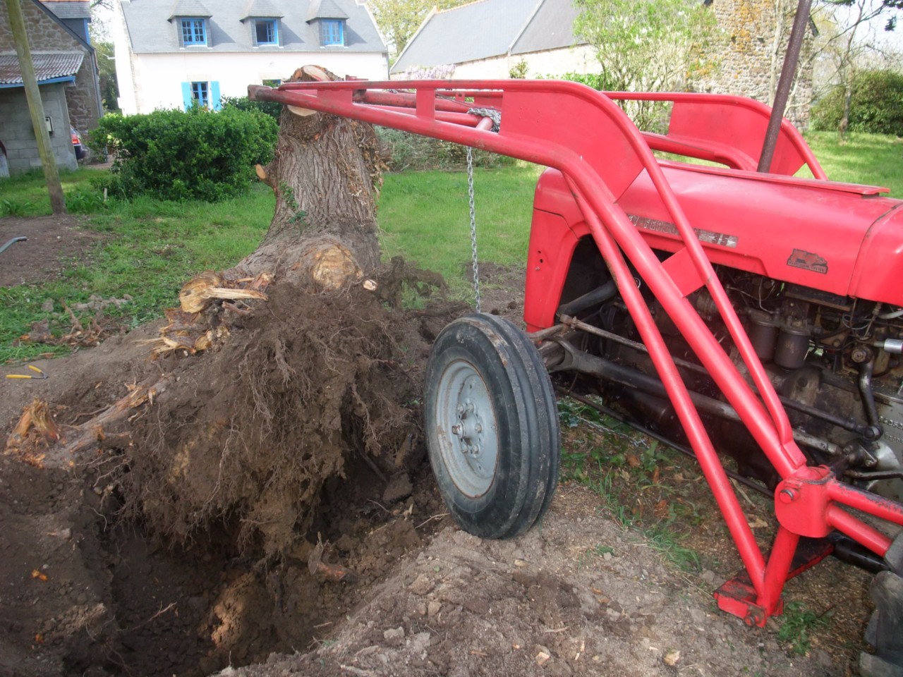

On my MF35 there was a valve under the seat directing the flow of oil to the loader, the 3 pt or a dump trailer. First thing is to check whether there is one on this model and if it is in the right position for 3pt operation (easily pushed or kicked into a wrong position).
