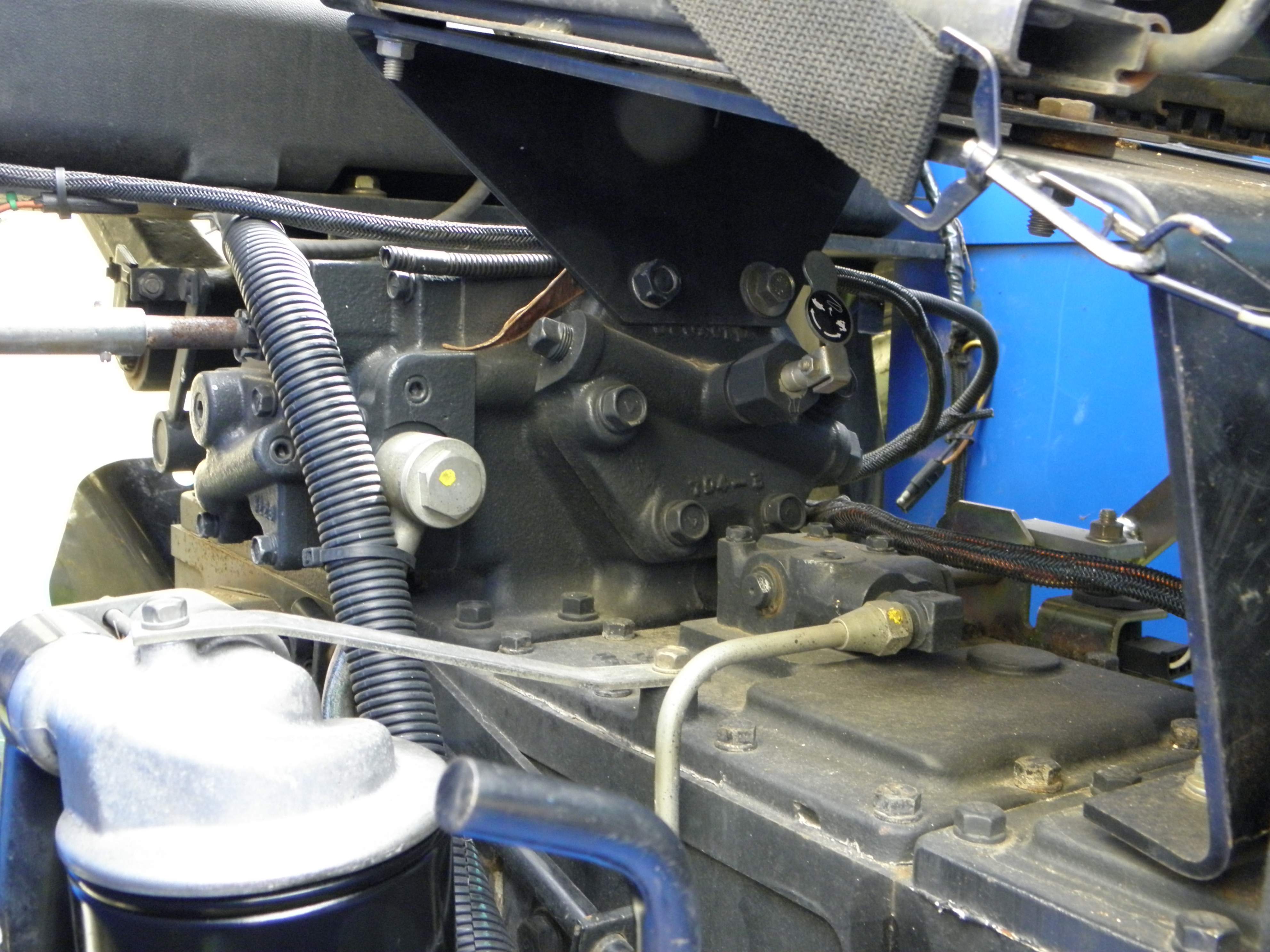

Now gentlemen, I am willing to go through all the work of removing that piston to get to the seal but is there anything else related like the seat of the check valve or the check valve itself in the cylinder head assembly, that I, as a novice, can check and change first? My father, God rest his soul, always said "Let's do the obvious before we do the ridiculous".

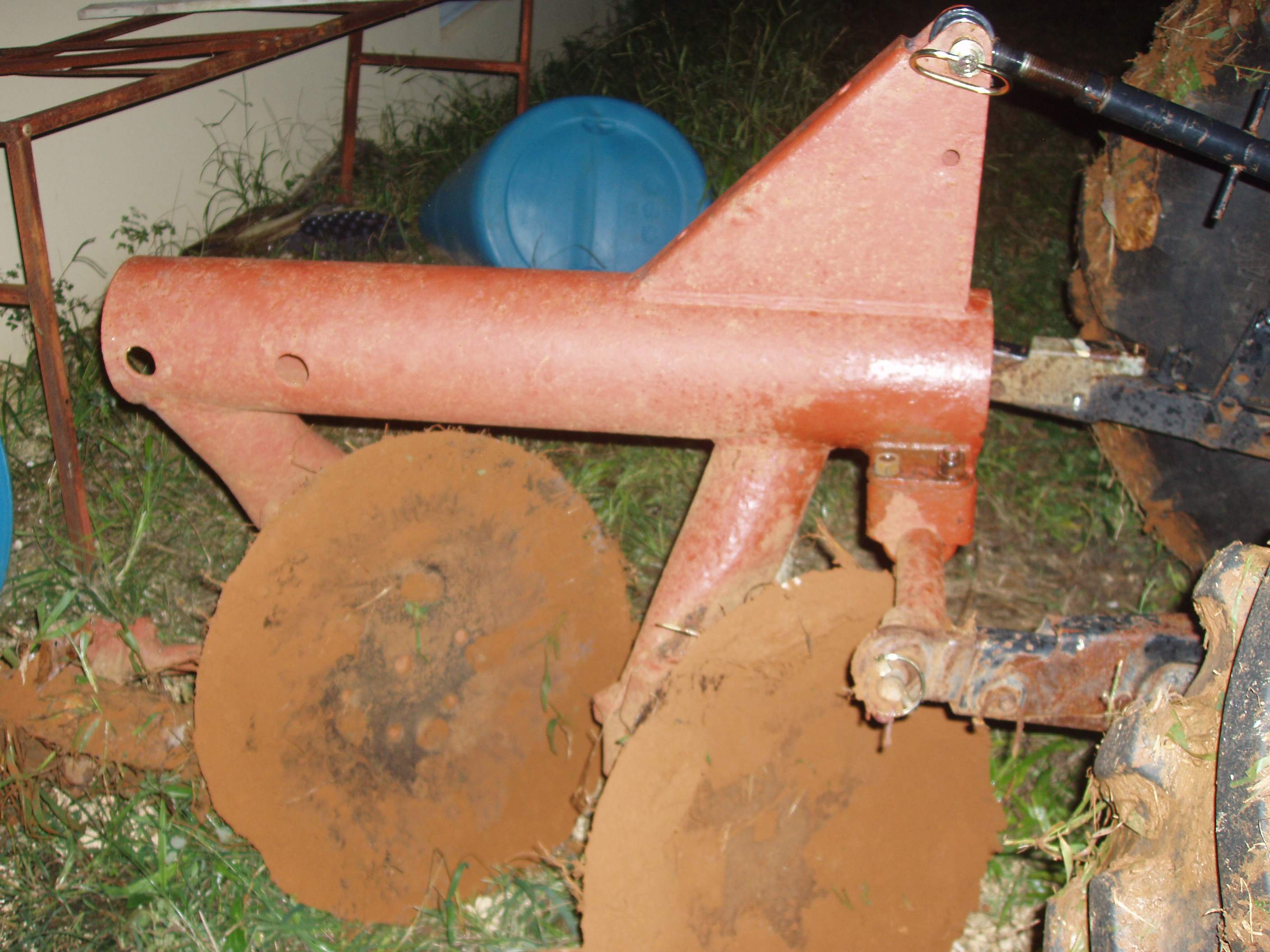

I have checked the 3PH with a moderate load, very old two disk plow, and there was no pulse nor did it drop while I was plowing in the field, getting to and from etc.
Jinman,

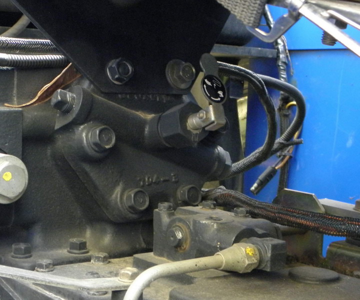

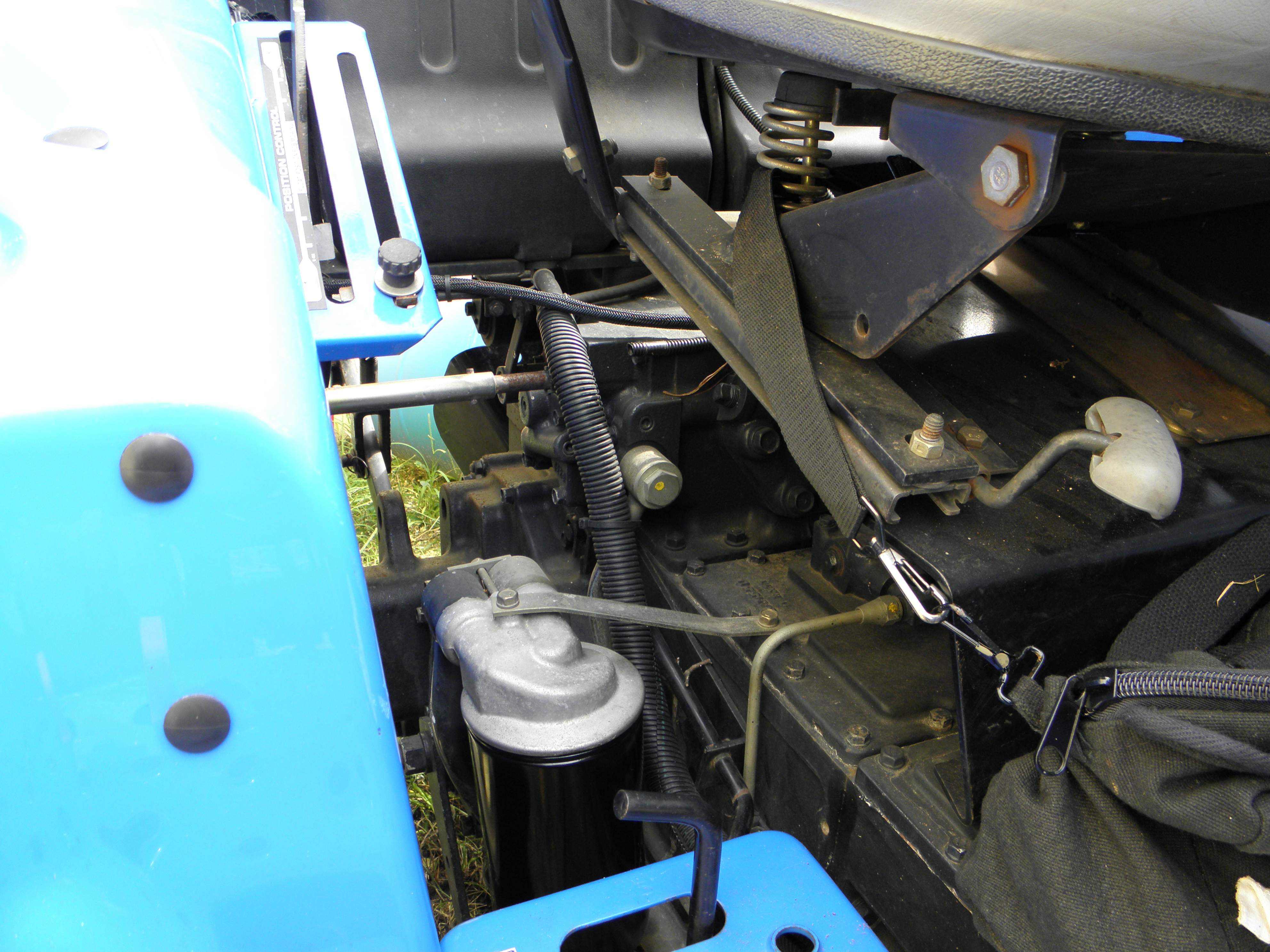

can you or anyone indicate, from the photos of the tractor, where the panel that can give me access to the piston should I have to do "the ridiculous". I am familiar with plowing and preparing a field for planting but not much of a mechanic. :eek:
I'm hoping it'll hold as is until I finish my current project, preparing two acres for planting, before it becomes a true issue.

it does not look too bad. It seems the top two bolts on the top of the cylinder head support the panel that the seat is mounted on. If you zoom out it might give more clue. from this angle it appears to me taking the seat of and the sheet metal that seat is attchedd to is all you need to expose the front of the head and removing the 6 bolts and you can remove the head. The actual cylinder is at least 12" long so you have to remove enough in front of the head to fully withdraw the cylinder.

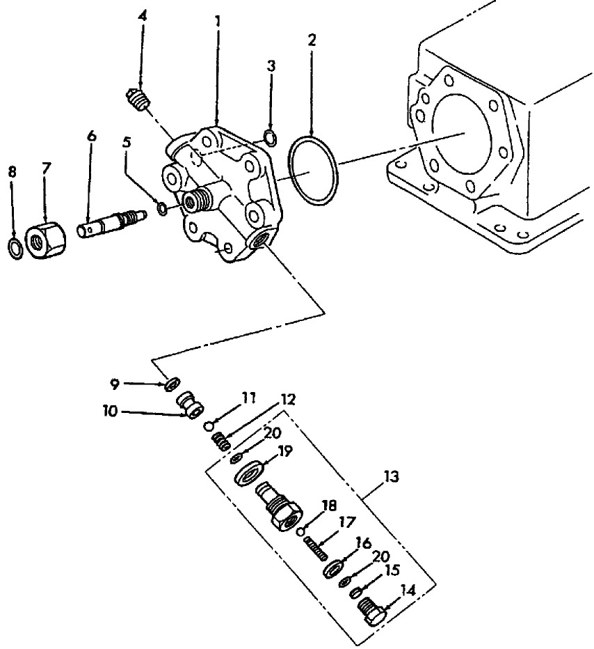

JC told you about the cover, but here is a zoom of the area in the attachment. The valve in the foreground is your PTO valve that operates the PTO clutch. Hopefully, it will not be in the way of removing the 3PH lift cyl. cover. I would not recommend that you disturb this valve or try to remove it. It has tubes running down inside the casing and is something you don't want to deal with in addition to the lift cylinder.
Also, go to this link at messicks.com and type in TC40A in the box. Click the "Search" button and you will have a list of all your tractor's systems on the left. Click "Hydraulic System" and you will have numbered sub-systems. Click on 07.01 and 07.02 for the detailed diagrams of the hydraulic system and parts lists with prices on the right.
