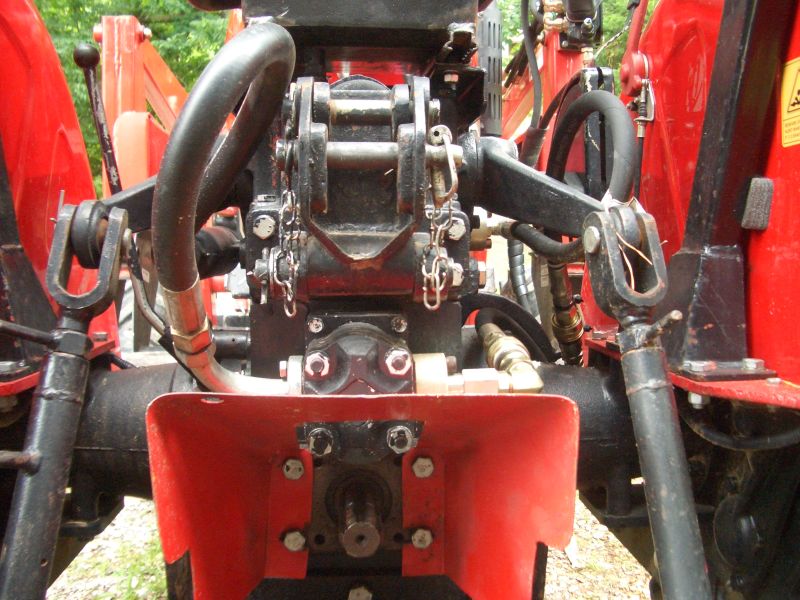

If there's a PTO pump, it's inside the sump, where I don't venture into.
So - you don't actually know where your hydraulic pumps are?
I've been formulating my responses around the assumption that you had the standard TaiShan configuration. Look at the attached photo. Look above the PTO output shaft. That thing behind and slightly above the red PTO safety shroud - the one with fittings and hoses on both sides - that's the hydraulic pump that runs my TPH and FEL. The first QD on the right is FEL supply, the QD forward and the the right of that one is the FEL return

I know that's a pump, but didn't know whether there's a second one.
   / hydraulic line connections #26
The second one will be up on the engine, but it's just for power steering
//greg//
