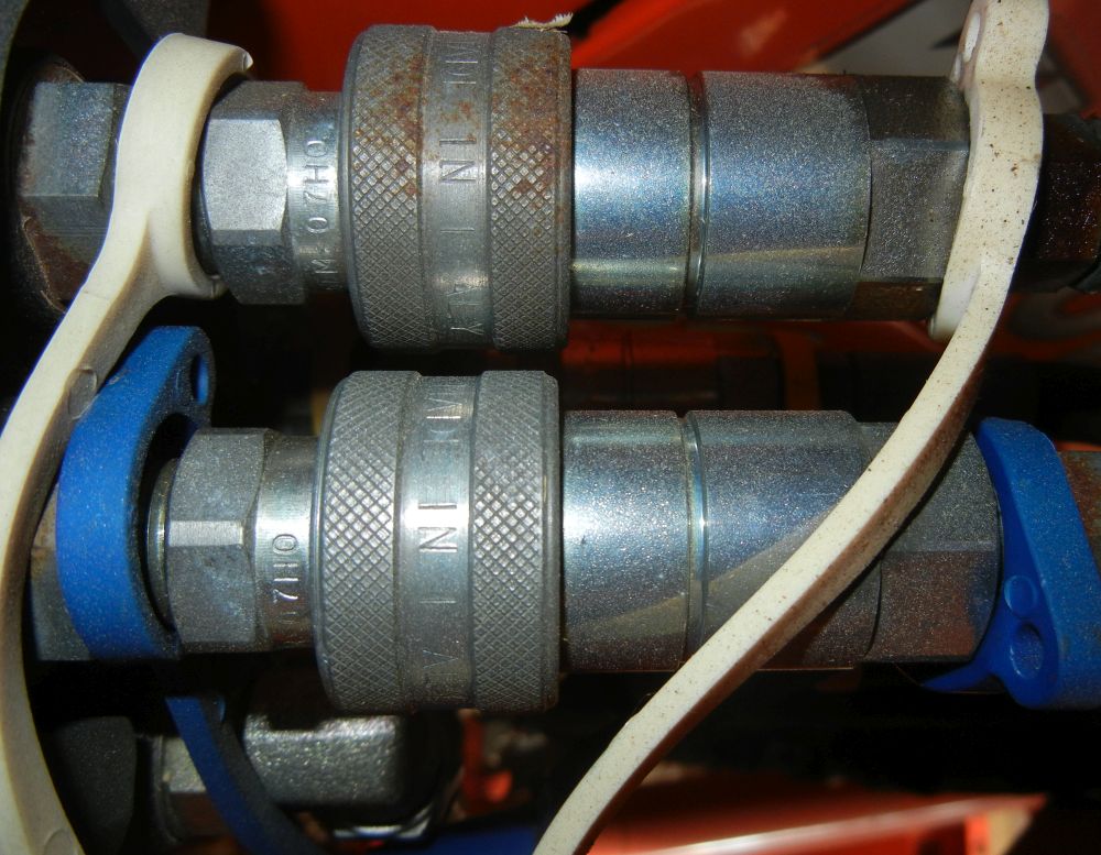

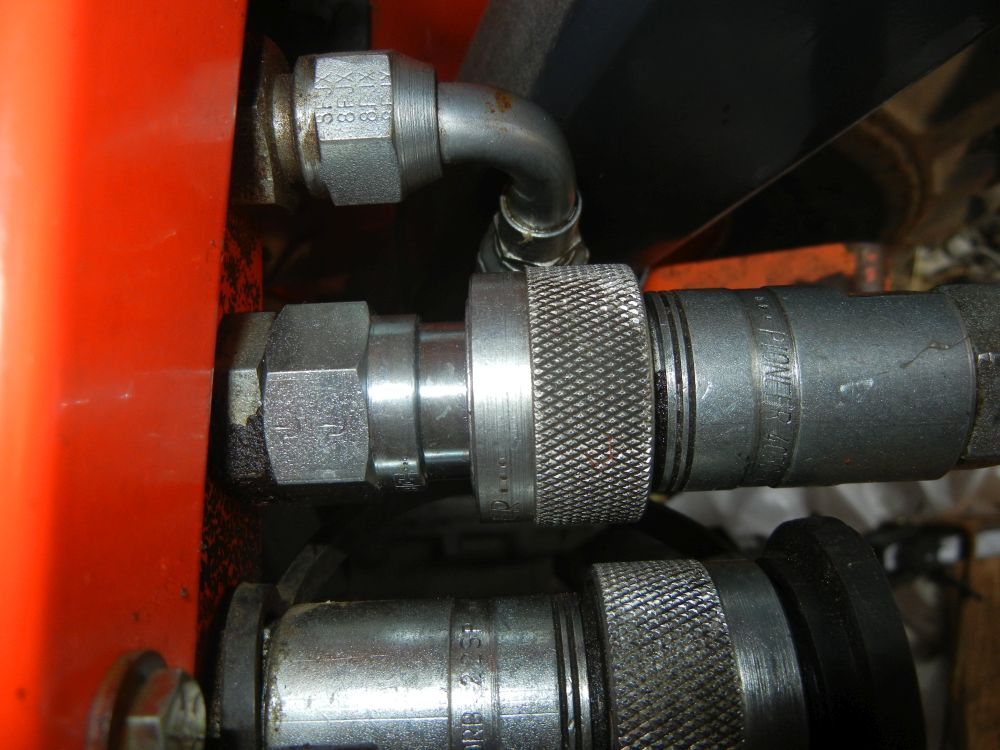

My feeling now is that I am not getting these hoses on all the way. They are on enough to not fly off and for fluid to pass but not to make a good seal. I notice a shiny area that is exposed when I have the couplers connected. I look at my loader couplers and there is no such space. I also looked at some at the dealer on backhoes and no such space.. Granted the loader and the dealer backhoes are different brand couplers, kubota ones.. Mine say made in italy.. so maybe they connect differently but it seems mine should go on more but I have moved the bucket control every which way til nothing moves and I have lowered my 2 pt hitch all the way to the ground and I still can not push this on any further. I have tried with/without the collar retracted.. See photos. fittingopen.jpgloaderfitting.jpg

I had couplers on an older Allied Loader, a 660, which required me to twist the knurled coupler collar in order to draw the coupler together. the coupler would never close with just pushing. The male end had a spiral grove which meshed with balls in the female knurled part. As you turned the knurled collar it screwed the male end into complete closure and lock
Try this and see what happens
Dave M7040
   / Hydraulic Line Help Please #17
Pioneer 4050s have the regular collar that pulls back to unlock. When the male part is fully seated the collar snaps back and there's a click.
1/2" couplers can have 3/4" threads.

Revisited this today with a clear mind.. The coupler is going on all the way. That exposed band in my pic is normal, based on the distance from the ball bearings to the end of the female 1/2 and the distance of the groove in the male... Fired it up again and let it idle about 5min, still got a drip at the bottom. Doesn't seem as bad as it was the other day but it's 50 deg out and it is all cold.. The other day when it was dripping fast, the fluid was hot as I was working it pretty hard.. I think I just need to replace these and be done with it. thanks all
