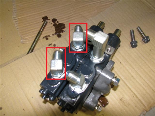

I'm installing a single spool remote valve on my MF 1532. I plan to run lines directly from the remote valve to a grapple to power the open/close function.
Below is a picture of the exact valve as a two spool. I've highlighted the connectors that come with the single spool. Jake's Engines lists these as "FITTING 3/8 PT X 3/8".
So, I'm assuming when I have my custom lines made I will need one of the ends to be a female 3/8" in order to screw onto these male 3/8" fittings that are in the valve, correct?
As for the other end of the hoses, when I view pics of the grapples, they have two lines, one has a quick disconnect and the other has what looks like the male end that would normally go into a quick disconnect (sorry no idea what that's called).
So, for the other end of my hydraulic lines, I will need one of them to have a quick disconnect (to mate with the male fitting of the grapple) and the other to have a male fitting (to mate with the quick disconnect on the grapple).
Does all this sound correct? With that said, does anyone know where to get a 90 deg 3/8" to 3/8" fitting shown in the pic for cheaper than what Massey wants for them ($30 a piece).
Thanks for all the help!
Edit: Is this the fitting I would need? Looks like I can go cheap with non-stainless. Not sure if the Massey units are stainless, but for the price I would assume so. Maybe better just to get theirs.

Nope, this
SAE 37ー Flare (JIC) x O-Ring Boss (ORB) 90ー Elbow
is what's on your valve -

So the bottom portion of the fitting that screws into the valve, since it's 3/8" according to Jake's site, is that #6 SAE?

Take the .pdf that James linked to (sorry, I forgot to do that) - you will find that each fitting type is listed not only by the "dash number" (6, 8, etc but also by ACTUAL size, threads, etc - it's actually more likely your valve could be a -8, with 90's that also reduce to -6.
I've worked with this stuff enough I could tell you by looking, but pics can be deceiving - you will probably need to MEASURE carefully and compare to the listed sizes in that fitting chart.

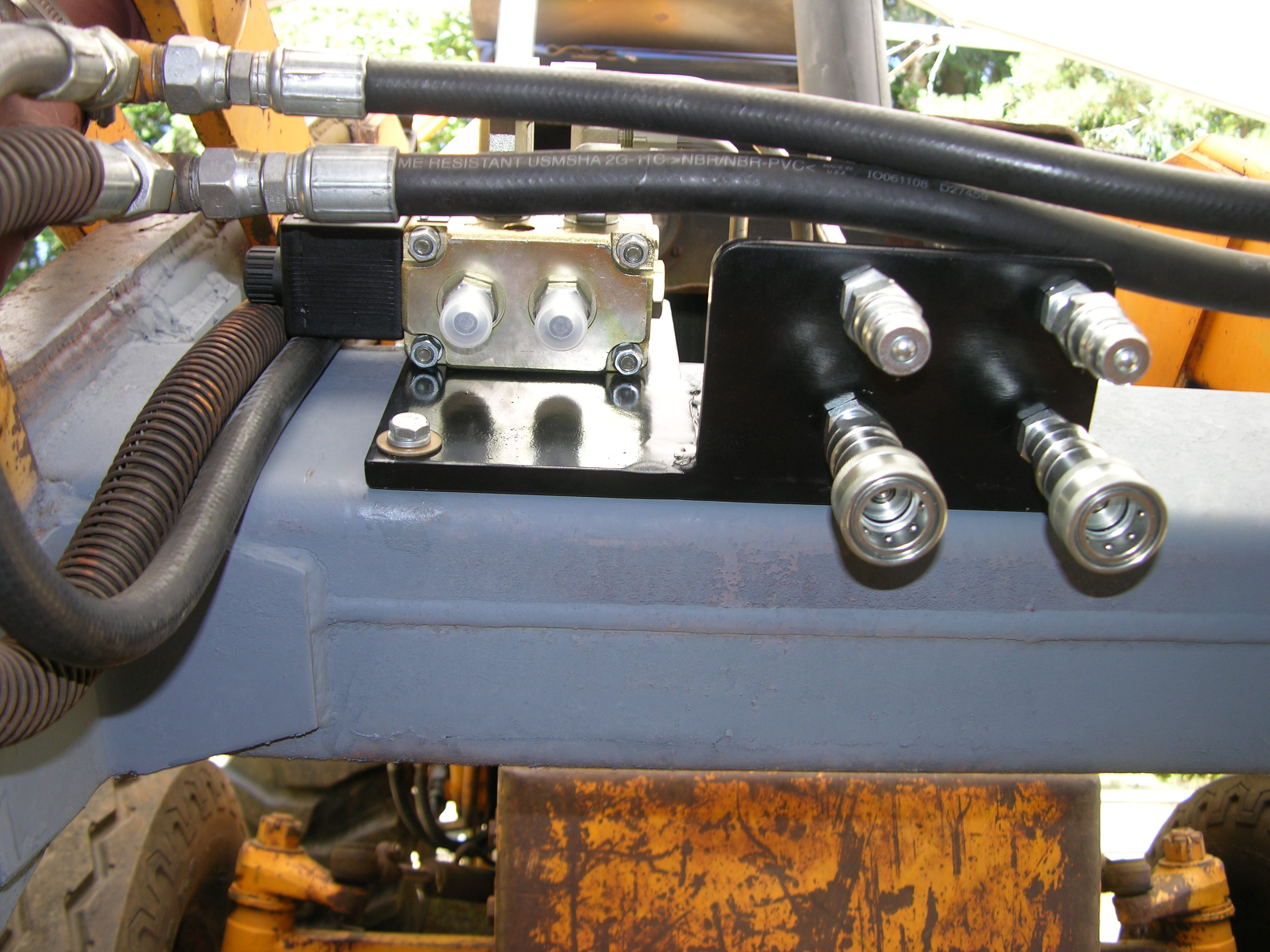

QD's (especially the AG version) are mainly NPTF threads - once you figure out where they need to go and which direction they need to point, IMO the best way to go (not the easiest) is to make a plate or angle iron, drill holes in it for BULKHEAD fittings - you can get them in JIC - NPTF male, the QD's are female, so you get a rigid mount for the QD's to attach to.
Here's the ones I'm talking about
Male Pipe (NPTF) x SAE 37° Flare (JIC) Bulkhead
And here's one way to mount them
That plate looks kinda beefy because it's going on a 12,500 pound backhoe; those two circuits will redirect the bucket curl to either grapple and/or articulation for a hydraulic sickle bar. The actual hydraulic motor will get its own separate flow controlled circuit, run with hard tubing down the loader arms.
BTW, that pic was just a test fit, the old hoses shown will be replaced and will feed into those solenoid selector valves - no switch = bucket curl, switch A = grapple and switch B = arm articulation (all controlled with bucket curl valve)
I'll be out of town til tomorrow nite, but James has done a fair amount of this also, and JJ probably knows more about hydraulics than the manufacturers in some cases :D
Hopefully this will help get you started... Steve
